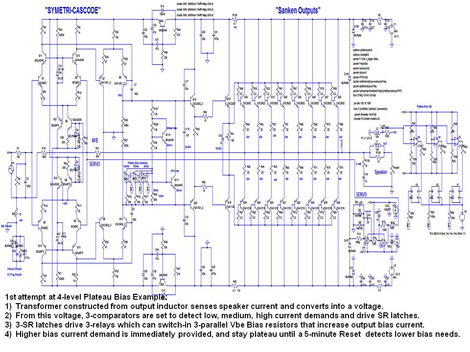

Anyone interested in working on Plateau Bias technology?
My amp protection uses all +/- 15V analog fault sense and control logic, and so does this Plateau Bias.
A microprocessor protection methodology would allow a "smarter" bias algorithm.
1st attempt at 4-level Plateau Bias Example:
1) Transformer constructed from output inductor senses speaker current and converts into a voltage.
2) From this voltage, 3-comparators are set to detect low, medium, high current demands and drive SR latches.
3) 3-SR latches drive 3-relays which can switch-in 3-parallel Vbe Bias resistors that increase output bias current.
4) Higher bias current demands are immediately provided, and stay plateau until a Reset after 5-minutes detects lower bias needs.

Full micro control of the EF3 bias would be a further step.
Quite easy to implement on a high Z OPS .
My 3 pair , lower rail (60V) Sanken OPS stays cool at 50- 200ma
bias.

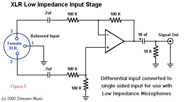

Just a simple op-amp circuit = balanced (below).

Not that it's a bad thing but in my case I didn't feel that balanced was worth the extra circuitry. I have a pair of jensen jt11p that I use to go from balanced to unbalanced. or to avoid ground loops. http://www.jensen-transformers.com/wp-content/uploads/2014/08/jt-11p-1.pdf

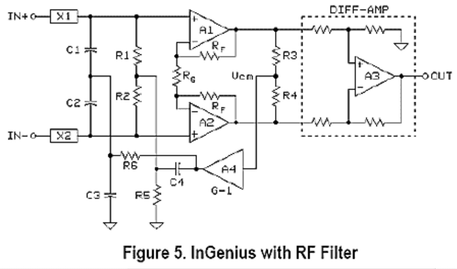

Balanced Line Receivers... It's Complicated.
Opamps can match on-die resistors to 0.1% and match transistors to 1% and match signal path parasitics. Critical for Balanced Line Receivers.
http://sound.westhost.com/articles/balanced-interfaces.pdf
The InGenius® circuit, covered by US Patent 5,568,561, is licensed to THAT Corporation.
http://www.thatcorp.com/datashts/1200data.pdf
Signal-Noise tests show very good results for Jensen transformers.
http://www.analog.com/media/en/technical-documentation/data-sheets/SSM2142.pdfBalanced Line Receivers... It's Complicated.
http://pdf.datasheetcatalog.com/datasheet/analogdevices/12157751ssm2141.pdf

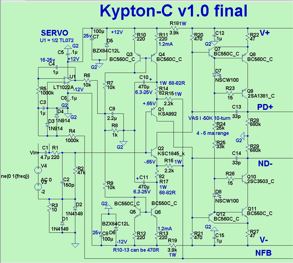

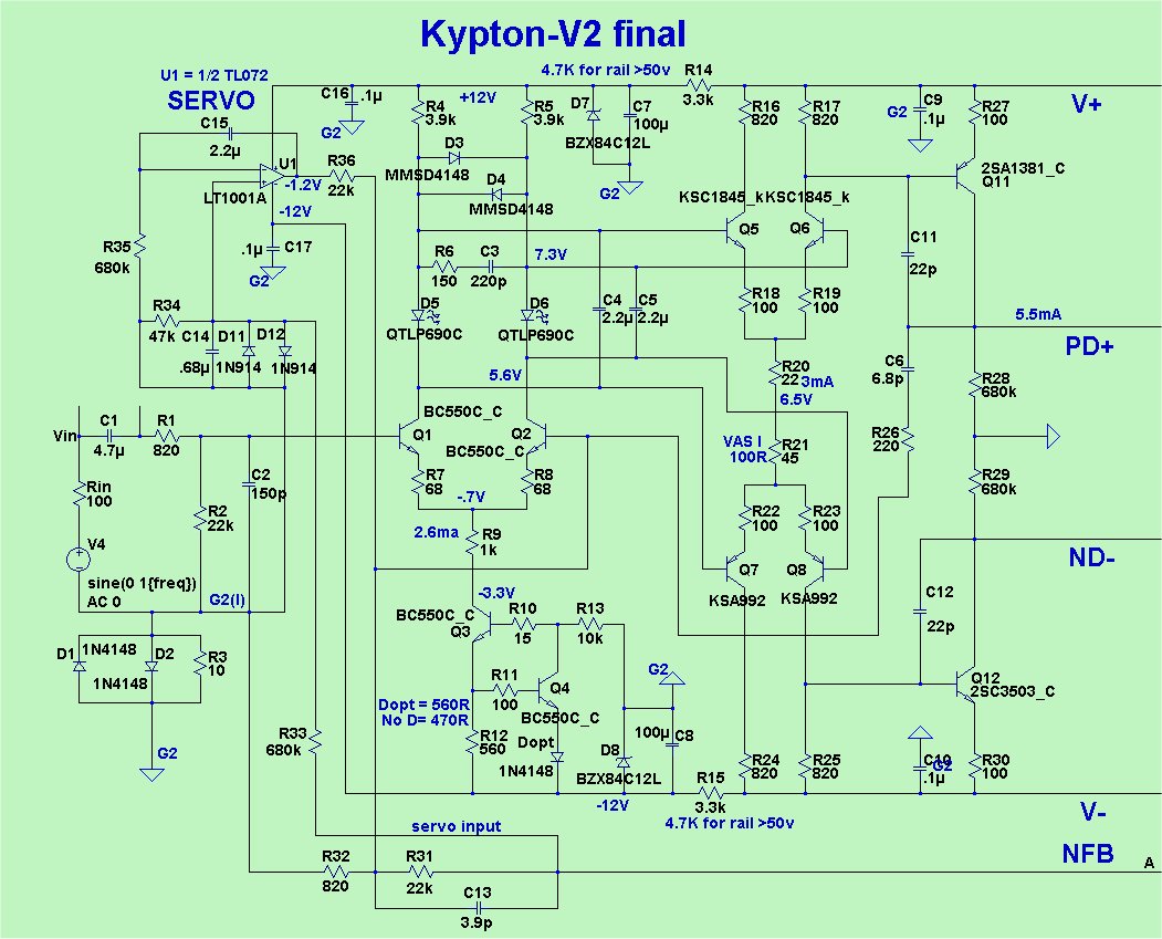

did anybody tried building Kypton V3 up and running well? I had some issues like in the above Kypton V2 circuit.
The D5 dims once you increase the voltage to 12V and we get very odd output voltage from VAS like +2.10V on the positive output and -0.8V for Negative. why is this happening what could be the reason that the D5 led is dimming to almost 50%.
