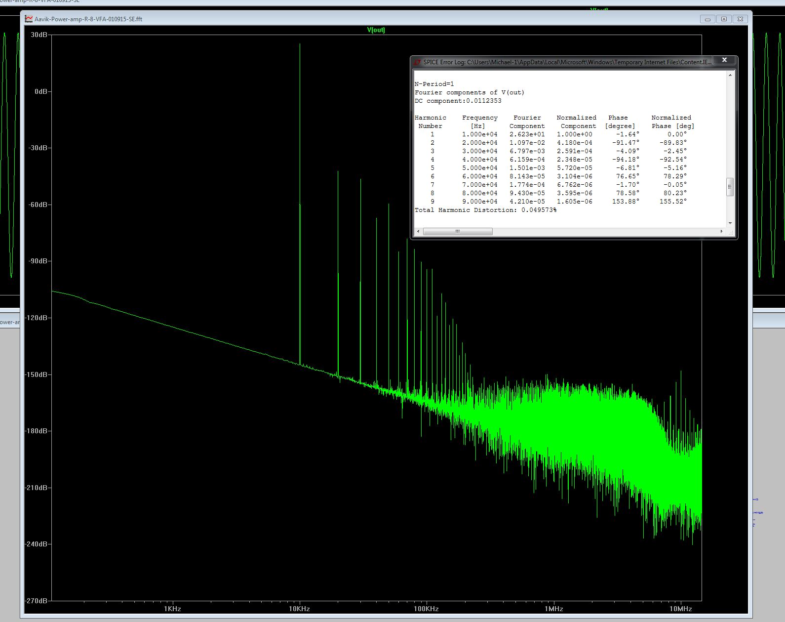

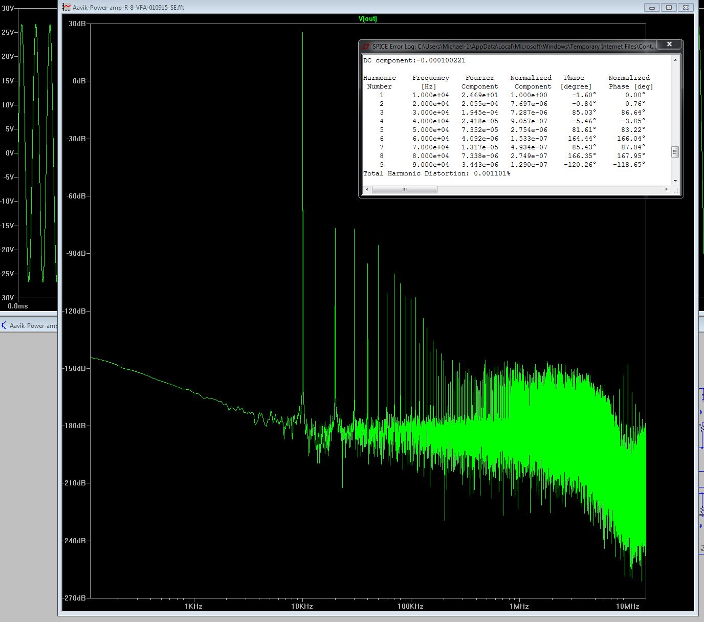

This will be my playground.... What will be the sonic effects of letting the OPS run open-loop. 0.05% Distortion from the openloop OPS@54Vpp 20 KHz is no too bad. But what will it mean for the performance. Damping will be a little less and distortion a bit higher the the 1 ppm from the closed loop, but the input circuit no longer have to deal withe what comes back from the speaker and cables... Will be funny..
OOHH when you analyse the loop-gain with the Tian probe something funny also pops up.... Gain bandwidth is very different depending on where you that the feedback, this puzzles me a bit. 80dB raw gain to 6-7 KHz on closed loop, and more the 100 KHz @ 50dB on the open-loop version
