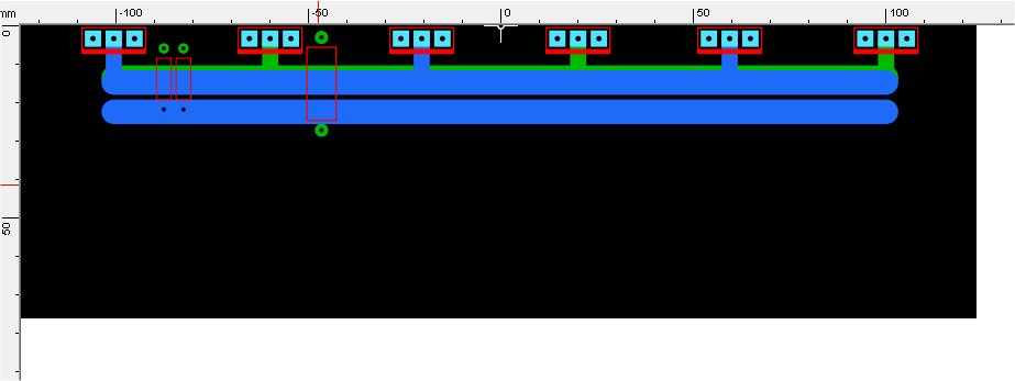

Begun work on the "unislew" (all in one).
Even as I will eventually have a couple tested , I'm quite convinced
these designs trump most OEM's.
I not "looking back" -
New slews will have - (below)
- Full rail cancellation with alternating outputs (P/N/P/N .....)
- Non- inductive parallel emitter resistors and an Ayrton-perry output inductor.
- Kypton-ND , Symasui , or Spooky versions.
-Integrated DC protect with FET SS relays.
-3 pair TO-3P or MT-200 output and a smaller fast Toshiba driver stage.
Oh , and a book to go with them.
OS
Building , listening , and tweaking these present creations is "school".
VERY hard to actually improve these base designs.
I have seen the current Accuphase , Pass creations - they have gone
the "twisted triplet" route right on to the main output stage ....
full cancellation right down to the last BJT.
Adding the special output inductor and paralleled emitter resistors is a
sourcing thing. I'm actually looking at current cheap mouser stock
to make these design decisions.
If I combine the current designs with these "anal" layout techniques ,
I believe we will have true "high end" in DIY form.
Also , a careful choice of the standard Nichicon caps ,
Vishay non-inductives and our standard Sanken/ON semi's will augment
this "next generation" .
OS
