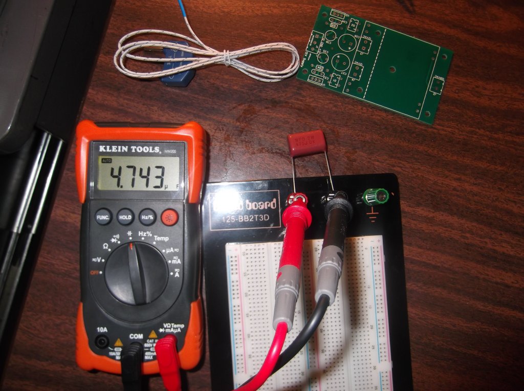

New test stuff , one of Jwilhelms little PS's (what trafo does it take ?) ,
and a oak board will make for some nice magic smoke.
MPSA 92/42 not too bad (Cob -Ft) ... still not as good as a cascoded
BCxxx or ksa/c 1015/1815 pair. Better for VAS/predrivers.

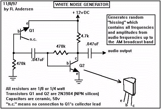

I've created synthesizer noise generators (below2) , easier to get reverse bias
noise out of 92/42's or 2n2222's. Very hard to get BCxxx to be noisy.
Maybe 1K gain through an op-amp.
Ps - cap meter is cool on that klein DMM ! 😎😎

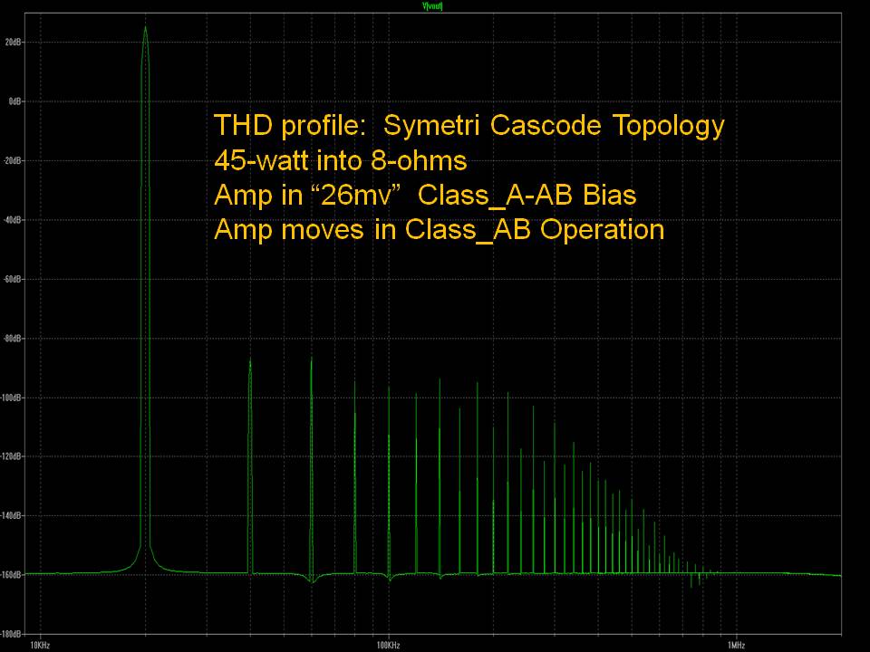

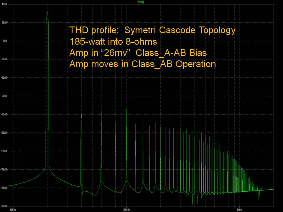

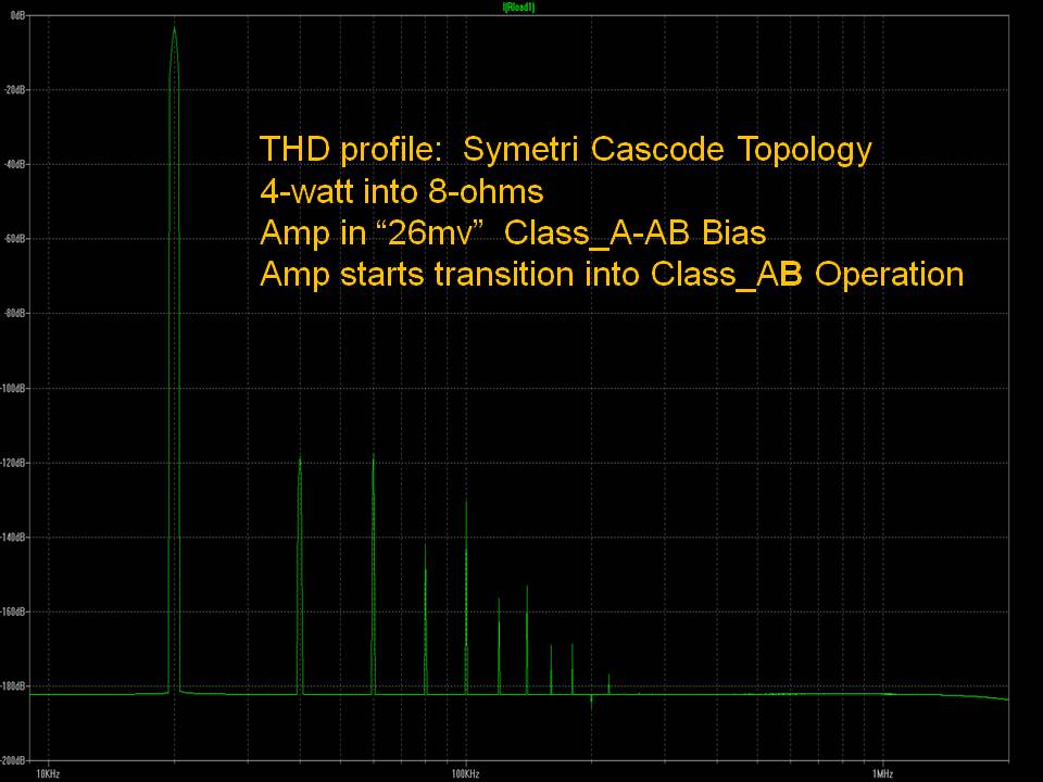

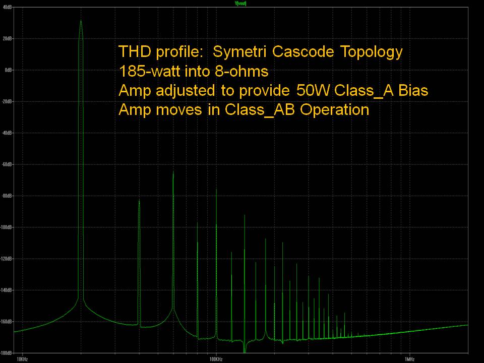

Should the Slewmaster - CFA vs. VFA "Rumble" include "smart bias" technology?
The shape of the THD profile has become a major good/bad decision criteria.
The shape of the THD profile is very different in Class-A bias than in Class-AB bias.
Sliding Bias and Plateau Bias technologies promise favorable THD profiles with modest SQ difference, and modest inefficiency in power dissipation.

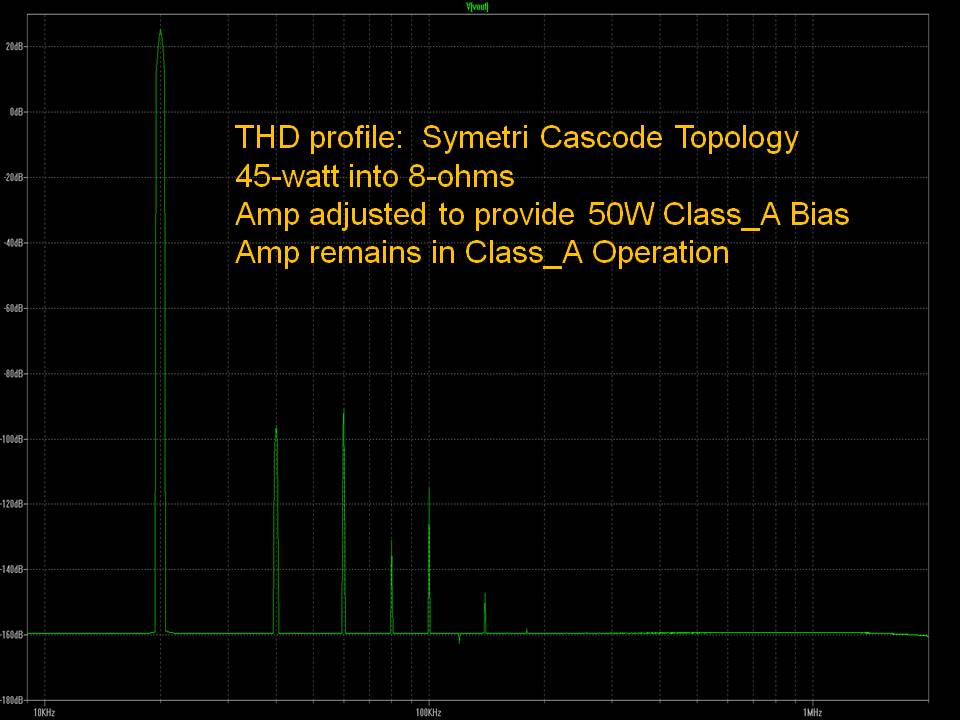

Attached a few LTspice THD profile graphs for the Symetri-Cascode topology with the "26mv" perfect Class-A_AB bias, and also with enough Class-A bias to cover 50W into 8-ohms. Naturally, the THD profiles are "favorable" when the power demands are below the Class-A bias power limit. THD sims for 185W into 8-ohms Class-AB only are included.

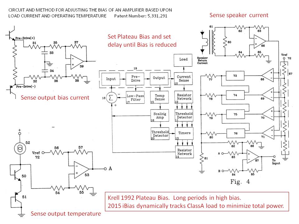

A few of my amplifiers have a 2-bias point switch option:
1) The Barney Oliver 26mv optimal Class-A_AB bias which provides about 5 watts of "clean THD profile" Class-A power before sliding into Class-AB operation; and
2) a mechanical switch for 50 watts of Class-A bias to heat the living room. The amp slides into Class-AB bias above 50W.
My big Krell VFA amps use a sliding Plateau Bias which senses large current demands at the Vbe circuit and "immediately" increases bias current for a "short period" before testing for "safe bias reductions". Krell has just patented iBias which uses a microprocessor to control the bias algorithm for Krells new CFA topology amps.(2014) Krell has completed a VFA --> CFA "Product Rumble".

Well, i believe we should prefer total HD under any audible threshold level than any "good profile" at a higher level.The shape of the THD profile has become a major good/bad decision criteria.

Your simulations reflect mine in A and AB.
I used the slewmonster 5 pair VFET OPS overbiased to simulate an amp. This , and
an over-sized heatsink ... would be a better testing ground for high power
class A operation.
The resistor in series with the bias trimmer of the slew OPS could just as
easily be a (switched) lower value resistance to toggle the VFETS over >500ma - (or higher) bias.
