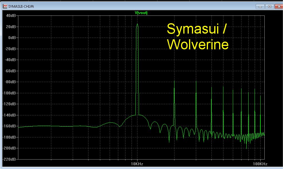

All the Slewmaster simulations follow a simple rule.
- CCS based single LTP IPS's = nearly equal even/odd order cancellation.
Symasui and Wolverine are very similar (below1).
-Symmetrical IPS's , like K-ND and spooky (below 2) cancel the even's
out nearly completely.
Having more of the even's is said to be more musical. Perhaps with an amp
that is >100ppm , this can be discerned. The problem is , at <10ppm -
both (type)amps are so perfect , they are nearly indistinguishable.
OS

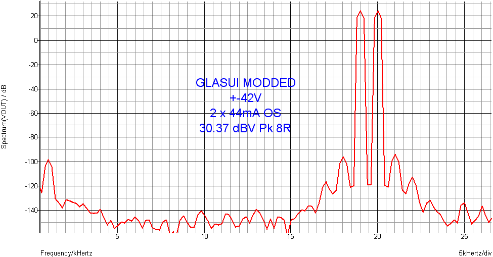

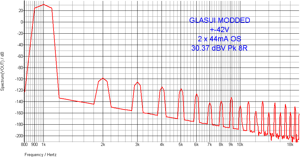

Yes that s the Sansui 3900Z, as for the 2nd harmonics it is at -98dBV while the fundamental is at +30.37dBV, at 10KHz H2 s at -75dBV.
With decent stability it s difficult to do better, and when i say decent it means up to 1uF loading without LR network, of course this imply drasticaly reduced slew rates, but as aknowledge by the IMD graph very high speed is not necessary to get very low intermodulation.
Yet again , I ask for the changes (schema). Numbers are (almost)
meaningless. 😀
