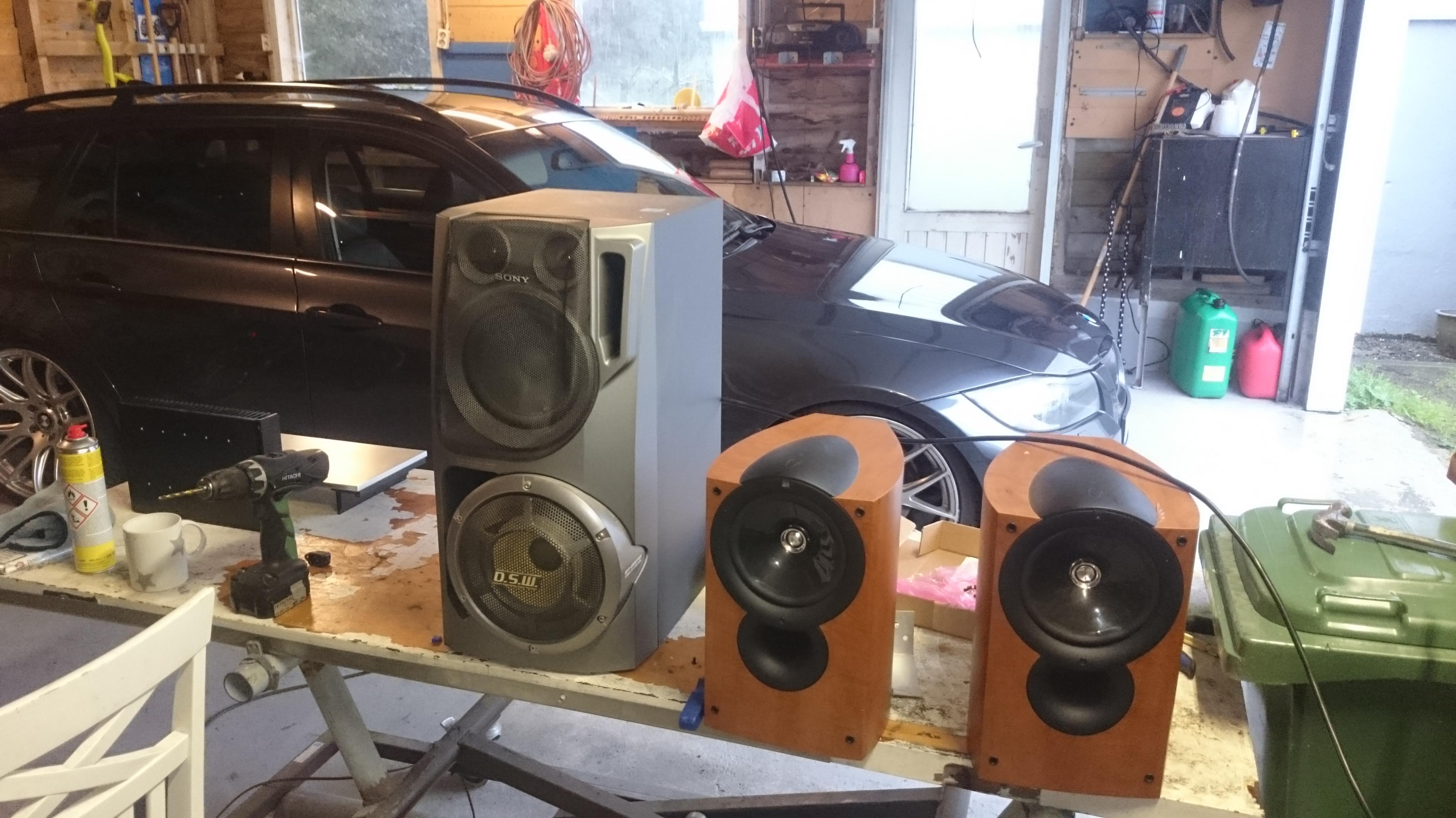

Seems like I fixed the noise problem, it was my little bear pre-amp causing the noise and low level. Using a streamer with variable output I got high volume without noise. 🙂

It's probably not the best environment for listening tests, but I'm happy with the sound so far. 🙂
Now I have some music while finishing the other channel and work on the chassis. 🙂

Good to hear you're up and running. A good pre-amp might be a nice project for the near future.
Yes I think so. It still don't play at ear bleeding levels,but I guess that's because I'm playing on junk speakers inside a 50m2 garage.

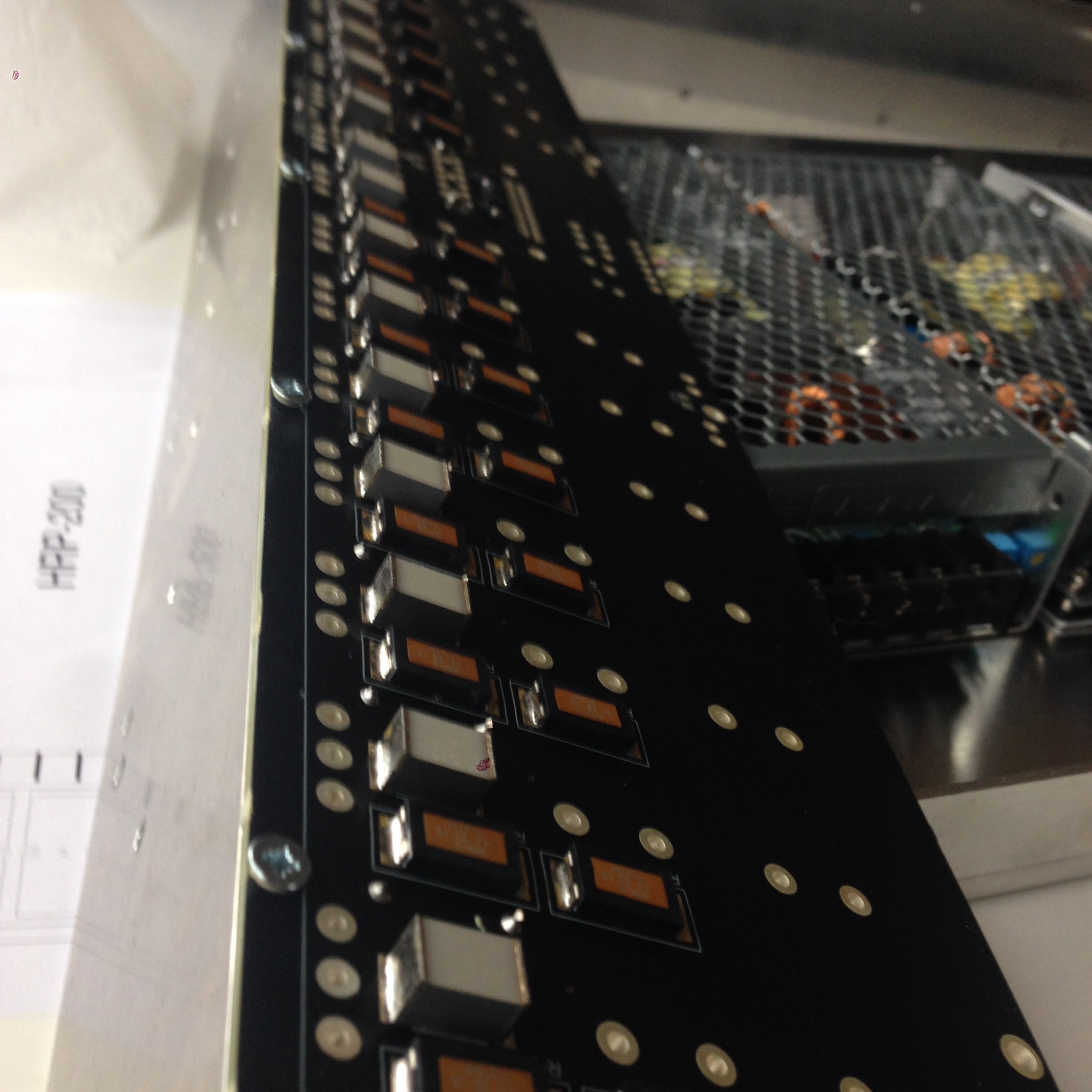

What boards ?
The big OPS boards have one small over sight , the interface euro's are 4.87mm spacing instead of 5.03mm. Not a big issue , but this should still be fixed.
