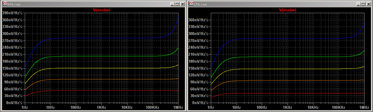

Oh, thank-you very much. May-I add your image (with a credit, of course) ?I did a .noise simulation on your example files. The CFA has slightly lower noise, but probably insignificant.
The source impedance is stepped re to blue from 100R to 12.5k.
In fact, I just added this because some inquisitor of the LTP church pretended that VFAs are noiser. Witch is stupid: same gain in IPS, same currents one transistor VS two.

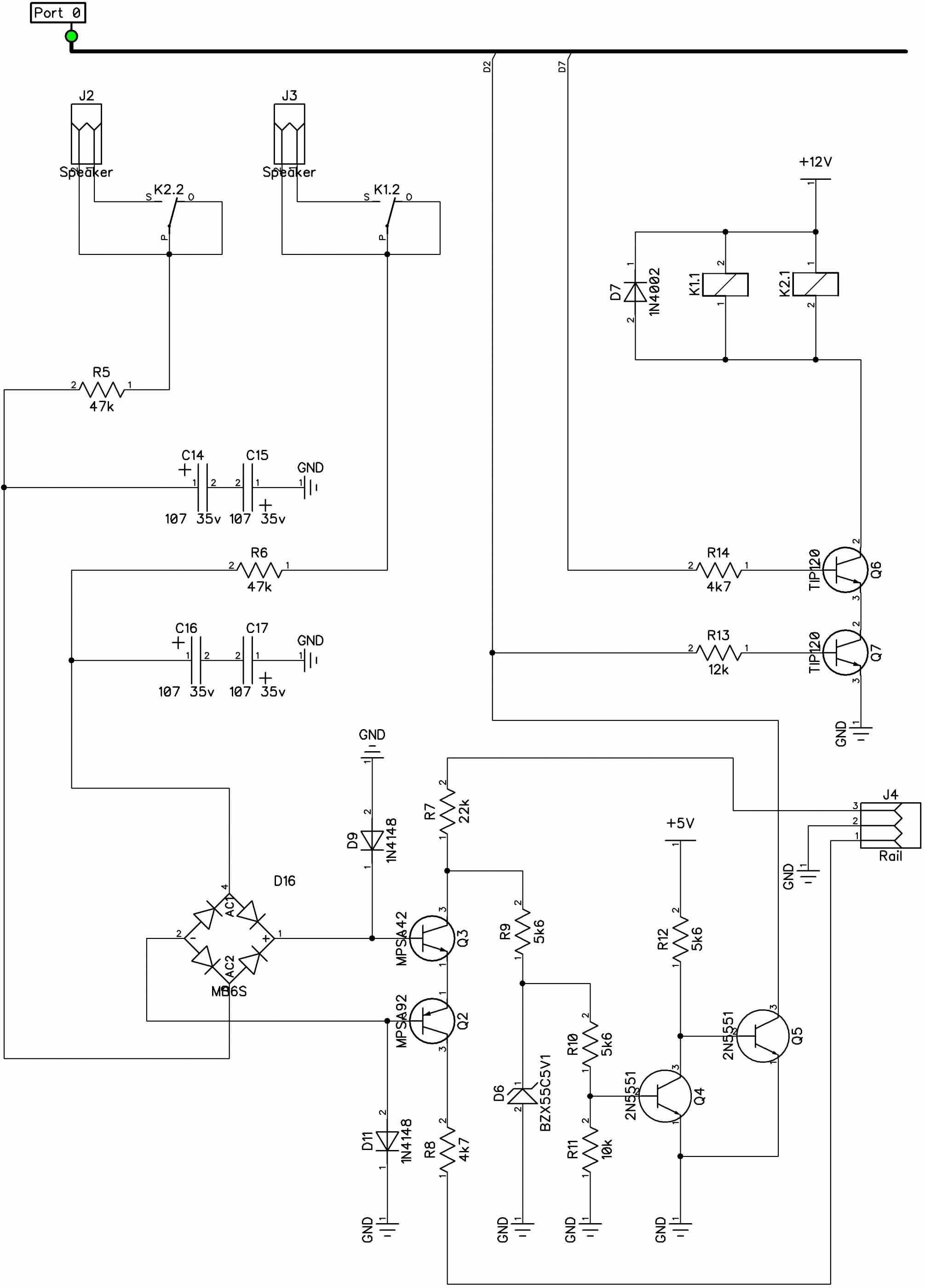

But esperado - simple (below - 4 trannies) !!
Just enough to save a speaker from DC or overcurrent.
-Powered by the rails.
-one 5-12V aux supply (relays)
-NO IC's.
Just my posted DC sensor with a 3 input diode OR gate -
delay/DC/current. This triggers the SS relay.
Soft start is a separate PCB.
Diodes , mpsa92/42's , caps and the FET's.
Nothing to scare first time builders off .
PS - been using this circuit for 8 months , speakers never moved
more than a mm before the relay activated.
OS

There's a few designs on the go placing this at the speaker binding posts. Either end eliminates extra wire connections.
But we still have the rails and the overcurrent opto.
And a timed monostable multivibrator triggered by a rail turning on.
So this 6-7 transistor circuit needs to connect to emitter resistors , the rails,
and a 12V aux. supply.
Might be better to have it all integrated.
OS

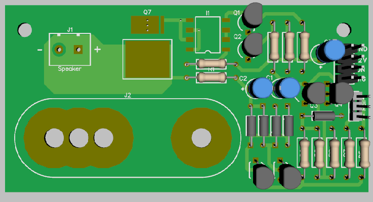

JW , looks like you have it all squished into a square inch !
That would be ideal on the main amp board.
PS- I would go the DIP route (with optional sockets - no SMD) on a
sprint6 creation (for the 2 opto's).
MOSFET's would be the only SMD , but they are big.
OS

If you are doing current sensing as well it does make sense to do it all on the amp.
I've got a system half designed to operate on a data bus with a microcontroller. A shielded 4 wire does a loop around the amp and takes care of it all.
That ones about 2 square inches. The relay driver IC is easier to find in SMT, but it's the same size as dip and easy to solder.
The micro would make some fearful. 😀
Navy Electricity and Electronics Training Series (NEETS), Module 9-3 - RF Cafe
That's the turn on delay (above link) ... just two trannies and a cap.
I'll tie in a dual color led (red=protect/green=good) no fancy flashing.
All the "21'st century" amp protection can be simple analog. All
the micro does is integrate the soft start and tie it all together.
If we wanted to tie this in with anything external , just a simple output
to report any protection event.
Yes, go ahead.
The vast majority of noise is related to the input stage topology and little else. So it's easy to make super-high performance designs and then discover they're noisier than most.
Source resistance from red to blue is:
Red - 100R
Orange - 1k
Yellow - 2.5k
Green - 5k
Blue - 12.5k
Done. Tell-me if everything is ok. Or send-me a private message if you want some changes.Yes, go ahead.
(thanks a lot, again)
