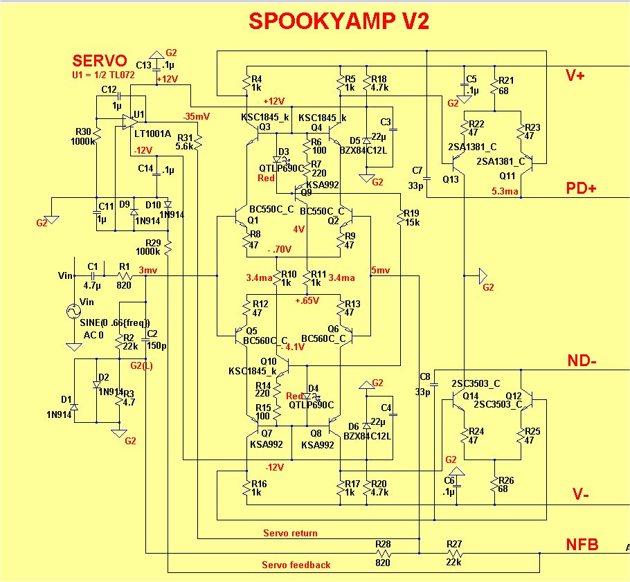

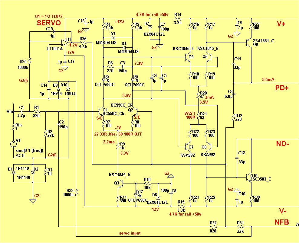

For the Kypton v 1.1 is showing Q1 is a 2SA1360 and Q2 is a 2SC3423. Is that correct or the BC 550 and 560 not as good?
Thanks for any direction or correction...
(Below) is the last kypton-V thimios tested perfectly.
And (below 2) is the spooky V2.
I will devote my time to only 3 designs , the new spooky / symasui /
and kypton ND. They are the highlights of these designs.
OS

What is the difference between the super vas in kypton ND and the way the vas stage is built in spooky V2?
Lower distortion? Different frequenci curve? PSSR?
What they have in common ...
They are both quite linear and clip perfectly.
The ND super-pair is also beta enhanced , no load on the previous stage.
I am a little wary of using it on the spook , which has higher gain than
the CFA. The super pair will actually show it's pole at @ 40mhx on a bode
plot .... but the CFA is 30db below unity gain at that point.
Also , most output stage Ft is below that.
So the ND super-pair VAS should be cautiously used (with the right
transconductance stage).
OS

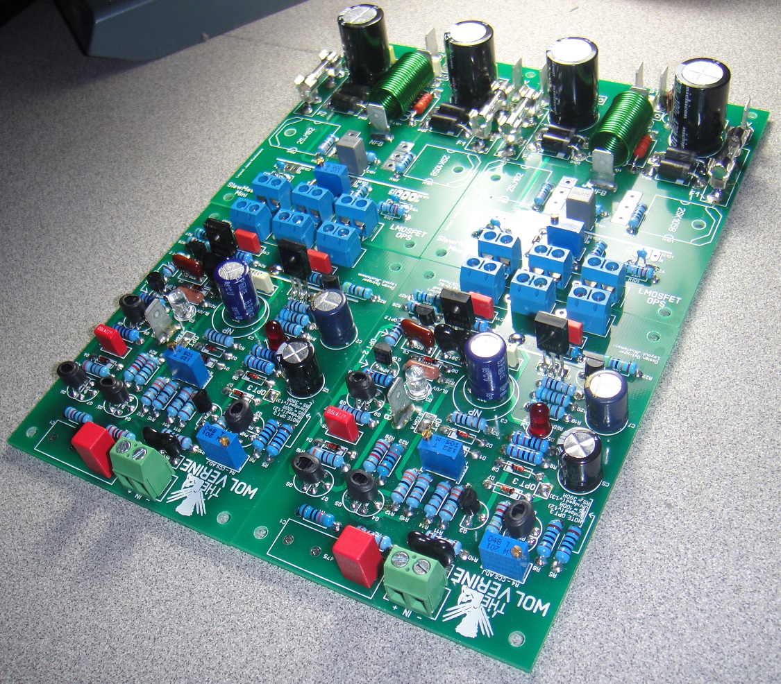

A whole bunch of people are about to receive boards. It would be cool to have a build thread for KND, Spooky, and 5 pr. OPS. Is it a dumb idea (for some reason) to use a single Sanken MT200 pair? Seems like it would provide quite a bit of power, with the possibility of adding 2 more pairs down the road. Thanks!

Sebastian,
The slewmaster series are very nice amps. The builds do not require hard to get parts. These are not kits....You will need to do some reading and follow the schematics. We are currently sending out boards contact me via private mail and we can work out getting a set sent to you.
Evan
