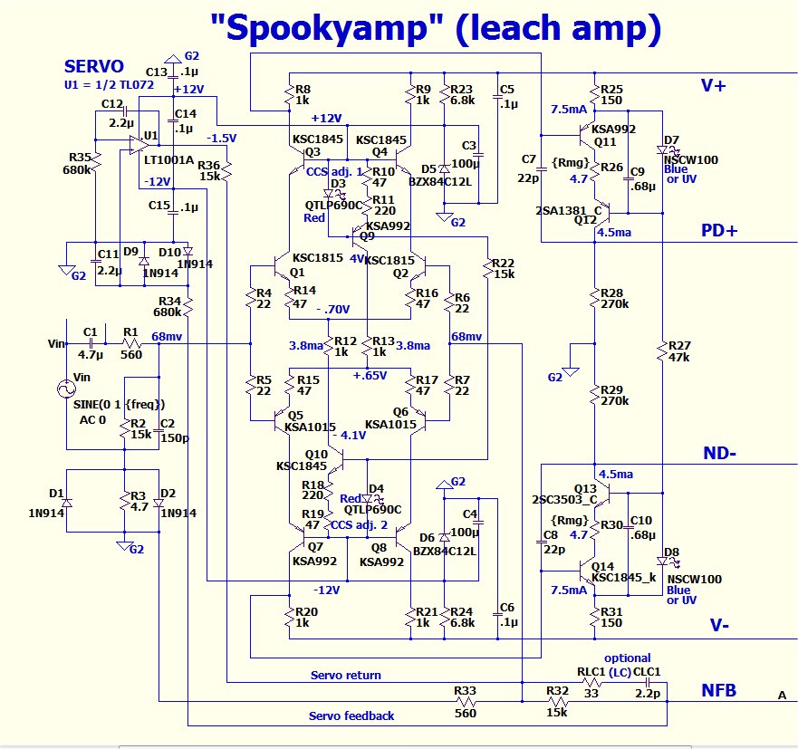

Hello Terry
greetings i want to make the orignal spooky amp is it possible to share
the schematic and pcb layout the one you have tested if possible
warm regards
Andrew

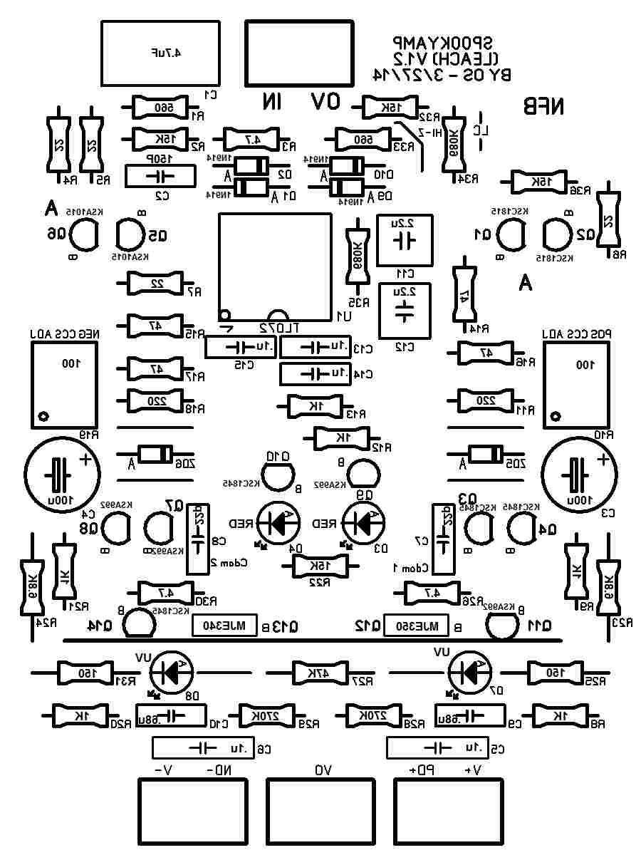

I'm attaching the schematic and an doc file with iron transfer the correct size. If you need more let me know.
Blessings, Terry

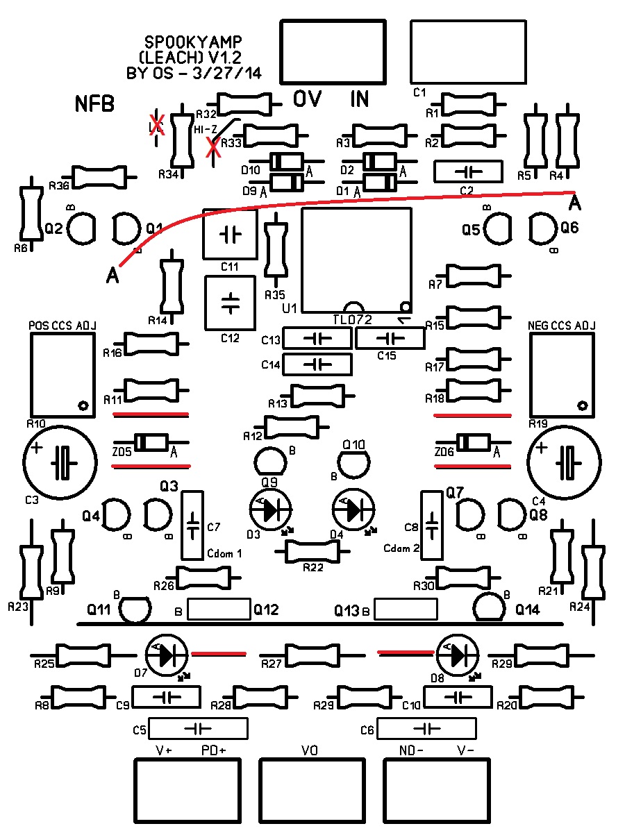

Hi Andrew,
I just looked over my Spooky and there are a couple things you need to know. There are two jumper wires that are not used and a long wire added from A to A. I have marked in red the jumpers used and X'd out the ones that should not be used on the attached silk screen.
Blessings, Terry

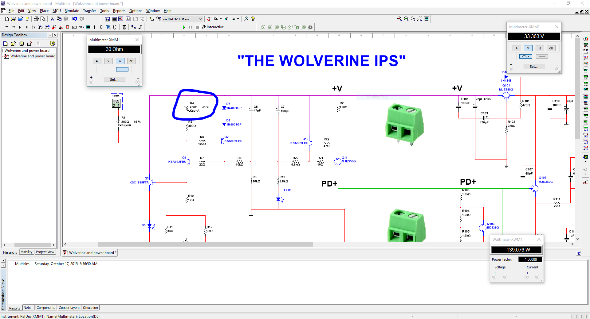

I need and advice I'm about to adjust the CCS on the Wolverine can some one give me an approximation on R4 value measurement a "close enough value" before I power up 🙂

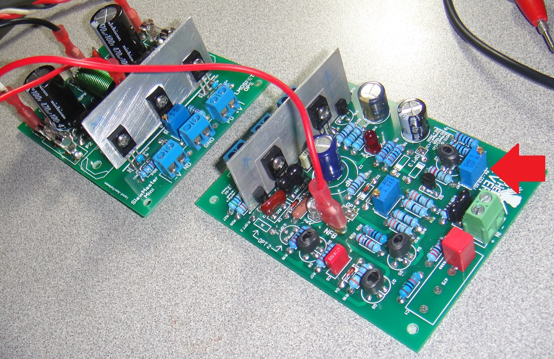

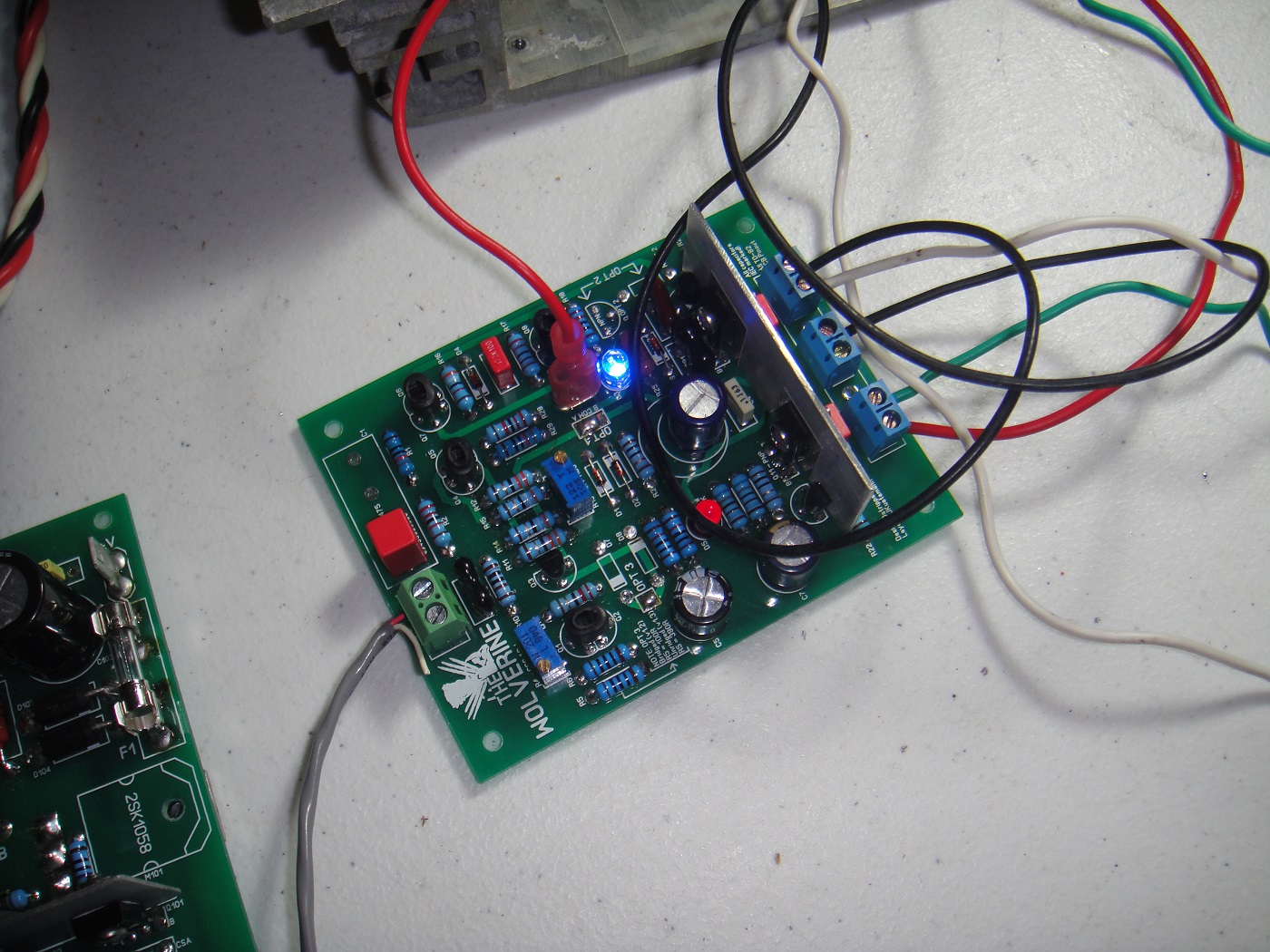

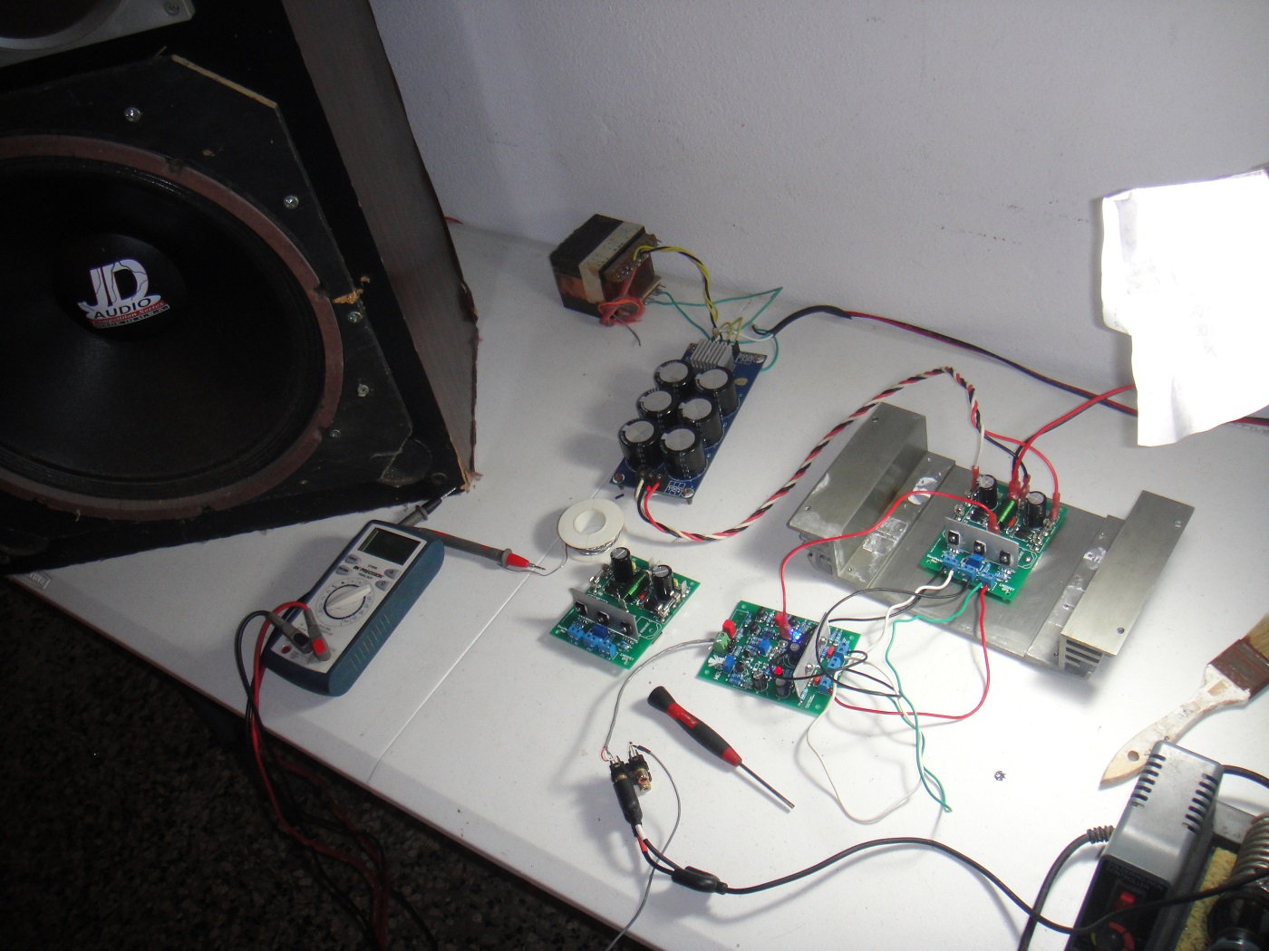

wow ! Wolverine is alive and the SlewMaster Mini surprise me a lot for been so small amp sound like a big amp wow ! amazing sound all so clear in Spanish, "suena muy bien" = sound really good 😀
I was able to adjust the CCS to 3.6V across R10 reading no problem 🙂 I made a mistake at first to be honest on the SlewMaster Mini I switch Q101 and Q102 and burn R106 smoked well is ok is part of the learning process jejejejeje I fix the problem and is all good now, 😀 but wow I'm so happy with the results :drink:
Regards
