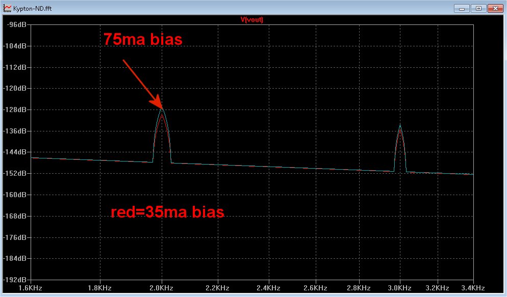

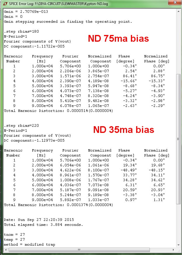

(below picture) The ND even cancels odd order MORE at 35ma output stage bias !
The OPS "suckout" cap is another player (C114). The output Cob,base-stopper,
and C114's R/C will affect the crossover distortion in the OPS.
.68uf is ideal. .33 uf to.47uf will reduce H3/5 >10K a little - but increase
it at 1K.
But , whatever the AB "glitch' looks like .... ND's speed will still negate it.
BTW , symasui also has this ability - but needs a little more bias to do it.
I Have my test OPS and plenty of ND's to send to RN Marsh (soon).
This is why I'm quite sold on further developing the Sym for VFA and ND
for CFA.

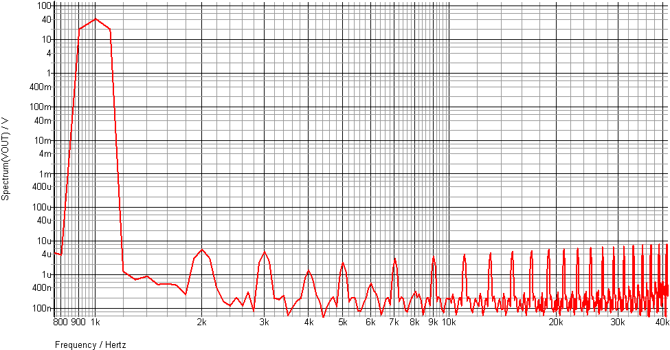

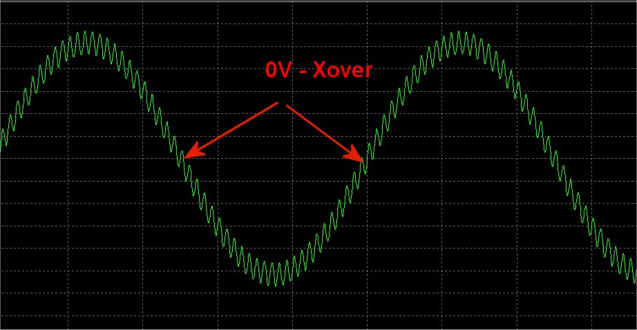

Thanks for positive comments.
Most people just consider a fixed input sine and calculate THD at output.
In the example (waveform below) , a 100hz waveform is crossing the AB
region with (imagine) ... even a more complex 5Khz carrier. On a real audio
signal , the 5K carrier might have many other frequencies (symbols/brushes ,
room reflections).
As this complex waveform crosses 0V (non-linear region) ,both the base
frequency and the carrier(s) must interact with this AB region.
So .... feedback must correct the base , carrier(s) , and any non-linearity
at 0V.
A (slow) VFA has a lot of phase variations from LF to HF in it's NFB ...
much harder to do the job above perfectly.
CFA's have almost
no phase variation across the audio band (and more speed).
They can correct even the most complex waveform as it crosses this
imperfect AB region.
In fact , a CFA can correct even a very underbiased (non-ideal) region.
Knowing all this also means the CFA has to be more sensitive to impedance
variations from the loudspeaker.
This should not be too bad as CFA NFB is usually dominated by the extremely
low output stage Z .... the loudspeaker would just be a small proportion
of the actual takeoff point impedance.
BTW , the "blameless" attempts this "EC" with the TMC feedback scheme.
It is only effective over a limited bandwidth and with a optimal OPS bias.
I think it is better to have a single FB loop that natively corrects (everything).
OS
