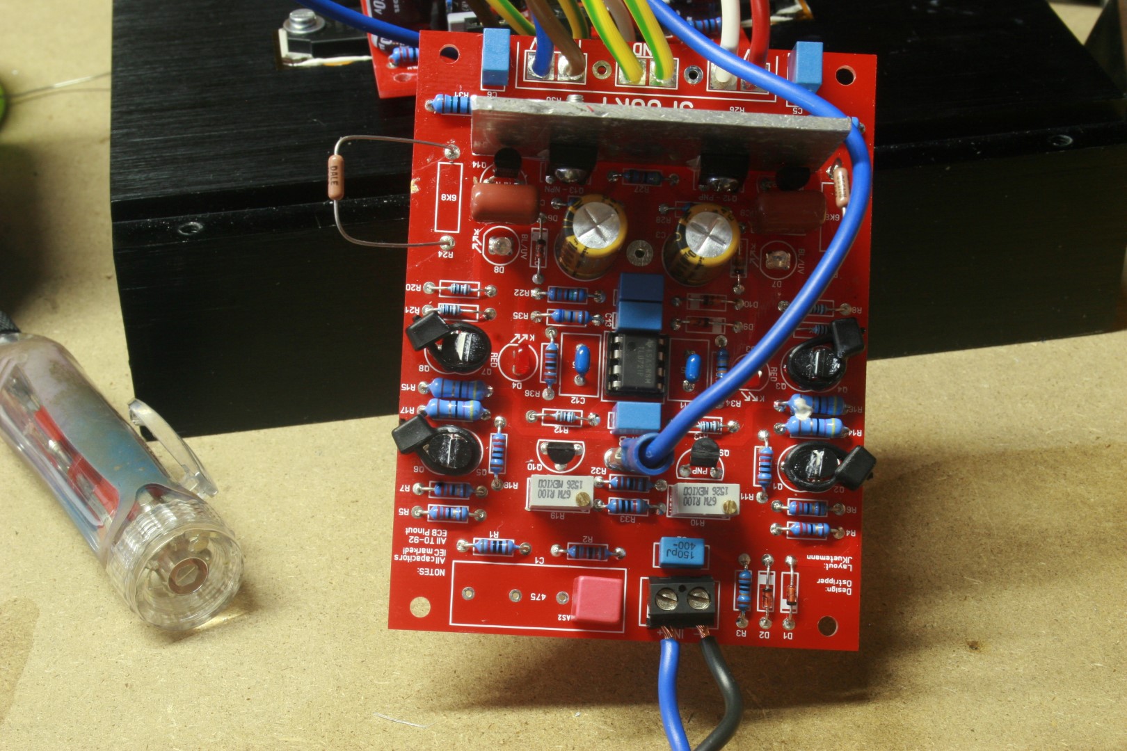

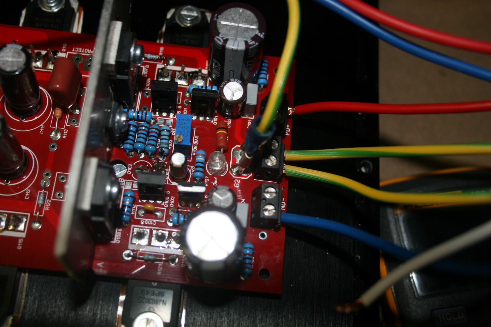

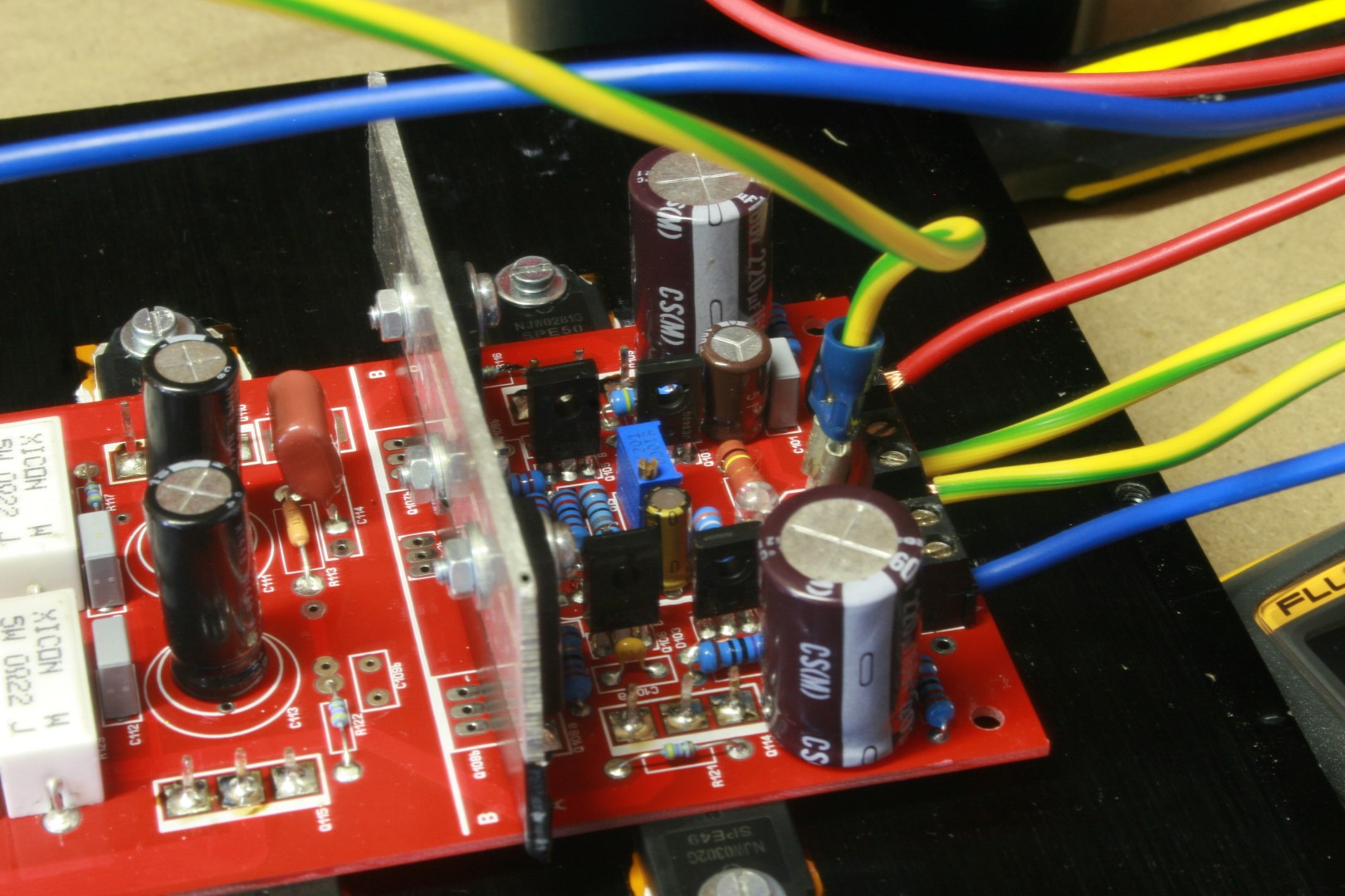

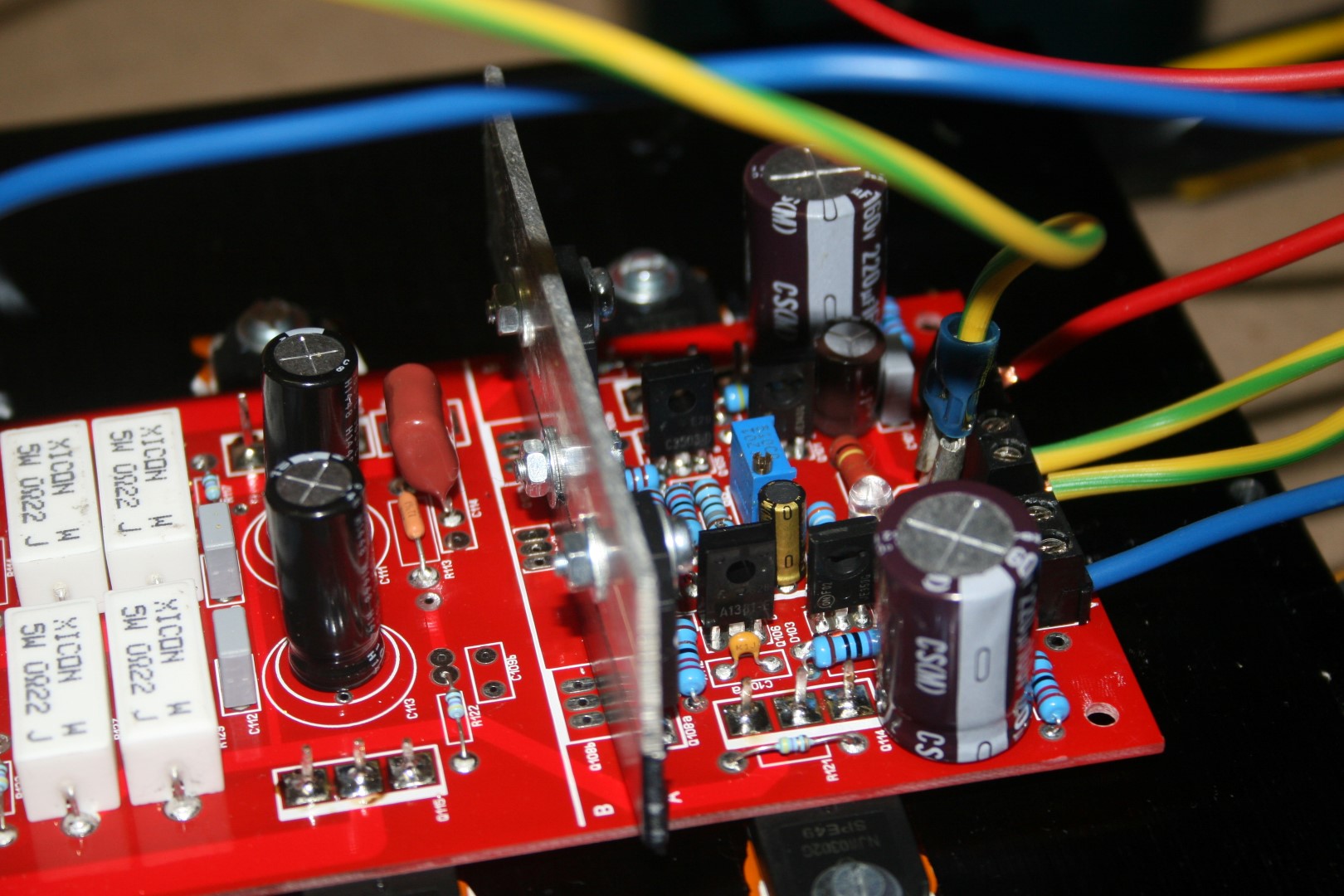

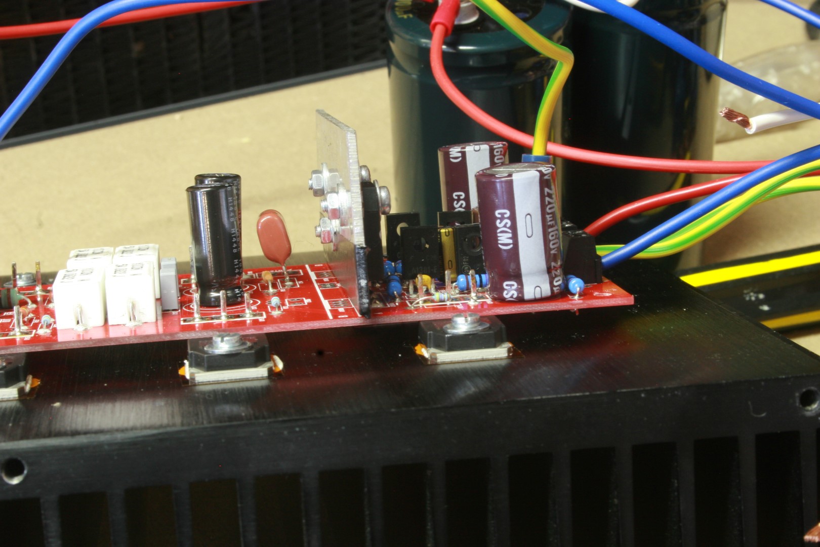

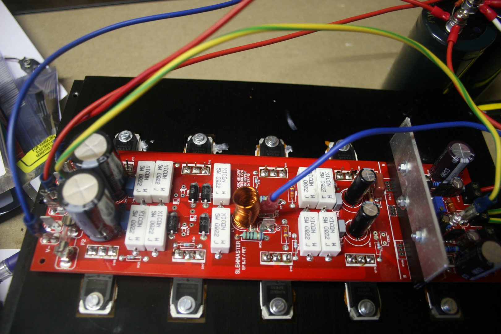

I tried to take some sharper pictures.
D102 is shorted.
D102 is shorted.

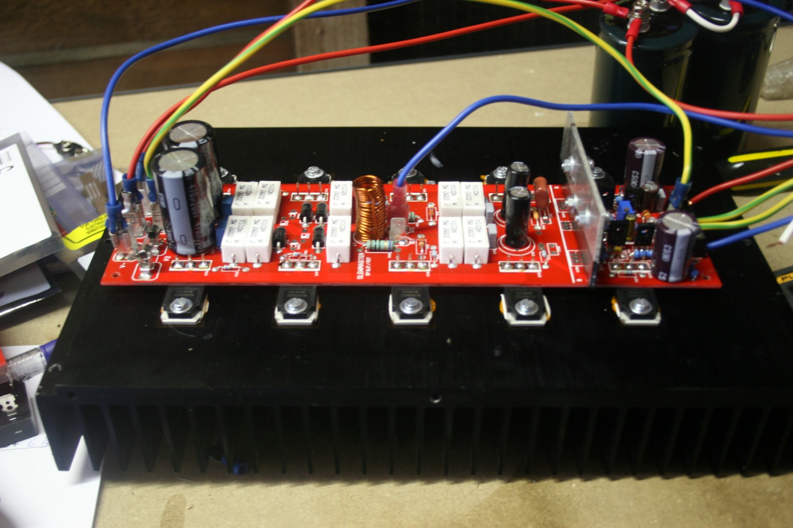

These are much better . Everything looks correct. Jason will likely be checking in soon. He's very good at spotting errors from a picture. When the board is powered up with 15 k resistors installed and the bias pot at 200 ohms, what is the voltage drop across R111, R112 and R113? What is the voltage between PD+ and ND-?
OK, so when testing the OPS with a 'dummy' IPS, such as a set of resistors from +V to PD and -V to ND we need to select the approximate value that yields about 5mA of current to ensure the bias generator becomes fully functional. Since your test supply is about +/-40V can you use a lower value than the 15K you have been trying please? We are looking to the 8K2 or there about value to get the required current. Then tell us what the minimum and maximum voltages are across PD-ND at the extremes of the bias adjustment.
15k resistors installed and bias at 200r.
R111: 0-1mv
R112:0-1mv
R113: 1.293v
PD+ to ND- 3.856v

OK, so the near-midpoint of the adjuster gives a bias spread that is in theory a little high to bias the triple. If you don't have any 8K2 can you series connect other common values to get you close, say 4K7 + 3K3?
I'm interested also in the available range of adjustment from minimum to maximum, reading the voltage from PD to ND.

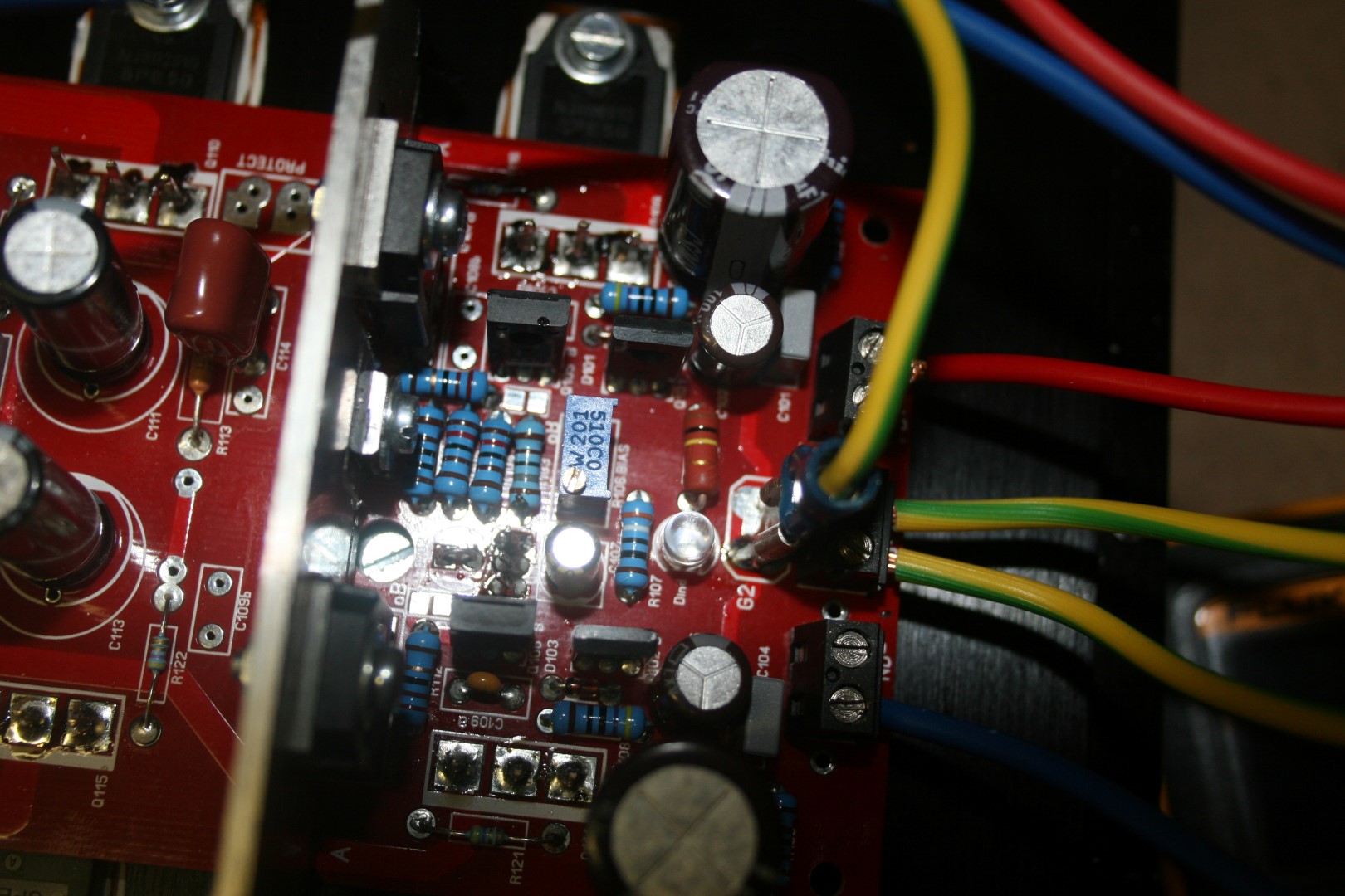

There may be something else going on, I will have to looks closely at your pictures to see if there's any clues there.
Edit: And there is! You should have used a 500R trimmer and you installed a 200R trimmer in the bias circuit on the OPS board. That will restrict your adjustment range and make it such that you can't get the bias low enough.
Wow, I was 100% sure that it should be 200r, so I wouldn't have spotted that. I have ordered 500r pots. Meanwile I will try to put a resistor in series with the pot for testing.
I put another 200r pot and a 47r resistor in series with the bias pot. Now I was able to start up the spooky ips and adjust the bias with the bulb limiter in place.

Eagle eye strikes again! I was mistaken on the correct pot value too.OK, so the near-midpoint of the adjuster gives a bias spread that is in theory a little high to bias the triple. If you don't have any 8K2 can you series connect other common values to get you close, say 4K7 + 3K3?

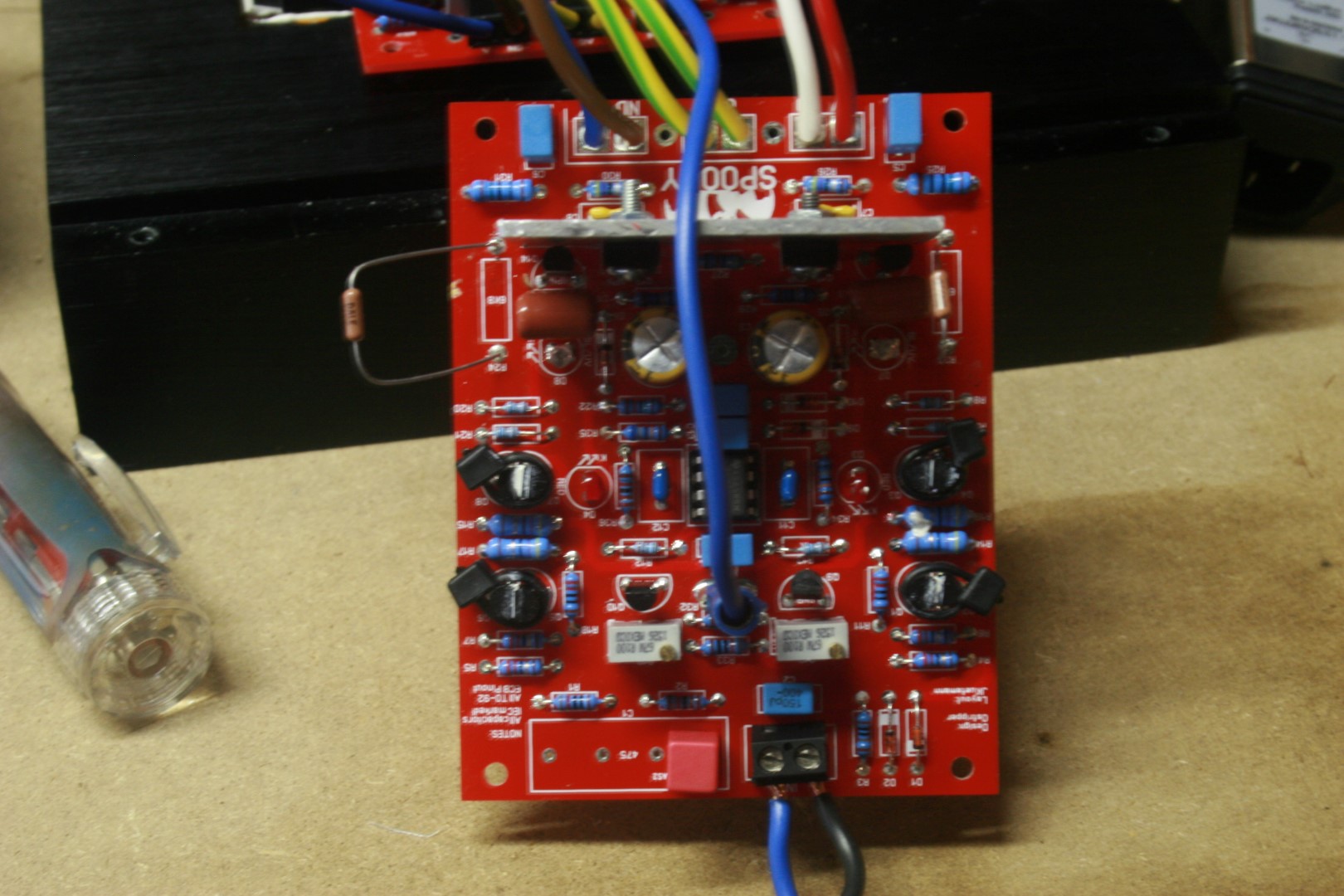

So, bias potentiometer bungle addressed temporarily with a permanent solution on its way. Now back to the low level / distortion issue. There are some IPS pics. I will look to see if anything pops up looking at those.

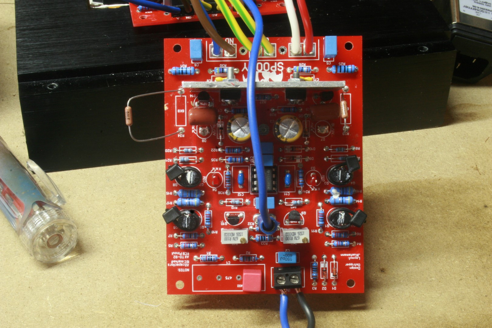

Can you post a picture of the IPS that is larger than the previously posted ones, preferably looking straight down on it? Thanks

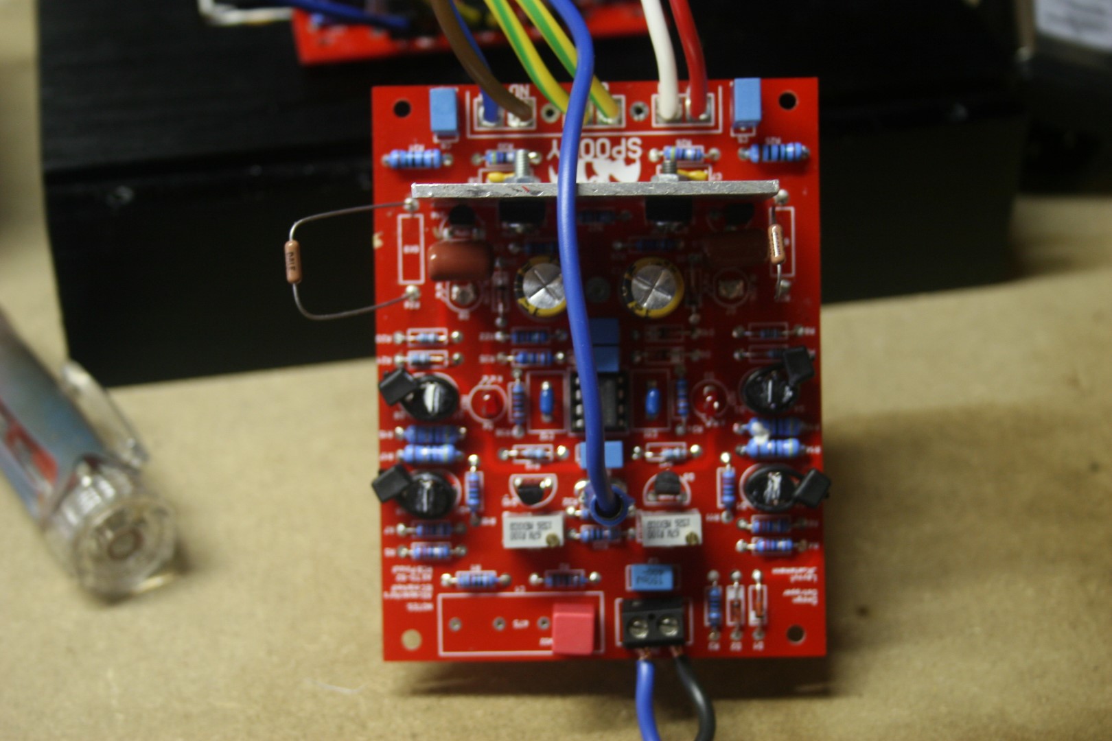

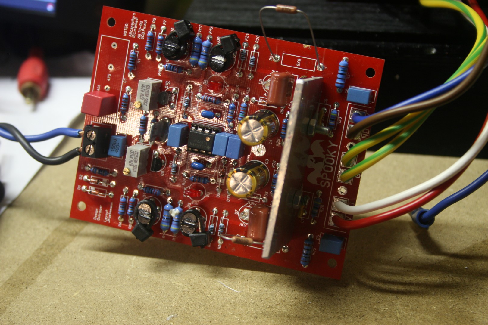

yngvejos, verify your DC servo integrator capacitor values C11 and C12. They look suspiciously small in size for being 2u2 film capacitors. Just a quick observation from you earlier IPS pics.

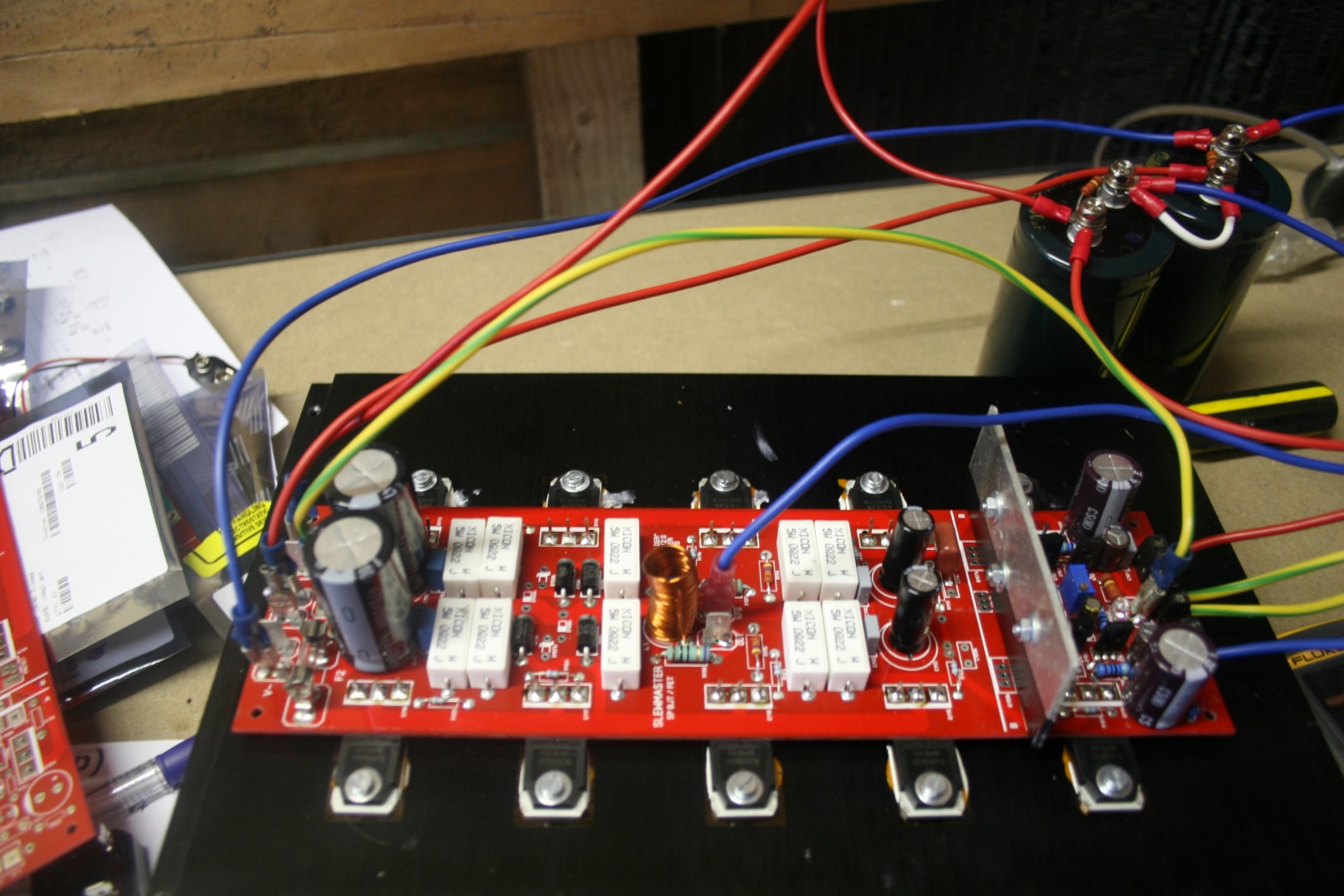

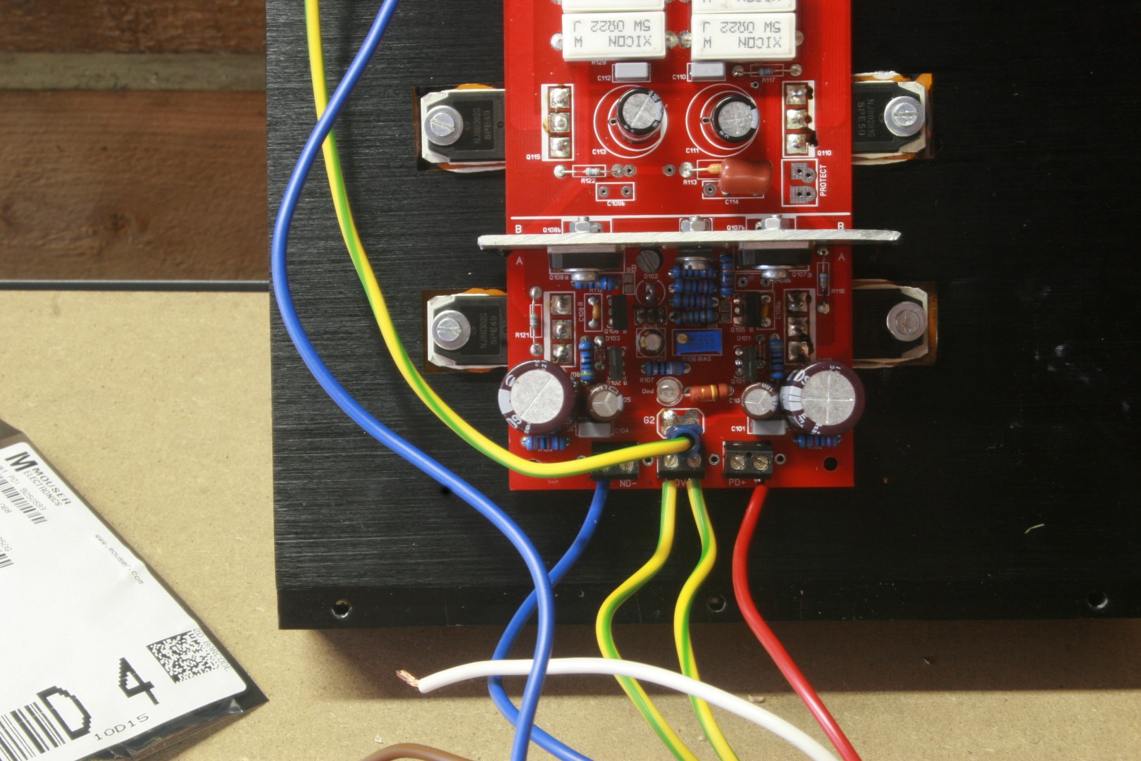

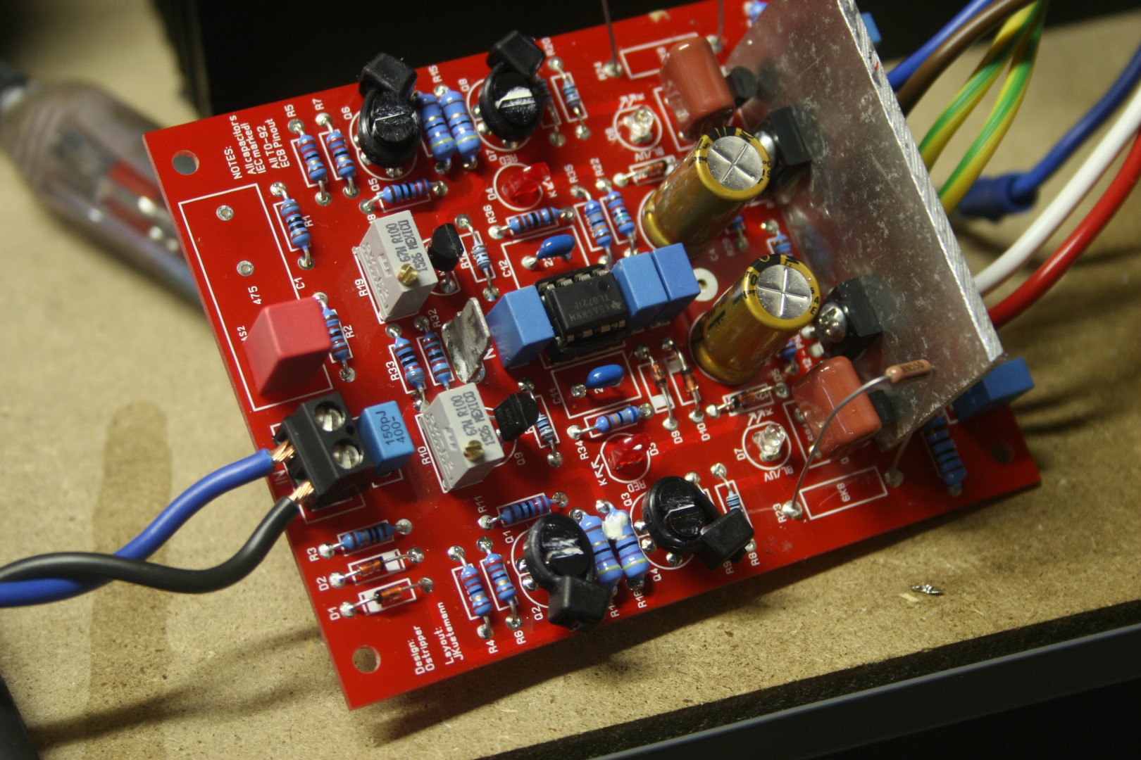

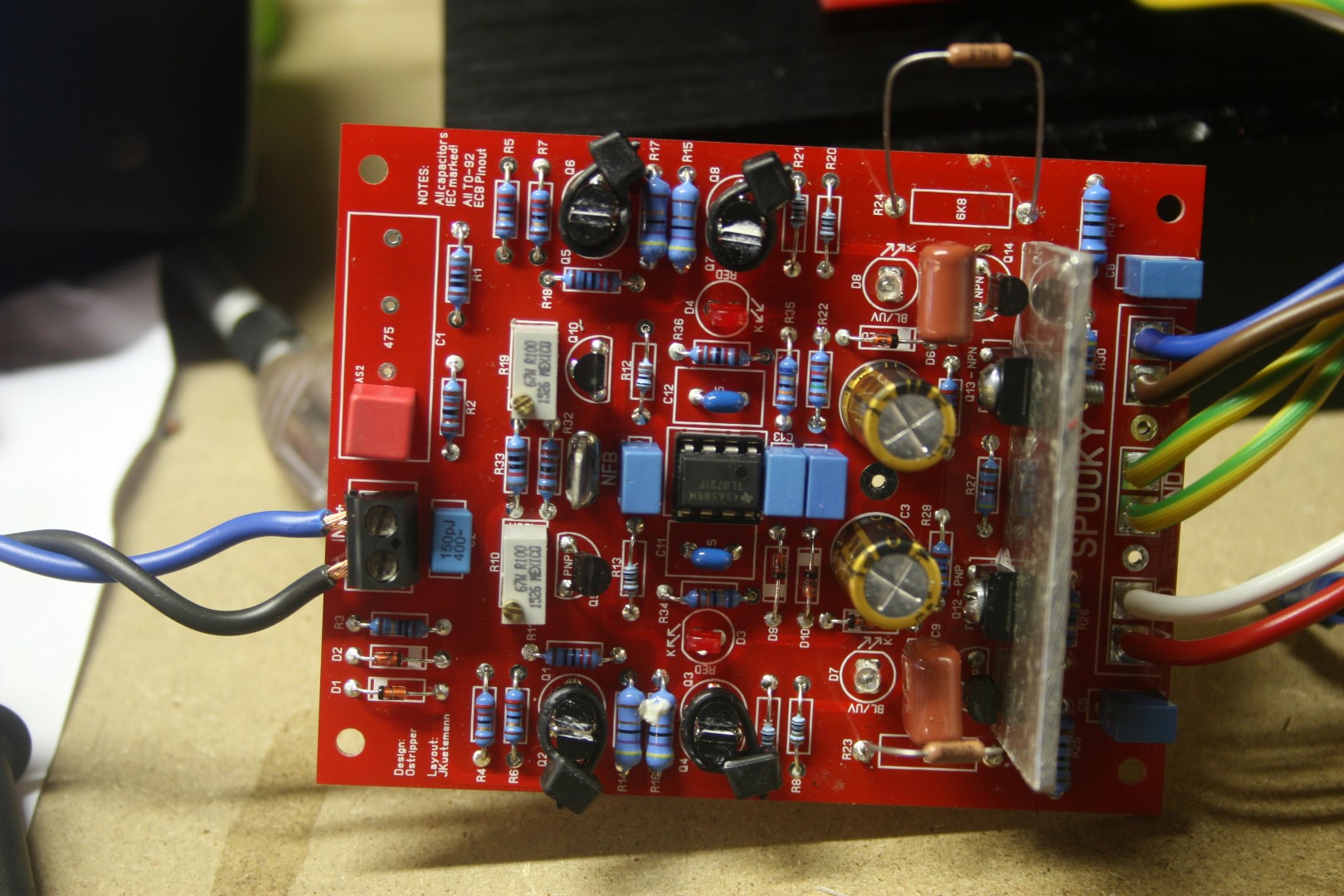

Here's some pictures. Let me know if you need any from other angles.
Thanks, those pictures are much better. I'll get a closer look at them.
Just in case you missed it in my prior comment, please verify C11 and C12 values. They look suspiciously small for being 2u2 film. As a sanity check you could simply pull the servo opamp. Spooky is normally well balanced and doesn't create large DC offsets without it.
I tested one with my esr meter, they are 2.2uF.
Edit: removed the servo and got 1.73v dc offset on the ops.
By the way, they are multilayer ceramics instead of film, does that matter?
I tried the other IPS board without servo and got 1.07v dc offset. Any ideas what causes this?

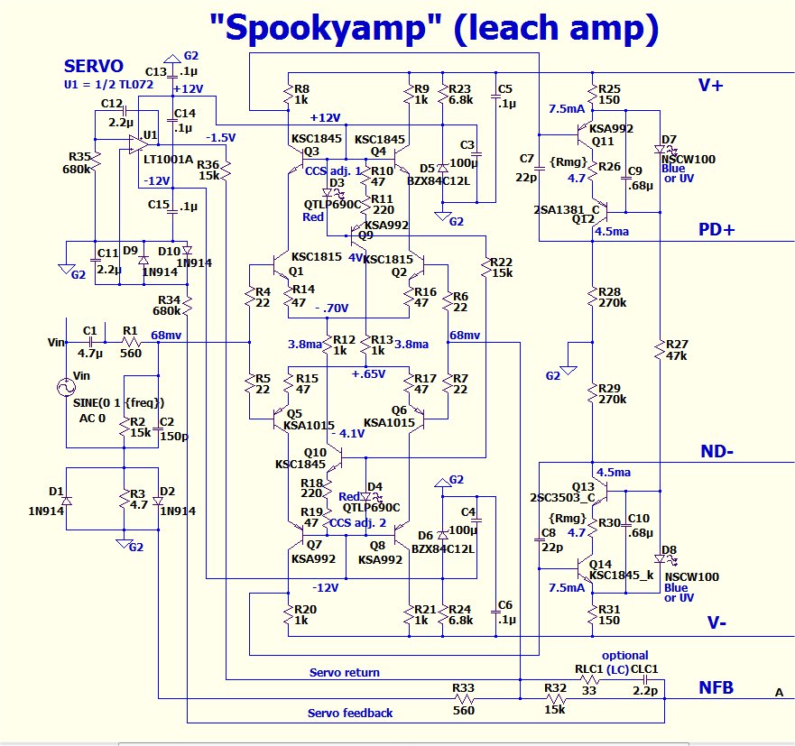

Here is the schematic you should be following. You have Q12 and Q13 correct.
DC offset without the servo in place is usually mismatched gain of input transistors. If you match the gain on Q1, Q2 Q5 and Q6 this should be closer to zero.
2SA1381 and 2SC3503 usually aren't available in the same gain ranks. If you look at yours you will likely see A1381- E and C3503-E. The E designates a higher gain on the device. This also causes some offset. Negative feedback and the servo both correct these offsets.
The preferred capacitor in the audio path is film or mica and X7R ceramic for small decoupling, but anything usually works. This and grounding schemes are probably the cause of 90% of disagreement in the audio world.
Mine are 3503D and 1381E does that mean that the 1381 has much higher gain then the 3503? I might have some 3503E or 1381D laying around, will it be better if I can get both to be E's or D's?
The gain is higher with an E gain rank, but negative feedback takes care of it. Most of us run these devices with the mis-matched gain rank and have no issue.
These won't be causing any issue. DC offset with the servo removed isn't normally a concern either, as long as the servo is able to bring it down to an acceptable level, but it is something that is nice to have closer to zero.
