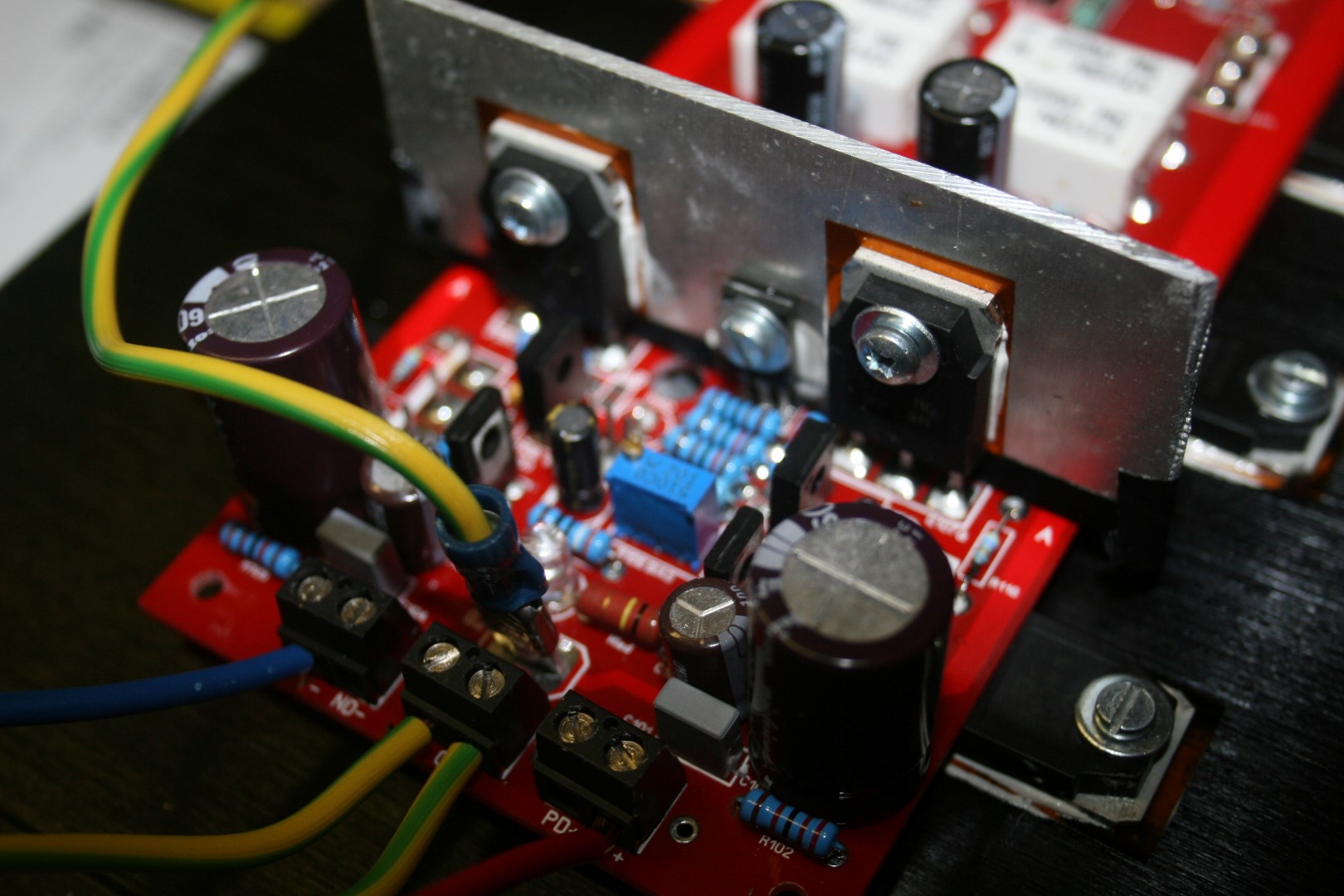

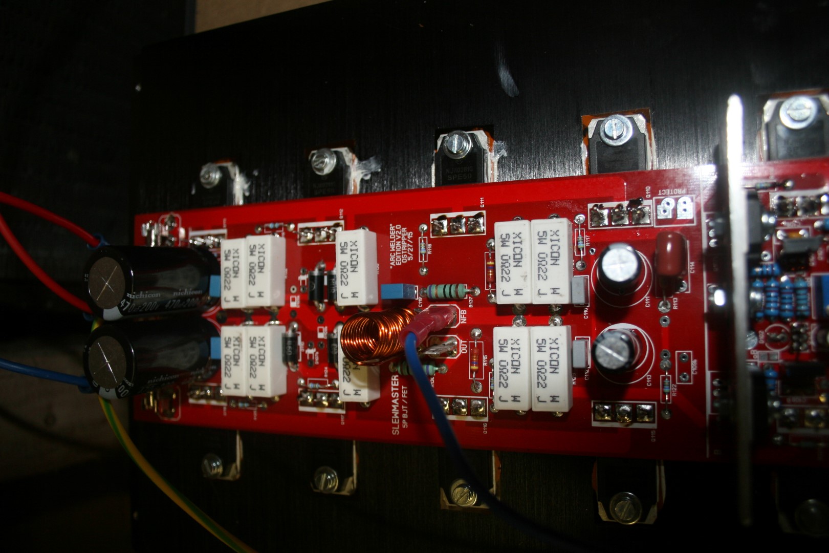

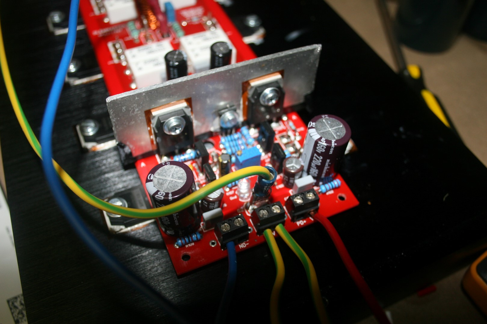

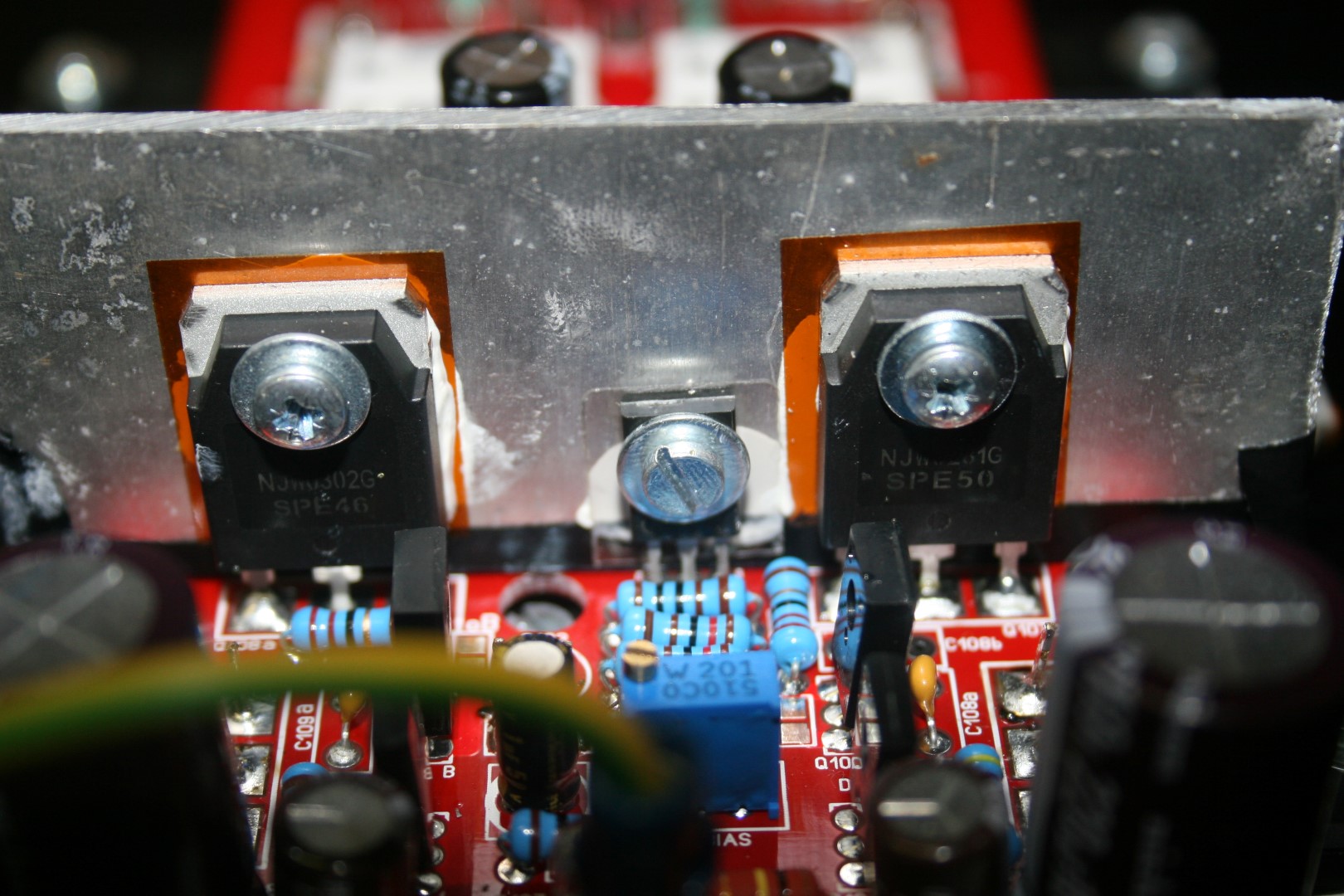

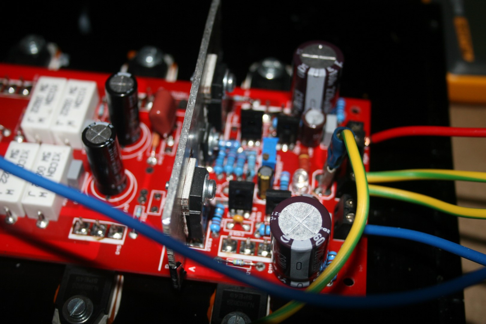

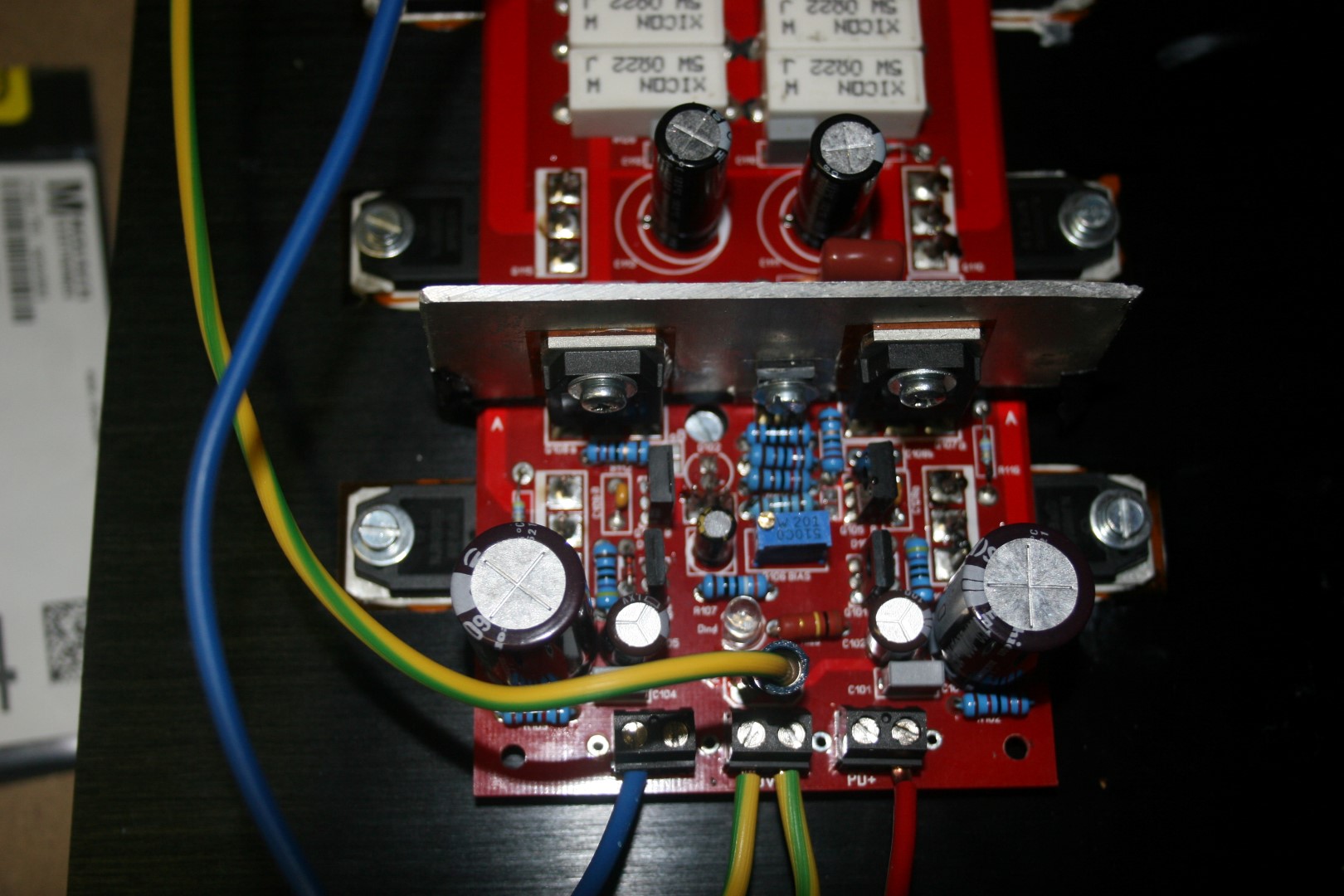

Here's some pictures:
The pictures seem to all blur around the resistors I can't quite see them. Is D102 shorted? It should be.
