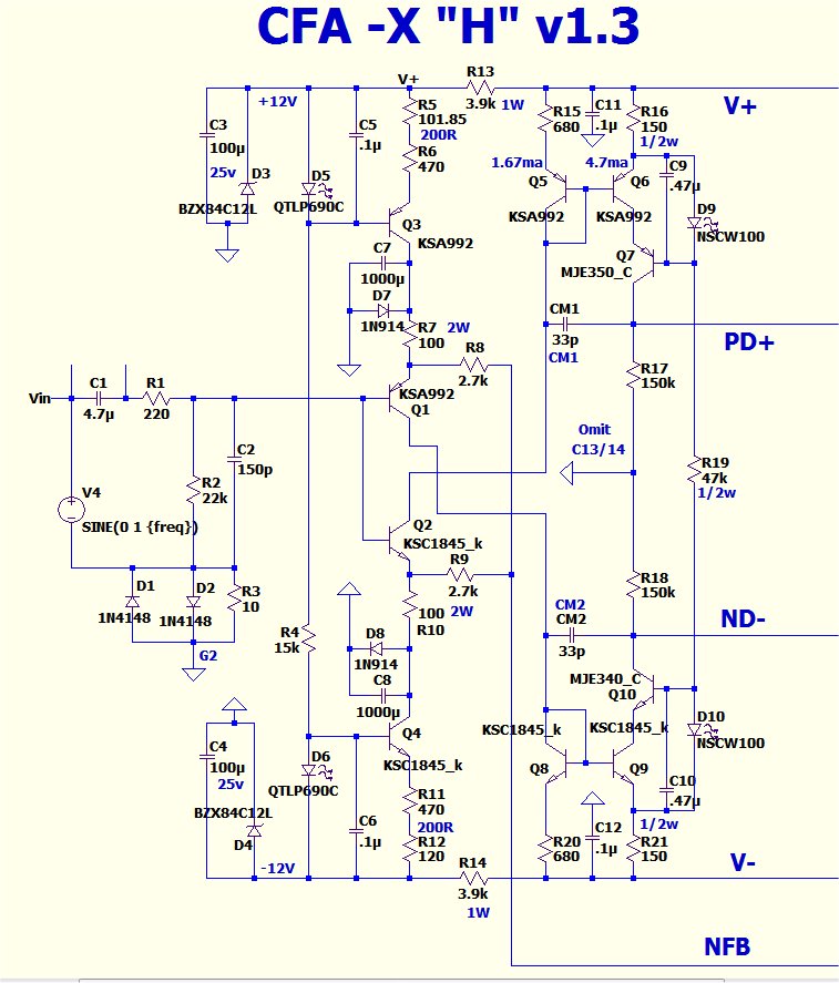

I am on completing CFA XH 1.3 BOM to populate my board. Could you advise me Voltage rating for 1000uf cap C7 and C8? I will use 50V rail. In jwilhelm capa Bom he indicated 50V....

That's on the 12V end of the input board. 50V will be fine. If I remember correctly these boards had limited space for that cap so it was hard to fit a 100V cap there, otherwise I would have used one.

I had in mind i could use lower voltage rating since ithey was at 12V end (same as VSSA) but i am wrong. Even in 50V it's difficult to find 5-13mm model in good brand many are 7.5-16mm....

Lower voltage should be okay there. I like to put higher voltage caps in place in case of failure of another part like a zener so the caps can't pop from overvoltage but it's likely not necessary. I use 100V everywhere normally.

I redrawing Symetri under Diptrace. I don't know if it is a mistake but i found a difference between schematic and layout => C9 (R33 if we follow straight the schematic) should be connected to Q8 collector and C33 but not to Q8 base

way too much gain , not enough phase margin.
I'm finalizing the design with 68R's (Q1-4) 47R's(Q7-10) , the fixed (collector)
to NFB network PCB error , and 22-33pF's for miller.
What you do with the 22's is have the amp with gain at or above the point
that the phase is 180 degrees + = oscillator.
Some transistors might work with 22 , better to increase the range of
beta with more degeneration to accommodate "whatever" a builder
might have in the parts drawer.
Thank you for pushing the limits , I'd rather have a very stable IPS.
(and NO complaints).
