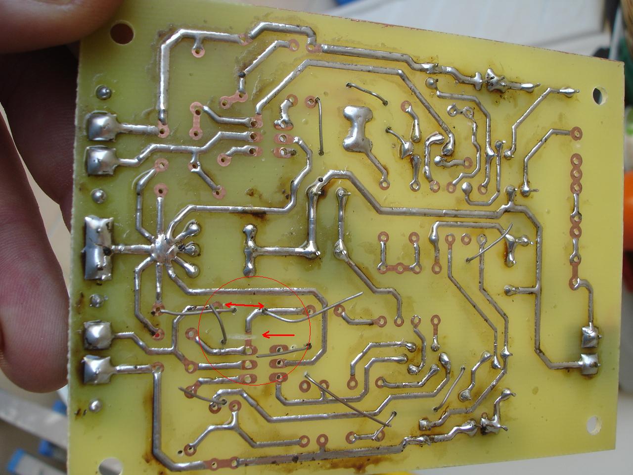

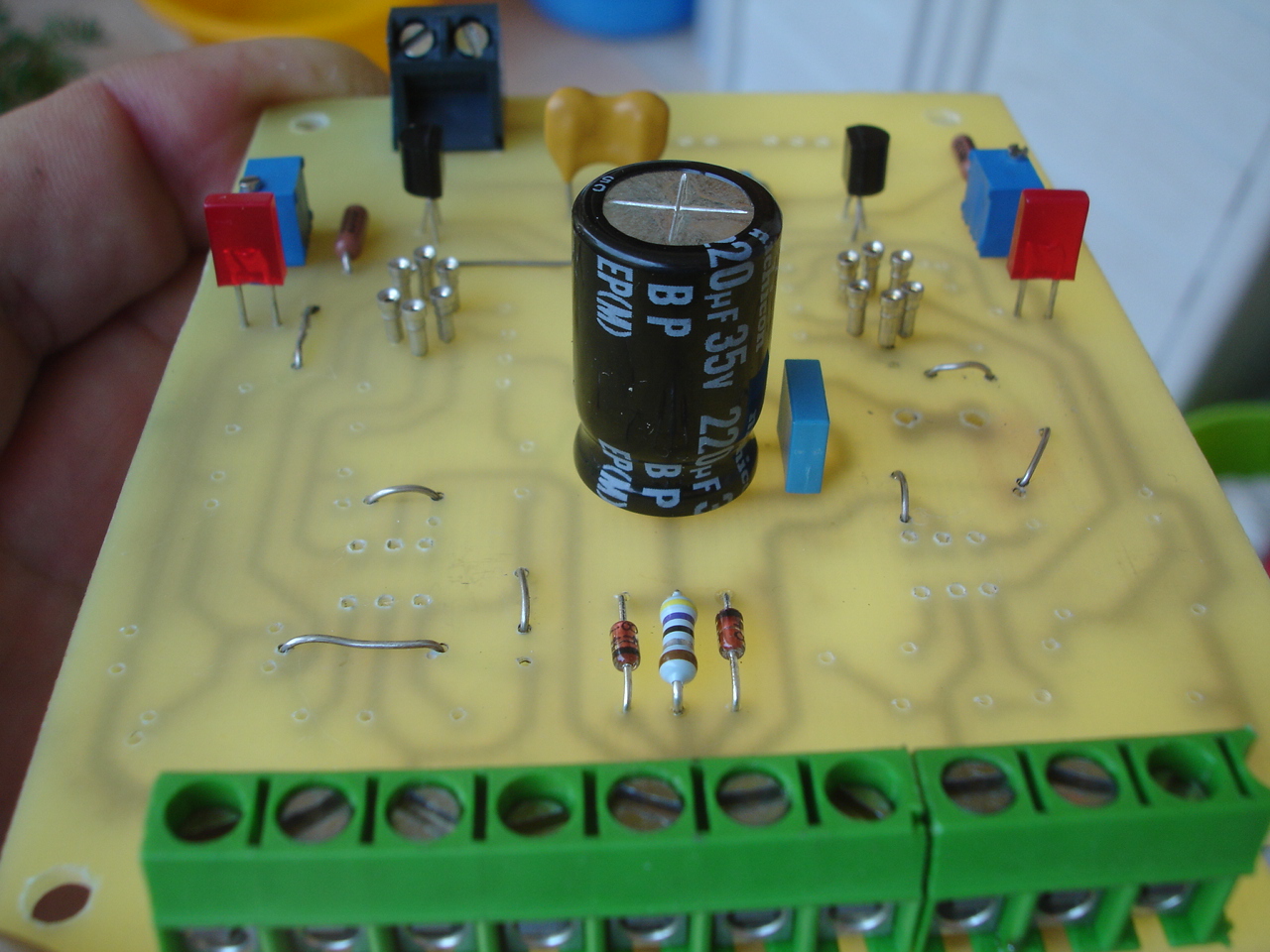

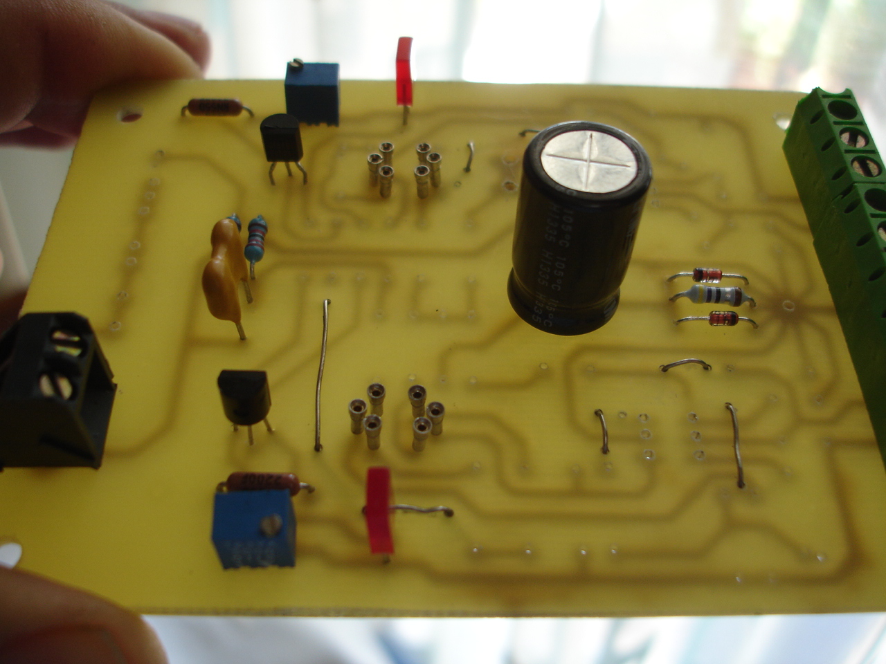

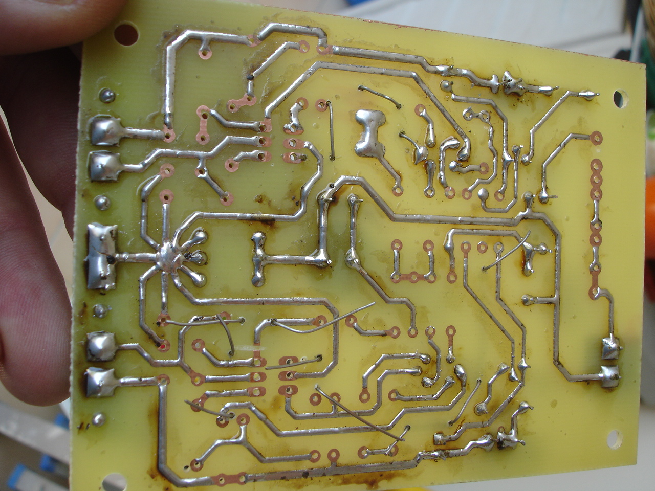

Small progress in symmetry.
I'm looking forward for best resistors values (R8,R9,R10,R11,R13,R14,R17,R18) FOR +/-50V power supply.
Is 47R a good choice ?
I haven't any trimmer smaller value than 500R for R6,R20.Are these ok?
This trimmers controls only the ccs or the offset simultaneously?
Besides stability , 47R will do for all the the re's (Q1-4 /7-10). Voltage
really don't matter on the "symetri' " (European type name 😛).
As long as you can get that 50R - 150R range out of those 500's , no
problem there.
Yes, you can affect offset and total VAS I by adjusting
the two CCS's (asymmetrically).
Make sure you fix the Q8 base trace error. R33 trace goes to Q8's
collector. I'll wait till you build it - I have the corrected layout to post
(and add to the first page).
