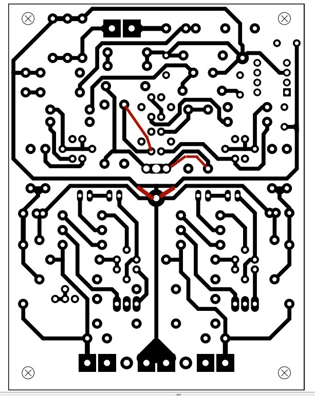

Here's the PDFs for my Kypton-ND layout.
  • Bottom.pdf
    Bottom.pdf
  • Top Mirrored.pdf
    Top Mirrored.pdf
  • Silk Mirrored.pdf
    Silk Mirrored.pdf

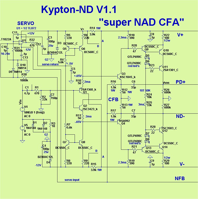

Just two things - bottom layer ground return .... all traces individually enter the star.
More serious , the full signal NFB traces . Keep as much clearance as possible
from other tracks until it enters the first pair of resistors.
After that , at the CFB node ... it is 1/27th full level.
One of these IPS's could nearly create household AC levels ! (creepage considerations).
ND is full rail or a 12v option to Q1/2 collectors. Not a
jumper across the zener dropping resistors. Q1 and 2 collector can connect
to either "side" of R14 or 15. There could be confusion here.
all else looks good , double check the screens (backward stuff 😛😀).

What ground traces should I merge before the enter they star?
I can swap some resistors to shorten the NFB traces
Those jumpers under R14 and R15 are voltage selector for Q1 and Q2. Three pin jumpers, bridge one pair or the other.
1 -What ground traces should I merge before the enter the star?
2 -I can swap some resistors to shorten the NFB traces
3 -Those jumpers under R14 and R15 are voltage selector for Q1 and Q2. Three pin jumpers, bridge one pair or the other.
#1 - shown (below)
#2 - just try to get as many mm (clearance) between any full current/full AC voltage NFB trace and any other. The drawn suggestion is just that ....
This is more critical on a CFA , many ma current at high signal levels.
#3 is good.
Edit - shortest path .. I see that "substar" for the input/servo - route that to the main star without going all the way
around the edge of the PCB.
OS

Jeff , you see the prototype below. Main G2 star with the servo/input star connecting
with one trace.
R12/13 ground returns for the current feedback are quite short. Current pulses
from the feedback and the 12V decoupling fully cancel at the G2 pad.
This makes a good place for the ground of C2/C5/R2 to connect.
Any similar scheme will be OK.

I had the input and servo on one ground trace, and servo decoupling cap grounds on another trace. They were the two ground traces that merged just above the star ground so it could all enter at the center between C3 and C4.
I'd like to swap R12 & 16, R13 & R17 to shorten the traces but there's no room to squeeze a ground through. This is a reworked Kypton-C board. I'm really remembering why I switched to Diptrace. I think I should make some time to create Slew style components for Diptrace after the Pitchfork boards are completed. The default components aren't very nice to rework and the artwork isn't as good but it's much easier to look at for long periods of time while designing.

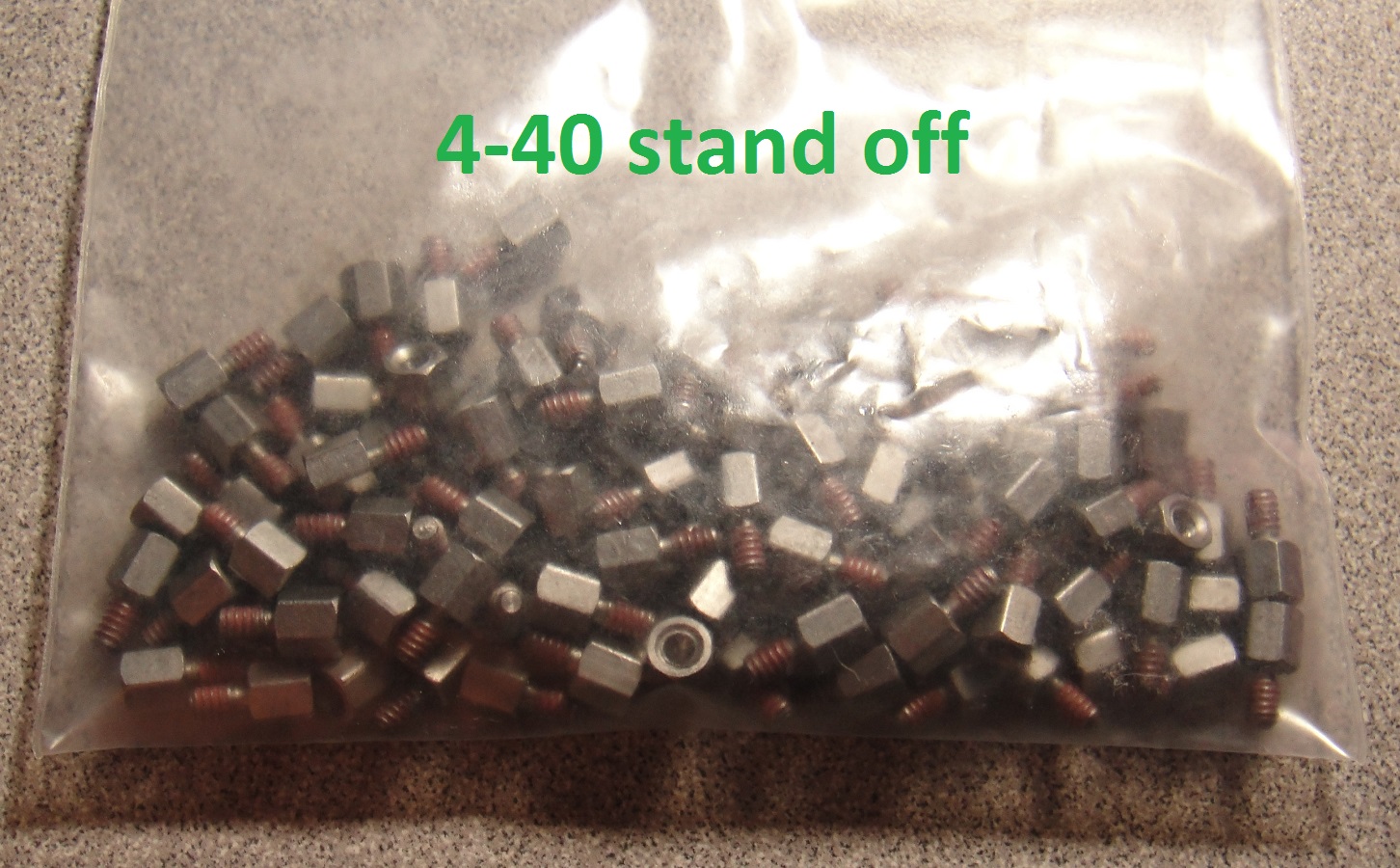

Hello guys sorry that this question is not about slewmaster subject is about a tool, what size tool tapping wrench do I need for 4-40 tap ?
I purchase a bunch of 4-40 stand off stainless steel and I want to begin doing tapping stuff for some projects that I have "in boxes" 😛
Regards
Juan

4-40 for aluminium you need a drill N° 43 (0.0890"), for steel use N° 41 (0.0960").
You can use your google search any time just ask for "tap drills"
Antonio

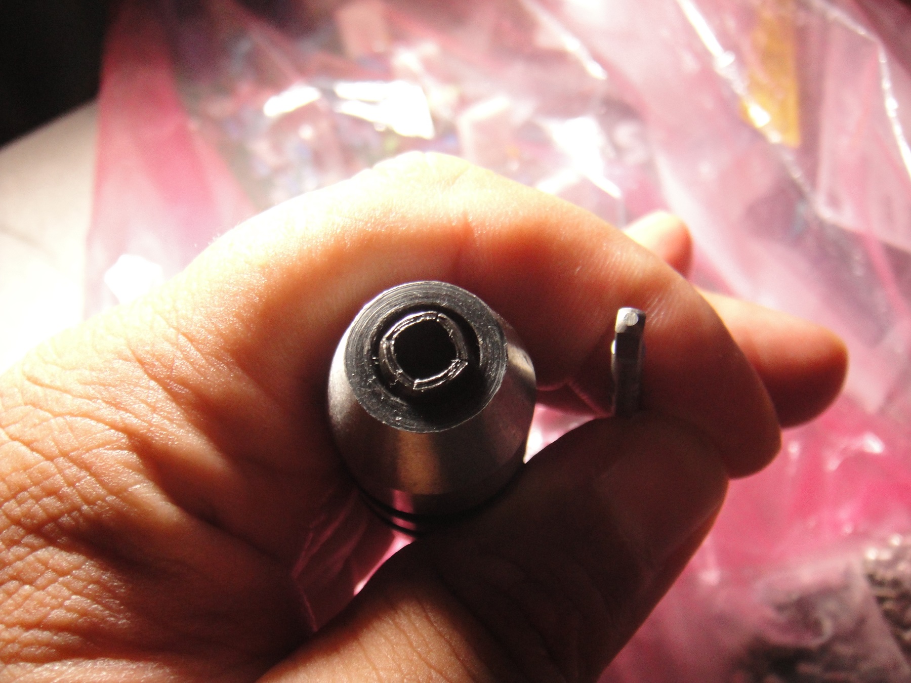

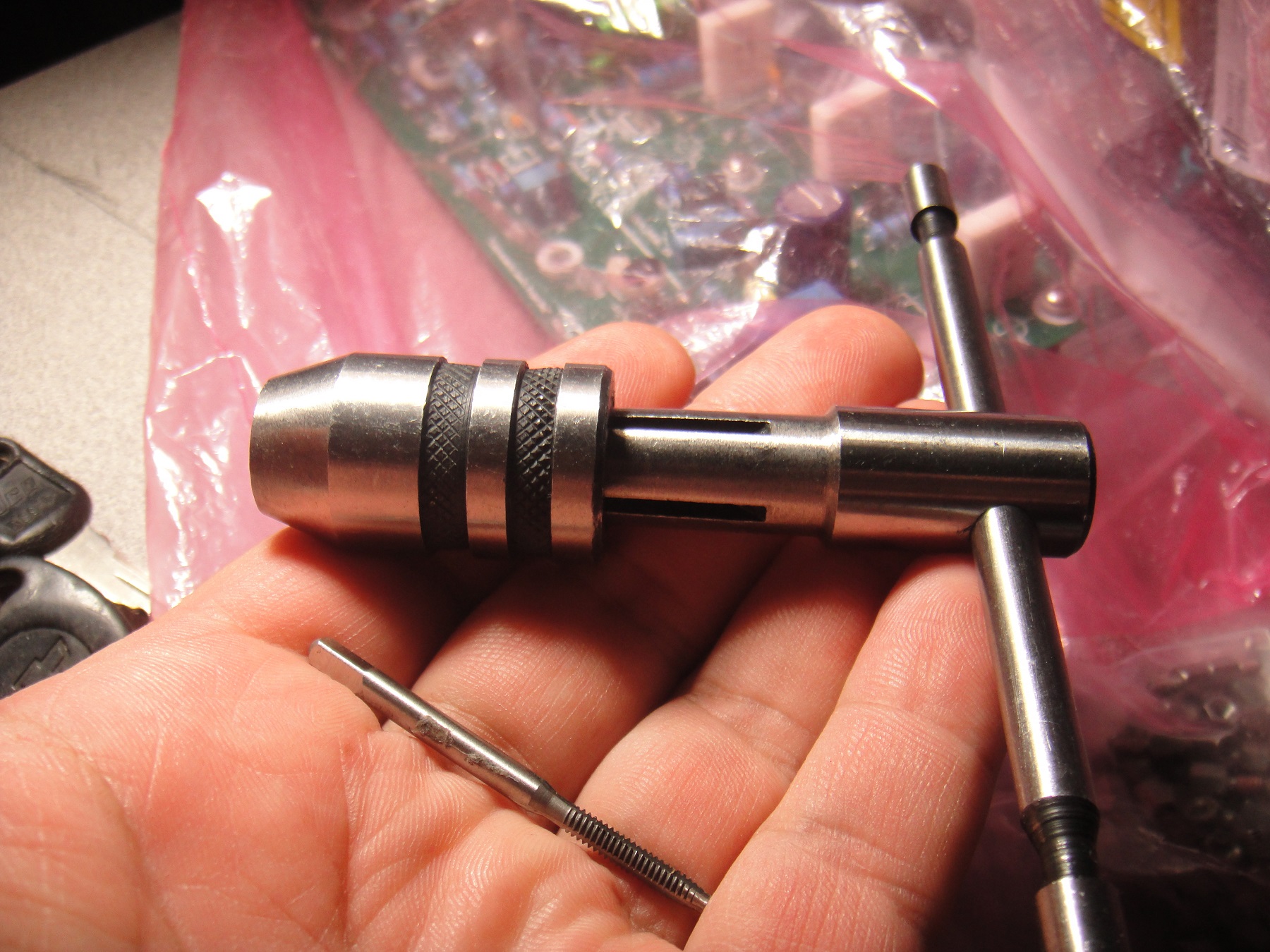

oh yeah that does help a lot too, but I just need to know what size tool I need to hold the 4-40 tap I have the wrong size tool 🙂 is ok I love tools but I need the correct one I don't want it to try out and then break the tap, I read those things are like glass fragile
Regards
Juan
