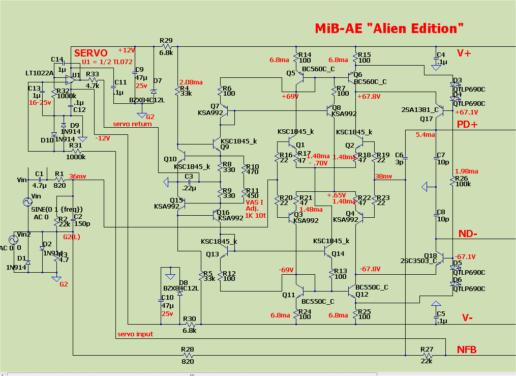

Further tweaks ....
AE was "a little light on the back-end" (Riddick) - LF THD was a bit higher than it (could be).
(below) , changed the VAS to a "folded/mirrored hawksford" ... WOW , now I
have that <10ppm at the earths frequency (schumann res.@ 7.8hz).
Local FB through the red led's linearized the LF in a major way. Current mirrors
now need to carry the red led's current , too. But they are low voltage , I'll have to
calculate wattage for them
Would not want alien to be bested by earthly tech. Servo caps = 2.2u for good
8hz thd . 20hz is 3ppm - very good.

ND= the best CFA ... by far. Thermally cancels , clamps on clip , DC servo goodness ,
and real low distortion.
The new "AE" nearly seems to be it's VFA equivalent - does the same things.
Performance (totally different design), nearly mirrors the ND in every way.
Strange ?? I suppose they are both symmetric designs .....

My new "AE" also has these attributes (in simulation). I suppose I'll have
to plug in a couple ND's to really see if the correlation between specs and
SQ pan out.
