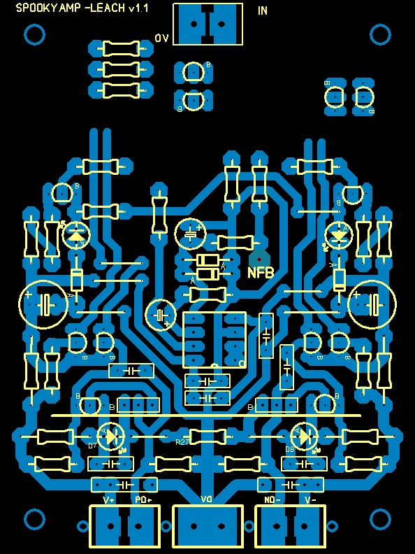

( I have to look up many devices- lead spacing/size info for layout).
OS
I am stressed ...
Now I know why I never designed a VFA symmetrical leach type amp.
It's like laying out two CFA's !! Multiple rail crossovers , "dripping"
with devices.
But I'll get it 😱 .
(Below)... down to the only the LTP's . WOW !
I know why the HK990 leach- like front end was all SMD and why
the Leach V4.5 was on a 5" X 5" pcb (125 X 125mm).
OS

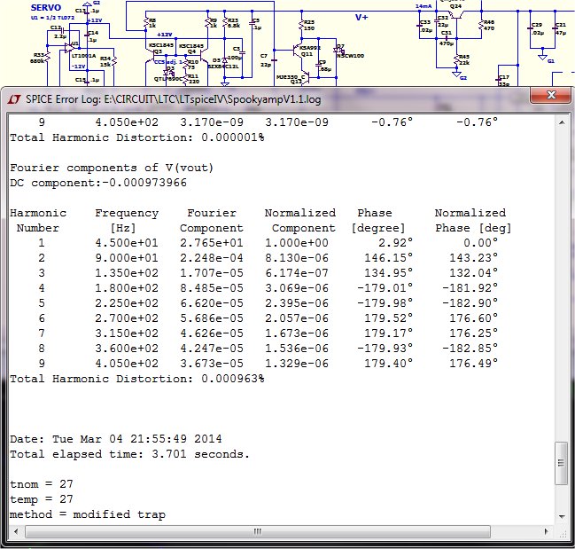

Tuned the "spooky" servo ... LF champ !!
.9mv offset and 9ppm from 10HZ to 60 HZ. NO other IPS does this good
in the LF range. Amps with a DC blocking cap "poop" right out under 50HZ
with a hefty rise in THD.
NOT the case here ... even (quite) better LF than the NAD-H.

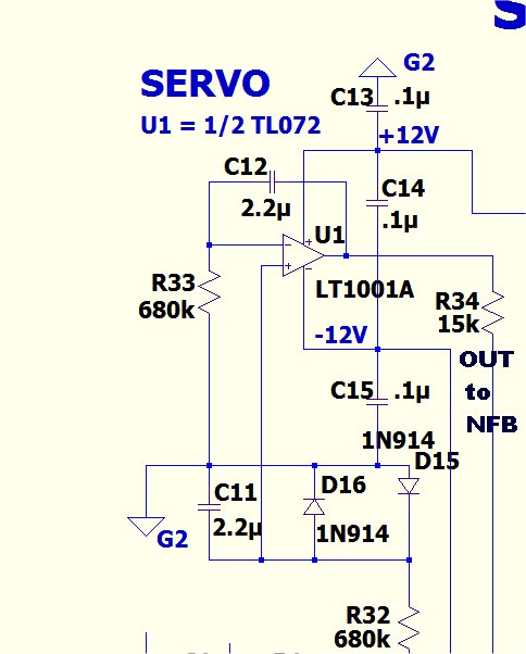

Has the schmo for the Spooky servo been posted?
I "stole" the HK990 servo ... 😱
They used a 1meg X2 /1uF X2 2 stage filter for their servo.
I went with 680K X 2 /2.2uF X2 to get my .1-.2 HZ LPF.
"Spooky" is different than the NAD-H , it "servo's" the NFB node AND
it's a VFA. VERY accurate .. 🙂 (below)
