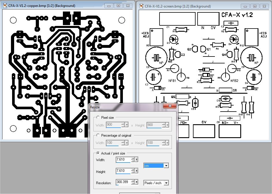

stupid question. What program should I open up the layout to ensure that it is properly sized. I printed both the output boards and the CFA-x boards and the proportions seem to be different.
If you only populated three of the output pairs where would be the ideal placement, near the end of the circuit or the beginning? I was thinking if you spaced them and skipped over every other position you would have a better heat distribution on the heatsink.
Buzz - I use PSP 7/8 ... both are .bmp (7.61cm sq. - below).
No difference.

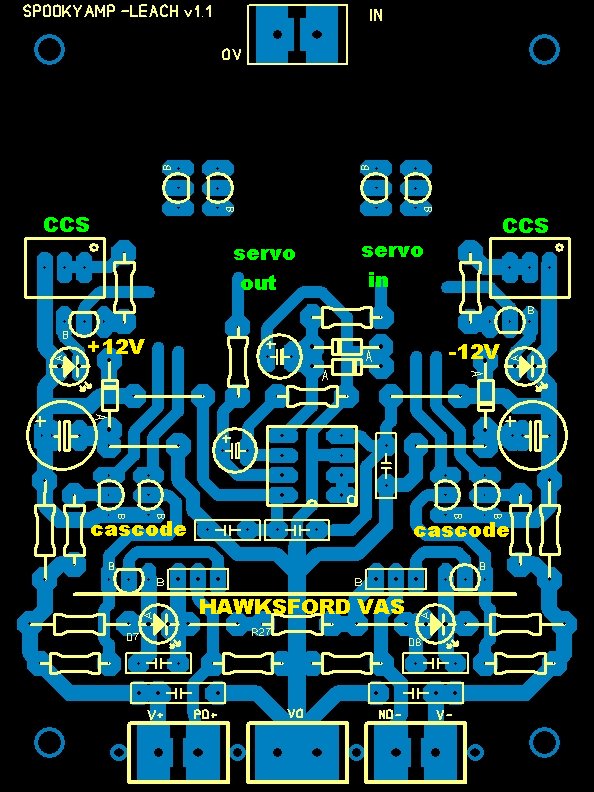

Spookyamp (leach 2) progress ...
I like to take a bite of " meat" ... 80 component IPS's are the
coolest ... (below).
I added what the Leach should have - (CCS's/Servo/hawksford).
Left out what it should not (VI limiter). Whaaaat ! But it'll blow ??
Nope ... after the IPS's - one BA protection module will be designed.
(Sir Bonsai's SS relay + Japanese integrated protection IC. 😎)

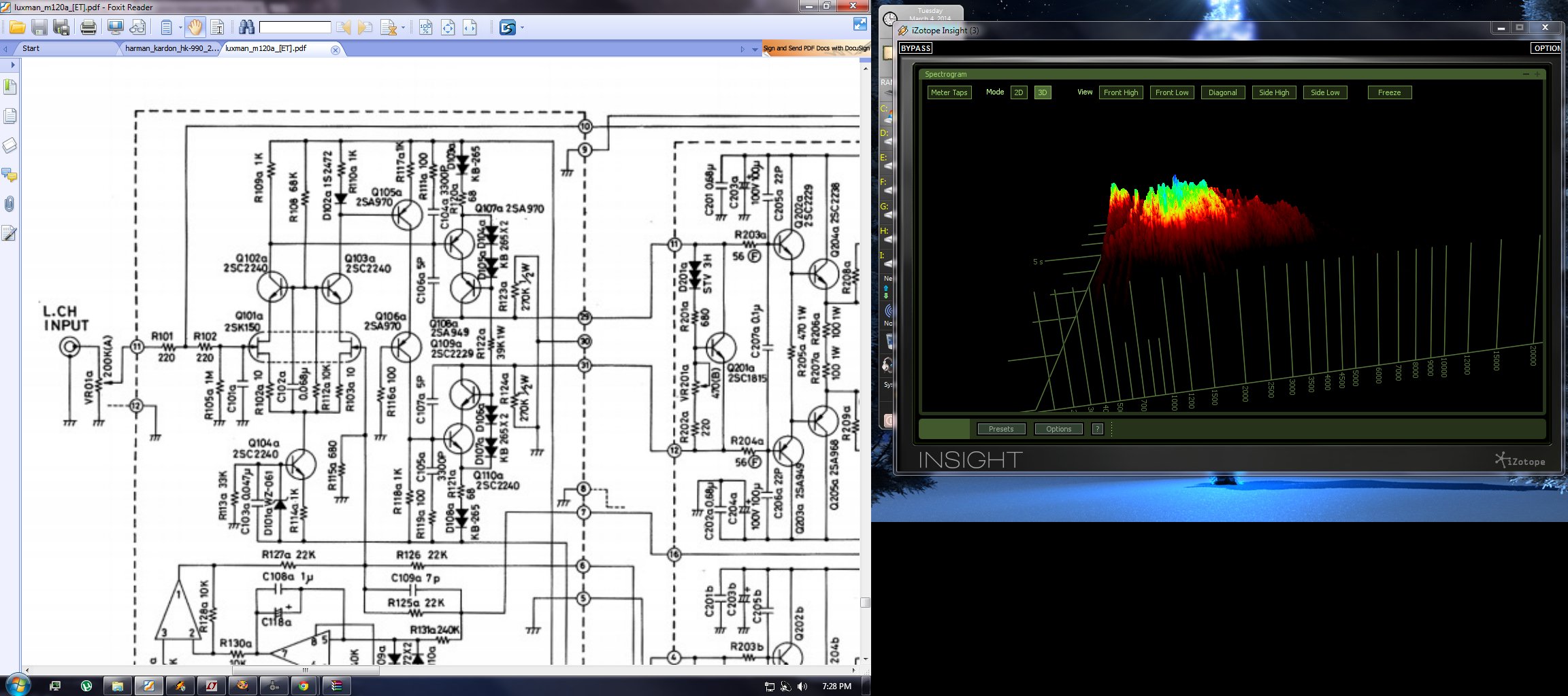

PS - I don't like being subjective , BUT .... I have built the Hawksford and it IS
the best sounding VAS ... we REALLY actually listen to the VAS ( OPS just increases current 50-100K).
The Hawksford is more than "airy" .. more like breathtaking...
The first amp I heard with a Hawksford was an old luxman (below) ... these hawksford's are based on it.
