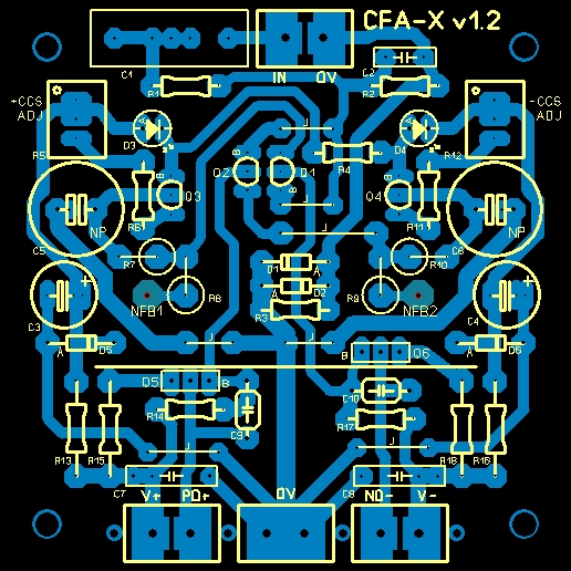

Can't figure why I made errors on the simple CFA-X 😕 .
Looked back to the VFA "wolverine" (paranoid 😱) no errors with a much
more involved layout.
The last "fixed" CFA-X I posted will work ..... but , it has to be "pretty".
(quick fix).
(Below) is the real purdey' CFA-X .
The reason I have reversed devices at the VAS (Q5/6) is so non-plastic
TO-126's will have the metal facing the heatsink and to preserve
the layout's symmetry (short paths from Q1/2 to Q5/6).
This amp is different with it's DUAL current feedback paths. "Float" the
main ground point with a resistor/inductor and those feedback pulses
"sour the milk" for the CCS/input pair. THD and stability suffer (amp
won't run with NO compensation anymore 🙁 ).
So .... separate, equal distance ground returns are the only option for
the CCS's and feedback returns (C5/R7-8 + C6/R9/10). Cancellation
will happen here .....The very "fat" trace and Lifted R3/D1-2 will ensure
none of this badness reaches the input filter/Q1-2 bases.
The same concept applies to output stage decoupling returns
or NFB take-off points .
A Simple circuit can have many more layout considerations than a
"bloated" one (wolverine). 😀
Again , many thanks to Mr. NICONOV !!
OS

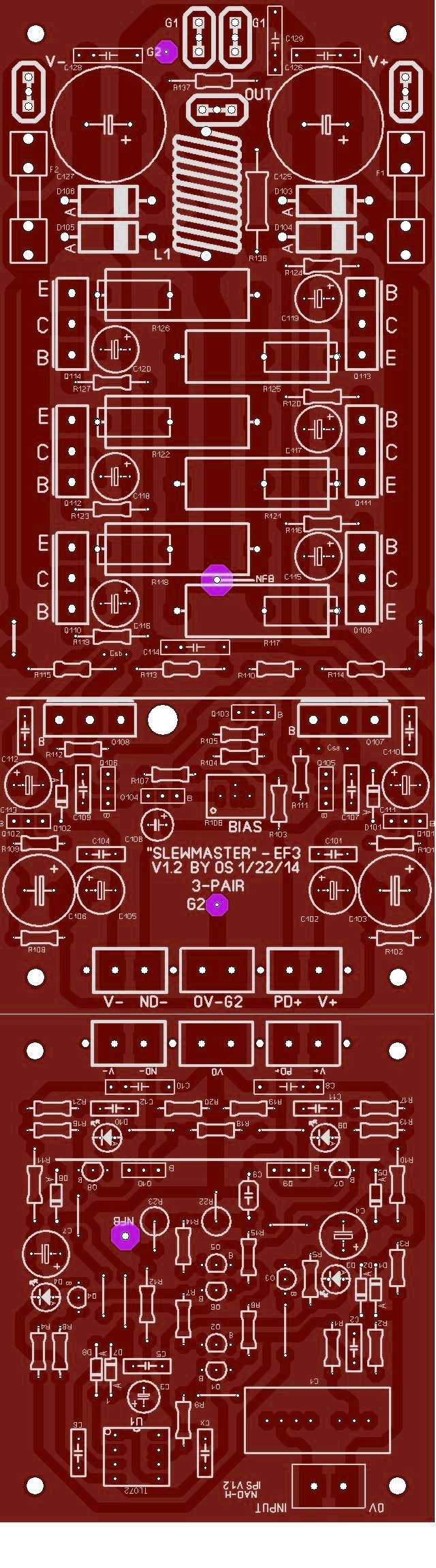

This would even fit in a shallower case ... 8" (200mm) heatsink ...
IPS PCB is at a 90 degree angle to the OPS. This modular design has NONE
of the drawbacks. Distance from VAS to predrivers is short.
With the "floating NFB" and the "anal" layout ... these modules might
shame most of the other designs here on DIYA.
You could switch "CFA-X" with "NAD-H" without even a bias re-adjustment.
THAT's how standardized this is !! ALL IPS's are fully compatible with
ALL OPS's - 35v- 85 V power supplies,too. Ultimate options for E-waste PS's
and junkbox parts ... that how these are designed. 🙂
OS
So by putting the input section at 90 degrees to the output you are shortening rhe feedback wire, is that what I am understanding here? The feedback is still an externally routed wire from output to input? The is nothing on the input board that needs to be mounted to the heat-sink then or would it have some independent heat sinks mounted on any of the input transistors? How would you suggest to mount the ips section, on an angled bracket or sub aluminum plate attached to the main heat sink on an angle?
The input board could just be mounted with 2 standoff's at the rear
panel of the amp. Your input jack could be right next to it (a few CM's).
You can just use 25mm wire wrap terminals for the IPS interface
(no euroterminal) and tighten the OPS screws ... or untighten to
change the IPS.
A very shallow E-waste amp case (200-225mm) would be usable for the
Even the (9" 225mm) "monster" OPS. It could be used with a heatsink USA
250mm X 125mm extrusion.
IPS VAS devices have a small 75 X 25mm thin aluminum heatsink (I use
roof flashing - cut with scissors )...that's it (low current - COOL !)
OS

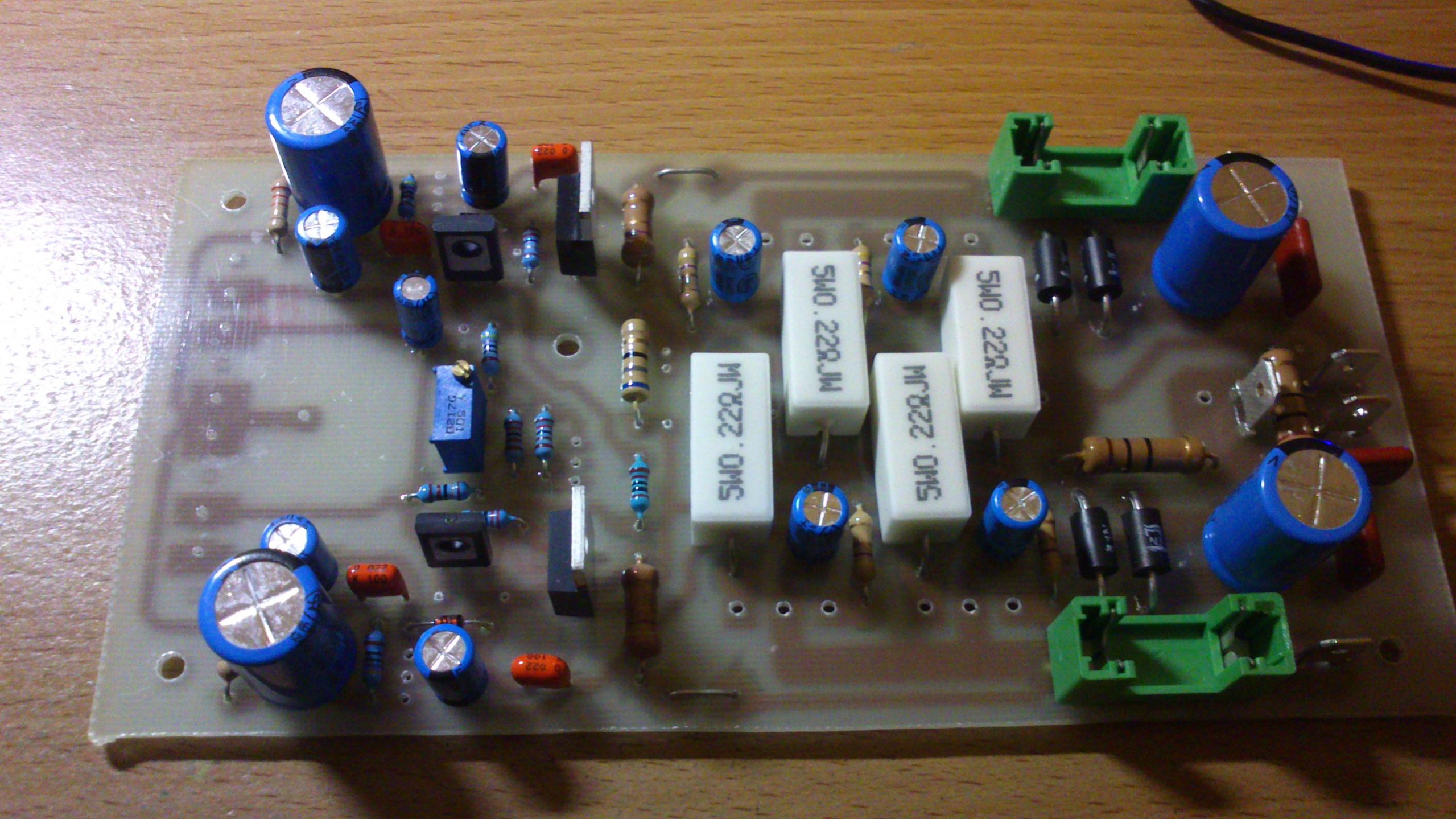

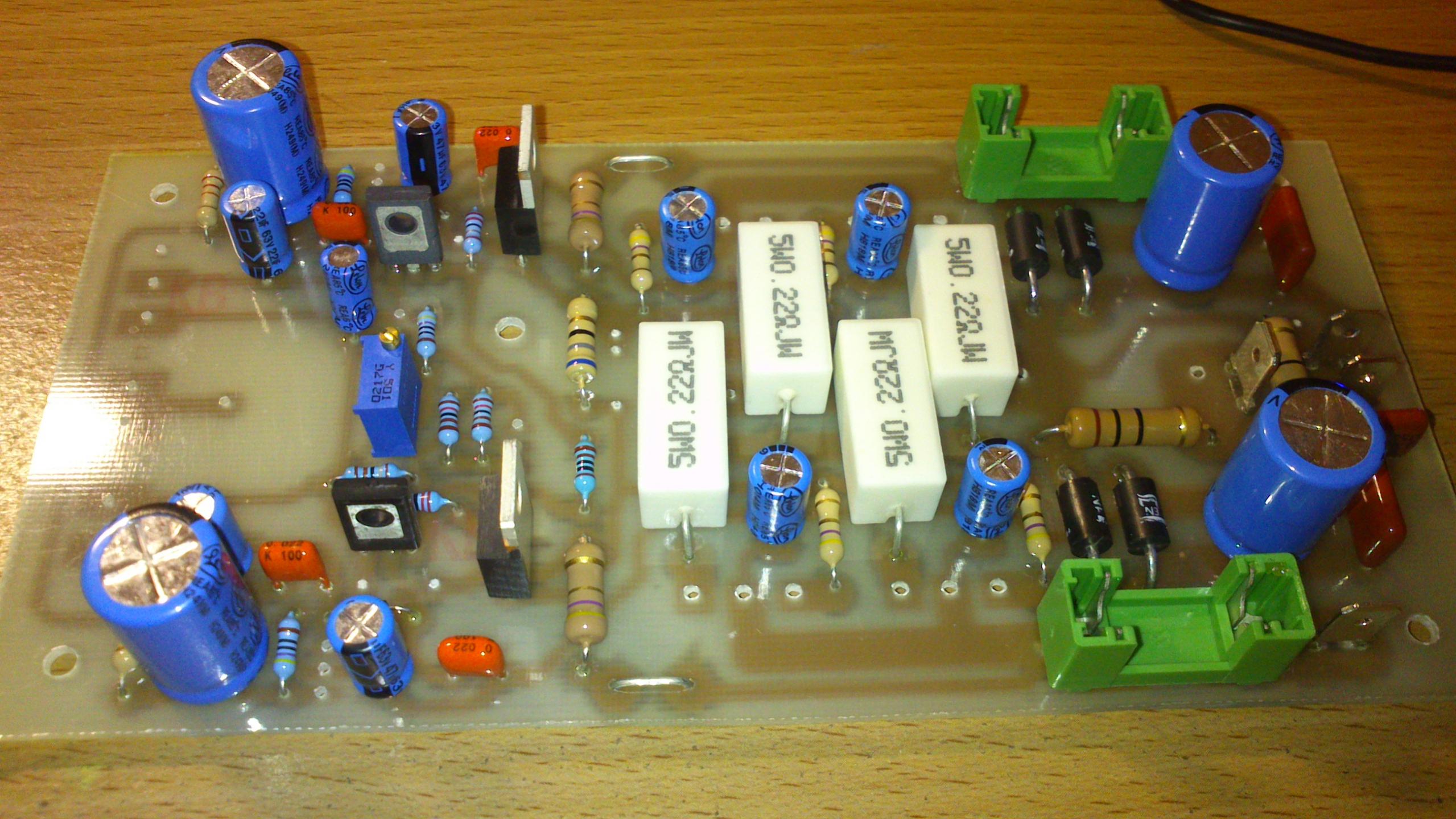

This is my progress so far.I have some questions. :
1)I have a pair of mjl21193-4 made by ON and a pair of mjl21193-4 made by Motorola.Can i mix/use them in the same channel?
2) Is 1mm wire enough for output coil?
3)I want to build a simple CFA topology . Which is the latest version of CFA-X input stage?
4)For C114 which curently is 0.68uF,I only have 0.47uF.Can i use it?

-At .22 OP Re and 4.7R as basestoppers , the two dissimilar OP's might work ...This is my progress so far.I have some questions. :

Check right at the OP device emitters for (mV) when operational to ensure proper
current sharing.
-1mm OP inductor is good for the "baby" .
-0.47uF is fine for the "suckout" cap .... it
"pulls" the voltage back out of the capacitive OP junctions during switching.
BTW - nice ! precision drilling ... 63V caps ? 45-50v rails ?
