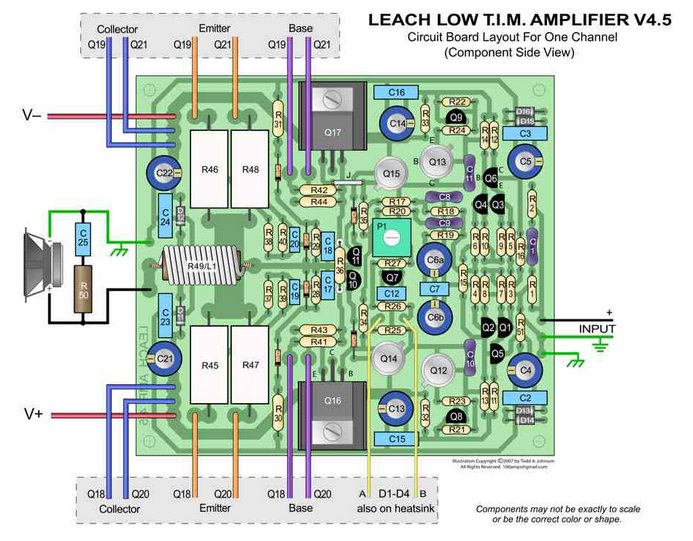

"Project spooky" (leach)
The reason for "Spooky" is this thread ...
http://www.diyaudio.com/forums/solid-state/245032-work-progress-leach-based-amplifier.html
Looking at the "eye candy" put me on to actually designing one for
this series. The original leach article was one of my first reads from the
internet back in the 20'th century 😀 .
Leach Amp Plans - Part 1
I have "digested both the original and the "double barreled" versions. The good
Professor was very generous with such a design. 🙂
In my version , I will attempt to preserve the "sound".
1. Leach used feedback from the predriver stage for global HF feedback. I
will also allow the option of a feedback path from a slewmaster pre-driver
stage to the NFB node. The main OPS will feed the servo as is conventional.
Of course , a unified feedback path will also be available.
2. I used the hawksford .... but it just "smokes" leach's VAS , about 1/6
the full amplitude THD with this "upgrade".
3. CCS's - leach used basic zener/resistive loading for his LTP(s).
The led CCS + buffer 1K resistor I use should also have the effect of
less thermal drift / better PSSR (confirmed)
4. Faster devices , unavoidable ... 30 mhz ft drivers/OP's are standard today.
One could use the MJL21193/4 to return to the "classic speed" 🙄 .
Below I begin , having studied Leach's original layout .... I'm on the right track.
PS - Leach's split NFB scheme - 200ppm 120v p-p ... unified NFB = 41ppm - same output level 20K ...
OS

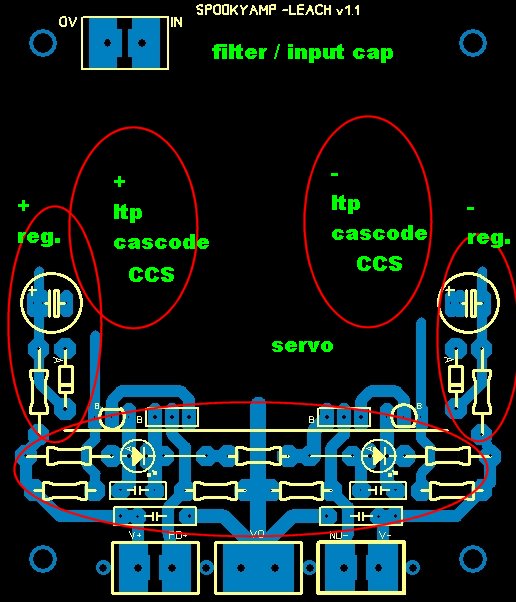

CFA-X artwork
76.2 X 76.2mm IPS (CFA-X /VSSA) ..
EDIT - ALL OPS/IPS package info is in the first post (post # = project).
I worked around the deficiency.
OS
OS

Please forgive me.
In the board POST # 666 and POST # 684 in my opinion are inaccurate.
R14 and R17 are not attached to power rails as in Scheme
Please forgive me.
No , I COMMEND you ... 😱😱😱😱 That would be a serious error.
I have now corrected this /.... do NOT build CFA-x post 666/684.
the new corrected one is below.....
Thank you , friend !! 😎
OS

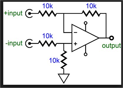

Os,
It is only a request, but a bridged version is what I would like to build. If it's not your things, it's cool, but my system is balanced and I would like to keep it that way. If there is a jumper board that I can use to connect two SE versions, I can get started on them, but you seem to be a stickler on layout.
With a simple OP-amp buffer , balanced to unbalanced could be done.
That is one way (below 1).
The better way is just to power 2 amps with a buffered balanced input.
They will be bridged at this point.
Example - 2 baby slews with MJL21193/4 , running at 40V rails bridged
would be 200+ w /8R. You would need a 40 CM long heat sink.
I would not layout a bridged setup unless someone tried and tested it first.
(with separate amps)...
Never built one 😱 .
OS
