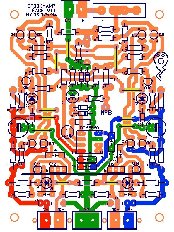

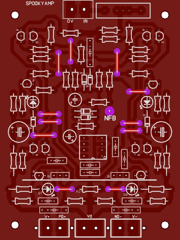

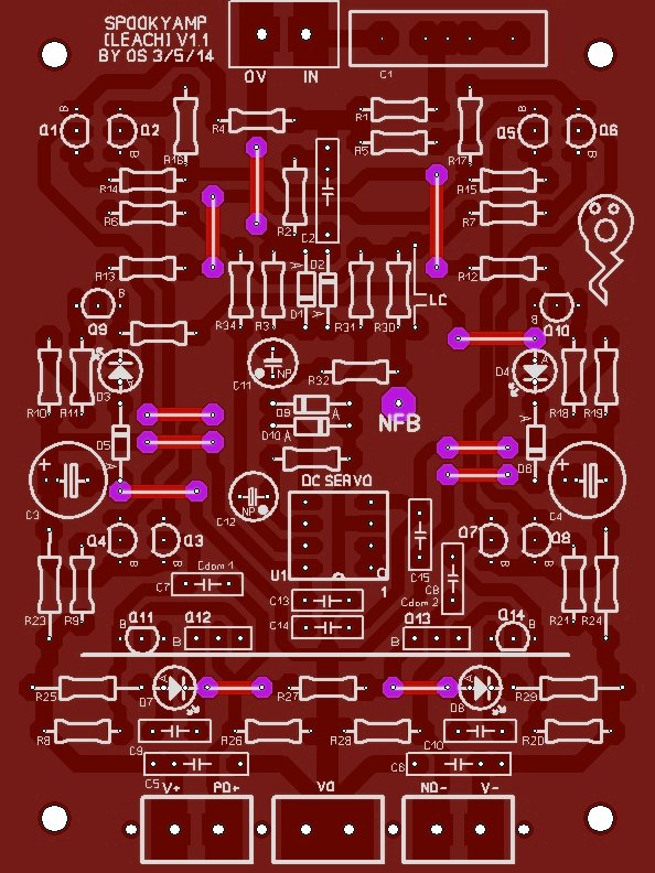

I'm preparing to iron the "Spooky" IPS when it ready.. ayeeeeee!
Spooky has finished the "hairpulling" layout stage ......😱😱😱 .
What a PITA !!! 🙁
Should of known what I was getting into when I added a Servo ,
2 CCS's , and a Hawksford cascode to a basic Leach ....
It looks good ... (below) NFB is isolated ... a little extra room for
an alien or ghost graphic. REALLY have to check it out (errors !)
11 jumpers , 50 passives , 25 semi's , and one evil chip. whoa !
OS

PS - I'm labeling the "spooky" Leach now ... The Leach topology is VERY
popular with hobbyists . (wait til' they get a load of this one... JOKER) 😀
OS

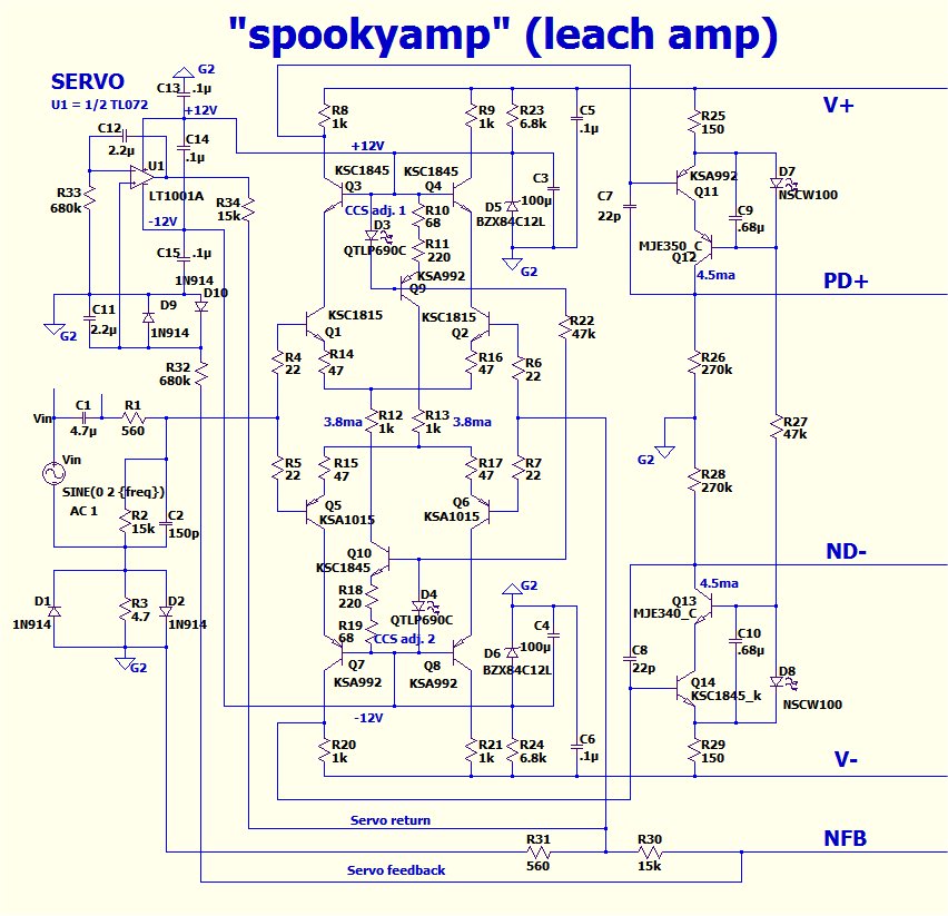

The 21'st century "Leach" is done. It should smoke the HK990 , as
the 990 has NO cap multipiers (better psrr here). The HK DOES have 2Q
CCS's ... so we might be pretty close to this 2500$ amp.
Below is the finished (red version) ... and the rails colored (red/blue/ green )
...standard V+/V-/0V colors.
I posted the schema that I derived this "monstrosity" from ...as the (middle)
attachment.
.ASC is also posted ... this thing "smokes" 😱 .
PS - R10/19 are the "fine tune" for CCS/ IP currents , use 33-82R here...
(saves space and 6$ for trimmers) cheep ...
OS
