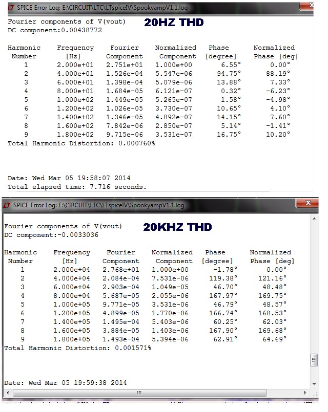

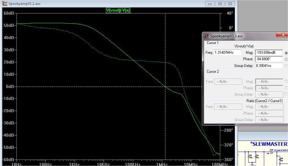

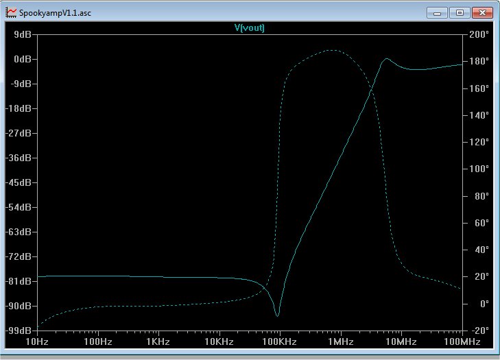

I submit ... the "spooky" ....
I never understood why this topology has many fans ... now I know.
ALL this fuss about CFA superiority .... could it be just a case of
symmetry ?
First of all , this is a lowly VFA amp ..... not enough slew , but high
PSRR. So why do I get 200V/uS here ? Back to symmetry. The loop gain
plot is nearly identical to the CFA's (below 1) ... why ? As is a very high
gain margin at 20Khz , also like the CFA. 1.25mhz UG point , too .
PSRR is between a "blameless" and a CFA ... more like the current sourced
VSSA , but flatter (lower)- way down into LF ... (below 2).
Distortion is second only to the "blameless" (more like a VFA here - below 3).
I suspect this is why harmon/Kardon chose this as their top-of-the- line
receiver amp topology - this amp seems to combine the best traits of
both CFA AND VFA 😱 .
(below 3) at a 3R load at 2/3 power , it "smokes" all the other amps
, especially from 10HZ ! to 25K (7-15ppm) .. 🙂
PS - Professor leach added lead compensation to NFB to allow more
UG margin at a higher frequency ... use 2.7- 3.9p at the "LC" pads
on PCB ... Be sure to look over the package real well - print it out ...
Compare to schema ... (It's a 1.1 version) 😀
ENJOY !

I think " . include slewmaster.txt and .include DIYAamp.txt are included
in the comments.The .ASC should try to reference either of them.
I should just add the models right on the asc.
