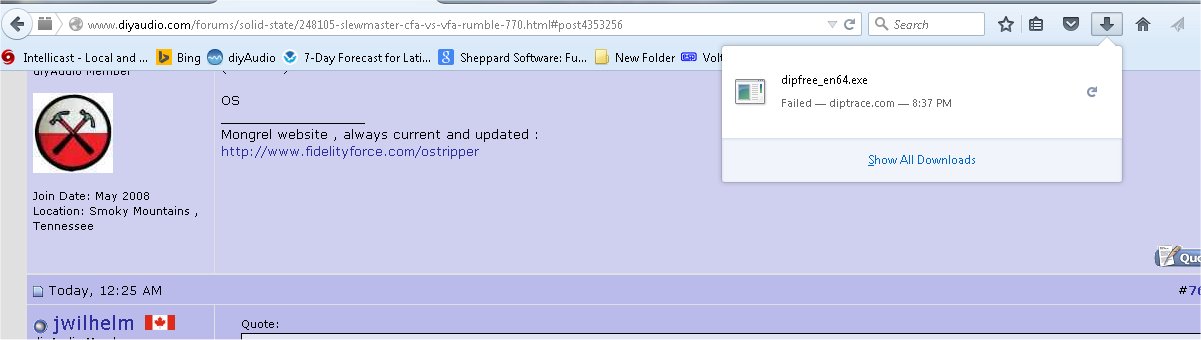

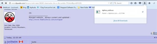

Nope , unless you live in a 1'st world place , server times out. NO diptrace for me
(too slow). Bummer.

Diptrace ? Is it worth the 2 hour download ? 300 pin limit now.

If you email them and tell them you are using it for Non-Profit use they will send you a free 500 pin licence. Valery told me they get a free 1000 pin licence in Russia. I just had to upgrade to that myself. $125 here but money well spent I think. I'll send you the install files with the next batch of parts.

Not to whine , but I pay my bills. 110$/mo. Same in albany 60$ .... download
would fail there , too - DSL. Cable at 3am , this PC rocks (30mbs) - not available 🙁 - even the cable would bomb out at 5pm to dsl speeds.
This is a common US thing. It's shameful what my EU counterparts have for standard IPS quality. One more lost hour (before failure).
Dang , I really wanted to try it !
