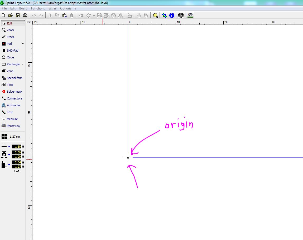

Also the 0,0 orientation shows the data is in the wrong quadrant, since the "y" dimension data is all neg numbers relative to the datum point.

you guys think it might be the origin has to be place right into one of the corners of the PCB to have correct X,Y coordinates ?
when I open a new project and decide to add PCB size outline always I notice that "origin" is in one of the corners of the PCB outlines
