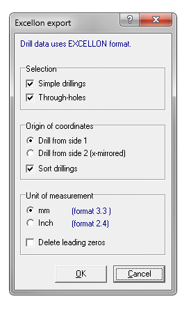

Since you know .... 😀 , how about the excellon standards (example below).
Do I have the right defaults ?
Thanks..
OS
Thanks..
OS
Looks good. I've never had any issues using inch dimensions either.
JW is right, the 'extra' drill files just separate Plated Through Holes and Non-Plated Through Holes. I only output those in case the board house has a preference or specific requirement. I also specified all dimensions in imperial (I always tied to work exclusively on a 0.050" grid) including the drills.
Sprint's defaults are fine, don't jack with the settings unless you know specifically you need something otherwise.
A reminder too, the specified size for a PTH is after plating. The board house will slightly up-size the drill so the finished hole is as specified. You, the designer, don't have to make allowances for that.

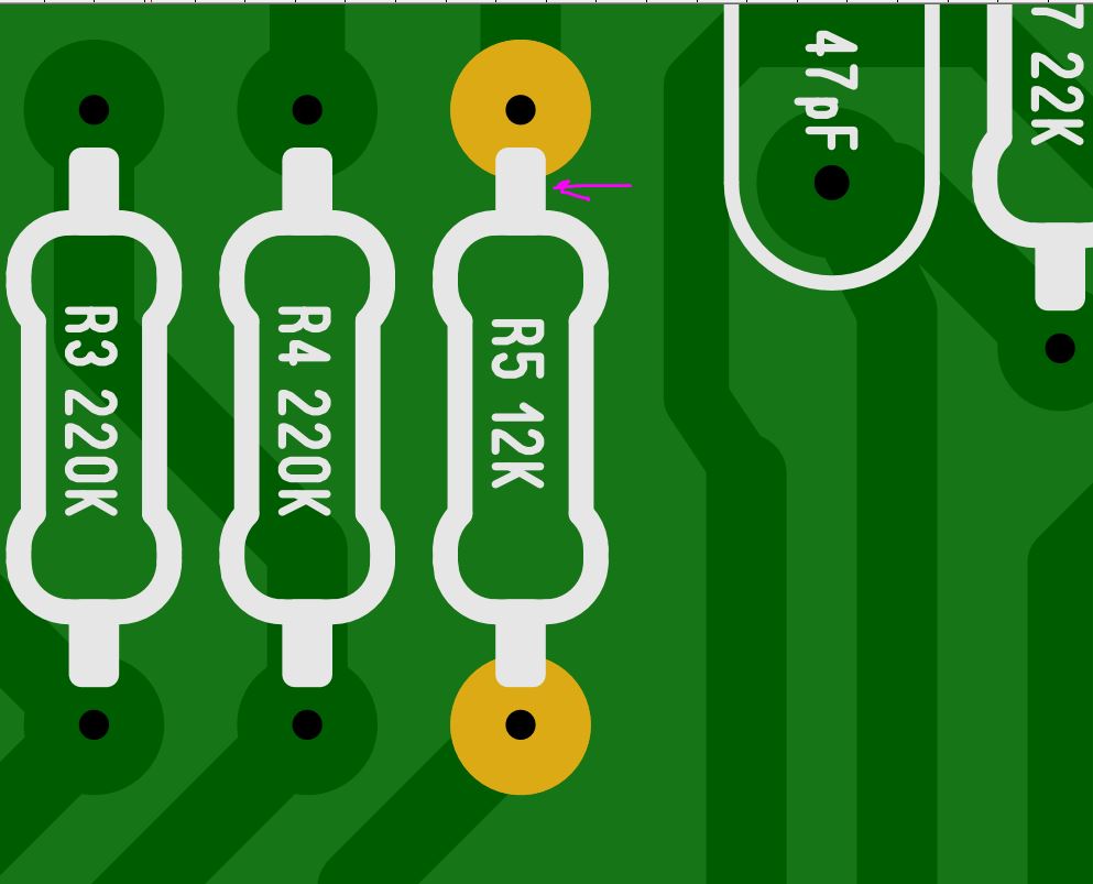

I could not use those. There are silkscreen on pad errors ...
Through-hole double sided will show this as an error as it conflicts with the soldermask.
Edit - when you make them , test F12 (or not) , run your macro template through a DRC check.
Make a macro universal 1 or 2 sided by default.

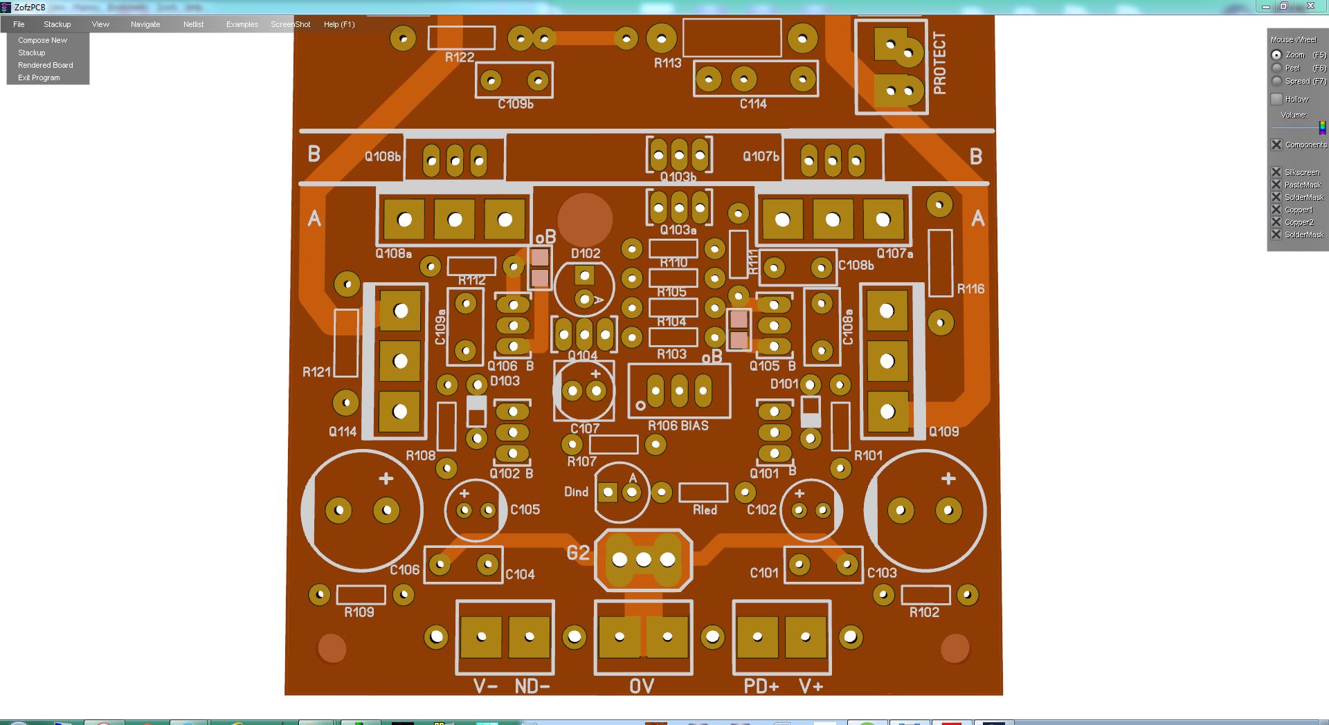

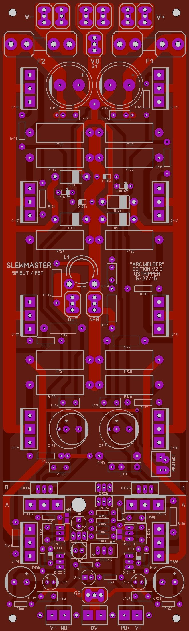

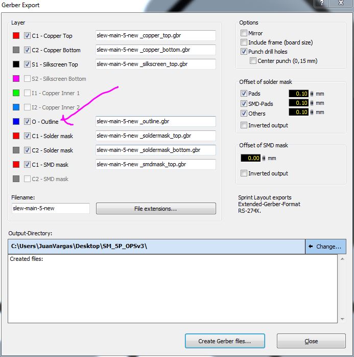

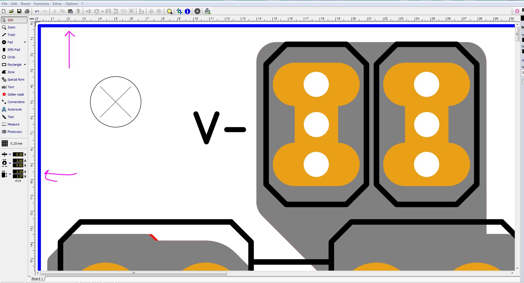

Here they are Evan (chinese pirates😀) .....
Is there any 3rd party gerber/drill viewer that can confirm the work ?
I also included the sprint .lay so one could get the free viewer to look or
edit.
OS

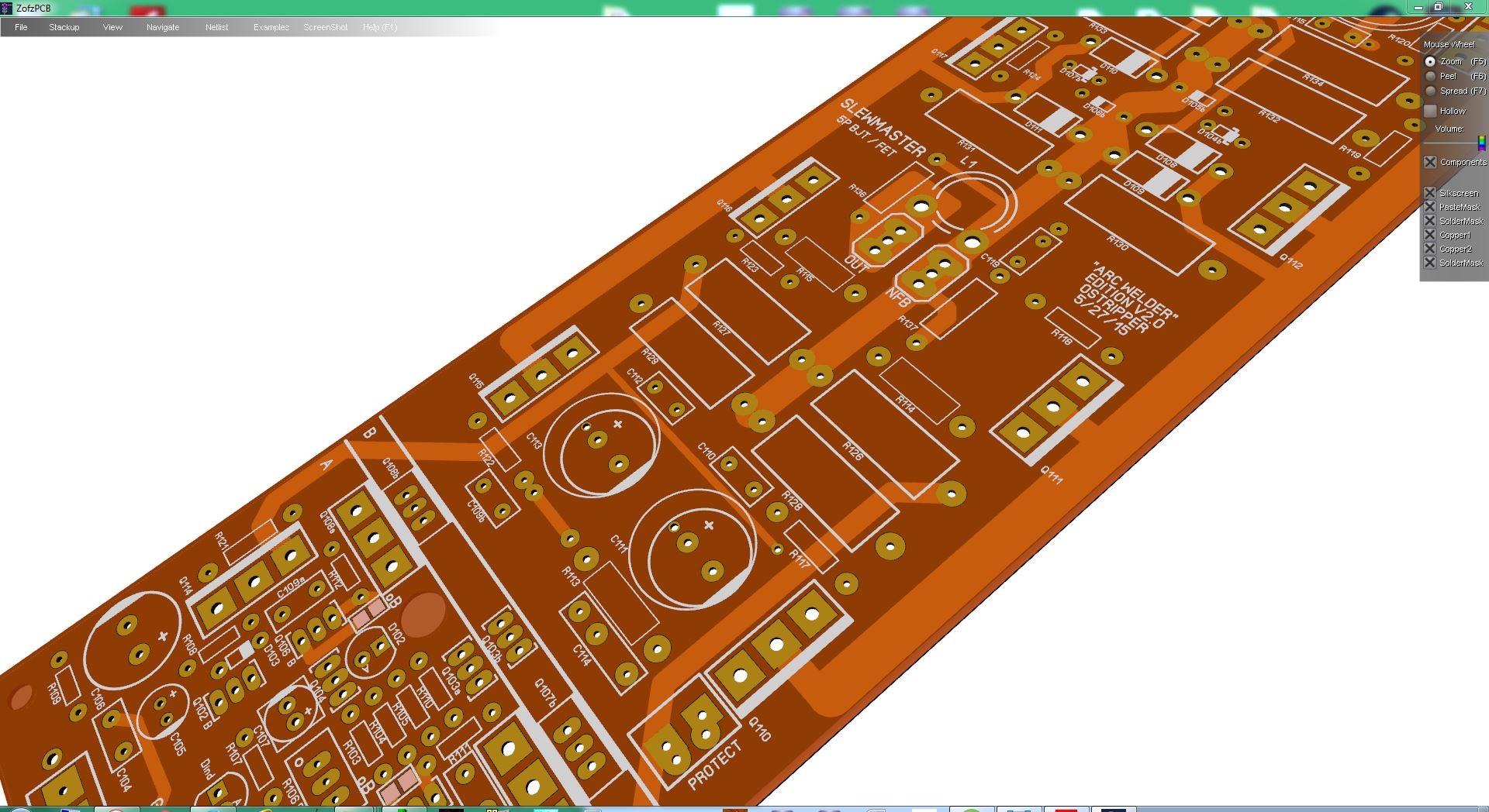

Yes mister OS there's a software that you can place gerbers and will actually see it in 3D also you can check LS = pitch distance too 🙂 check it out
ZofzPCB: FREE 3D Gerber Viewer
Regards
Juan
OS did you forgot to place outline ? 🙂
here is a sort like a preview of how it looks like, just got to play with software a little bit 😛
Regards
Juan
Regards
Juan
Abort launch !! Houston
I loaded your gerber drill into gerbtool. I see issues with your drill data, seems some/many parts are missing a proper drill size or the drill size is way too small.
I see, a partial list, of these comps having issues.
C16,18 ...
R132-135 ...
D104b,105b,D107b ...
Q101,102,107b ...
You should have been able to check these out before you generated the drill data, that is if your s/w is any good. Turn on only your drill layer and top pads to check. You should be able to see the drill diameter, the pad diameter(annual ring) and even the SM relative to the pad which i usually use 6 mil or 0.15mm over pad if using lpi sm which is pretty much std these days.
Also are you not able to generate a fab drawing and place a drill schedule which calls out drill sizes and matches them to a symbol that represents the drill hit location.
On the other issue with drills. if you want npth's you should send a separate drill file just for them and have notes in the drill schedule indicating as such. Some el cheapo pcb fab houses only do PTH as NPTH are a secondary op. that they wish to bypass so they can continue to be called el cheapo.
I will look further ...
oh boys I see lots of other problems too
SMD mask top should be merged with soldermask top, might be a setup in your gerb generator
have you actually fab'd anything with this s/w package before?
