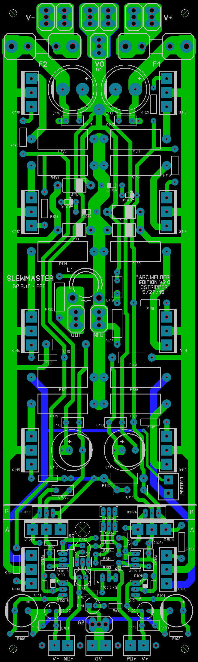

Final "Ultimate" slew output stage ....
Look over REAL good.
You , too .. Evan.
This took more time than the "old versions" .
I researched every "anal" consideration , right down to inductive X-coupling
and parasitic's.
We have ... close to the "hi-end" output stages. Should slightly outperform
1.x and 2.x , especially in the physical (thermal + power) realm.
PS - will post EVERYthing later - .lay + all gerber/excellon.
This one is also intended for 2 or 3 pair builds on a 250-300mm 3U or
greater heatsink. ALL from 100W -500W can use this PCB.
OS

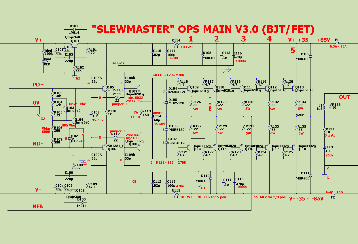

Looking good. What footprint for c116 / 118? Generous enough drilling for emitter resistors? Terry and others have often helped me with boards...I hope to be able to repay the favor. You rock.....as will this version.
E

layout + all gebers etc ... oh man this is amazing 🙂 prrrrrrrrrrr 😛
E
C116/118 are 7.5mm lead spacing , 16 or 18mm. 18mm can be 680-1kuf -100v.
Mouse/newark/ digikey have these 18 x 40mm goodies in stock.
The other 4 big caps are -
C111/113 .... the driver decoupling. Up to 470uF. lower your R's to 2.2R if
you wish , this is 10X+ the size of the V1/2 caps.
C103/106 .... multiplier caps ... still 12mm (100-220uF @ 100V). Here, you
can just increase multiplier semi beta to increase filtering. A darlington
might even work here , as well .Nearly infinite virtual capacitance 😀.
All else is the same stable V1/2 layout-design - except for VFET option
pads (the "B" 's).
OS

I am a bit behind you , indefixes. 😱 Very good looking - they should rock !
I sometimes do not trust my work , and triple check everything for certain standards.
Holes -
1mm -All the big electro's , and 5W resistors.
1.4mm - output devices.
1mm - to-220/126
1.6mm - big diodes
1mm - small diodes
.7mm - small resistors
1.8mm - fastons/keystone
2.5mm - for the inductor.
1.15mm - euroterms
Some may be a little big -
2 reasons - if you need to replace anything
Some OEM's have a bigger "max" spec ,
different OEMs sometimes stray from IEC specs.
Had euroterms in the "21'st century" that I had to thin out the pins to
fit the holes., If the hole is a little large , better than a little small 🙂 .
-this has to be 100%.
OS
