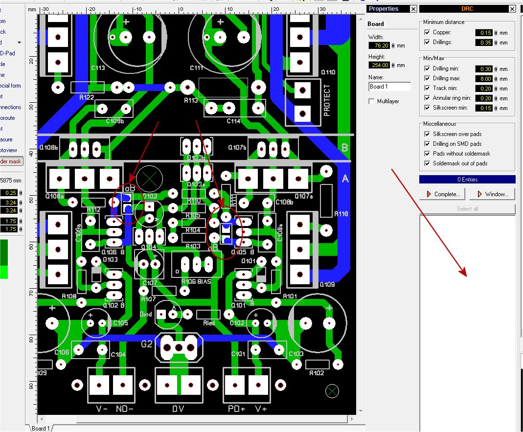

Before you do ANY of the exports, do use the DRC tool to ensure you have no issues like silk on pad, clearance problems, drillings too close etc. to help ensure the design will go through manufacture without issue.
No problem for 1-9. No problem with silk on pad .... I get "drilling too close"
on oblivious good pads (larger pads with larger holes) .... can't figure why ??

Post a snippet of the image showing the error. Remember a 'plain drilling' is done on the bottom copper layer with a pad where both values (pad diameter and drilling) need to be identical.
Thanks ...JK , I deduced the issue. A couple of my macros used over lapping
pads as components. I fixed the macro , warning goes away.

Strange (below-circled), SMD option pads do not overlay C1 tracks. Had to make
C1 tracks , as SMD pads will show a error if there is a through-hole on
them. Any workaround for this ?

Do you have the SMT pads set as through hole? I think in 6 they show up the same colour as traces.CAD is good. Especially when it can fix or identify screwups. 😀

Yes, there should be no drilling within an SMD pad. Where I needed an accessible option I simply made the traces from the SMD pad to the through hole device on the top copper layer, otherwise you could use a via to change layer. Or simply put the option on the bottom, as the builder should know wether he / she in invoking a given option while stuffing the board, no need to access it from the top really.
Sprint 6 can do the gerbers in one export and individual excellon exports, but in Sprint 5 it is a one-at-a-time deal. No biggie as you only do it once. For a board like this the prior list of layers is all anyone needs.
