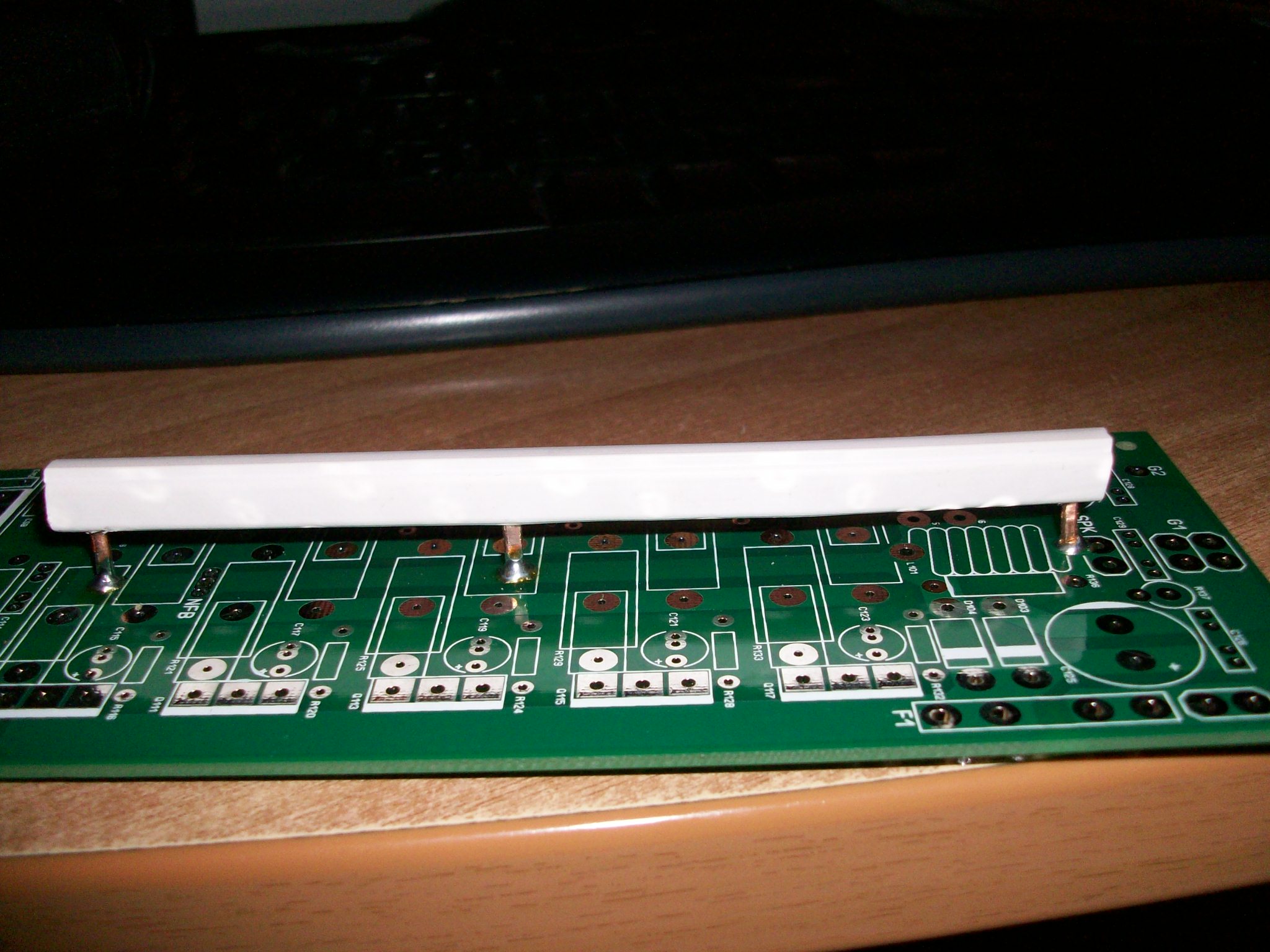

So after all OS advices i send UniSlewMaster gerber files to PCB manufacturer... So choice for output can be 3 pairs BJT (TO264/TO3P), 2 pairs BJT MT200 or 3 pairs VFET (TO247)
So is this board like OS's "Slew Baby" board, or does this board bring a lot of improvements to the table?
Thanks...
It's in the range of slewmaster (=>3 pairs OP slewbaby has 2) with ability to use VFET (hosting Valery modifications to Use Vfet : jumpzr to switch from EF3 to EF2, led in the Vbe multiplier, diode protection,....) The layout take care from OS advices : bigger main caps decoupling arrange in serie (no current return on track), vbe multiplier transistor near OPS, V rail on both side....

They are all the same , A modifed (harmon kardon) H/K680 triple emitter follower
output stage.
Read the reviews for the HK - Harman Kardon HK 680
That's what I did , I own one - I copied it. It's 20 years old , even.
Slew baby , V1/2 ..... if you use the toshiba 1837/4793 as drivers
and the Sankens - you even have an EXACT clone.
Other builders (and me) have used huge (output) drivers to "magnify"
this amp.
That's it , different power levels only (scalability).
OS
Hi OS ,is this the final version ?Yes , and ask your peers for evaluation/critic.
I even like it better with Jwilhelms advice added. Looked at more OPS's
and read some Slone. 😎
Now it looks "mean".
Has those Keystone "arc welder" hookups - and the molex for protection. NFB is right. A perfect star (G1).
All is below , I think it's 100%.
OS

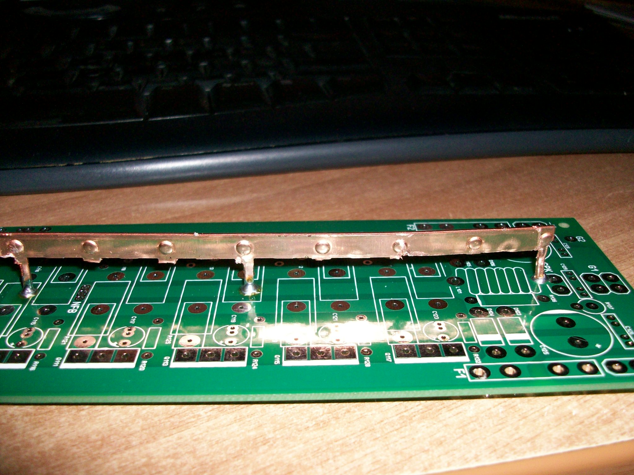

Hole For NJW or Sanken MT100 driver are in but i put TO220 hole for 1837/4793 too. I have some in stock. Could they match with 2 pair MT200 OP and +/-50Vdc rail for 4 Ohms use?
Marc

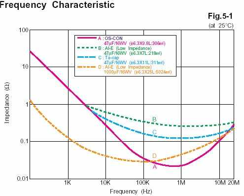

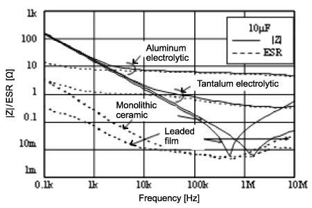

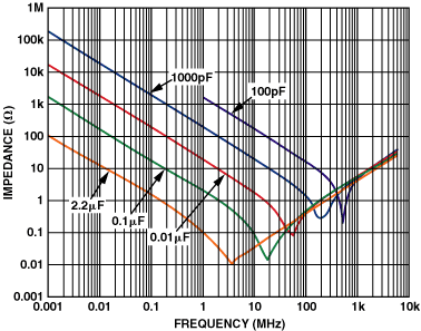

They basically just add capacitance to the main ones. There is a compromise
involved with them.
While they may smooth sharp current spikes at the collectors ,
having that returned down long traces to the G1 ground star is a long loop area.
PS - don't use under 1uf for the V1.x PCB's .... L + C can "ring" with the
small value.
On V1 , I also combined the driver decoupling return down these same traces.
The driver decoupling is an R/C , and is far less current. It's long loop area
(distance) is not as critical. V2 has JUST the driver decoupling returns (better).
I also weighed in similar layouts. Pass X250/350
Accuphase , even the "golden amp" ... just has the main decoupling.
Below 1 and 2 -
(Below 1) - is a 1000uf electro (gold line) ... matched with ( 2) , a quality film or
ceramic. Leaded monolithic ceramic seems to be best (below 3).
.02 -05uf gives the broadest range to combine with the electro's ESR.
In the end , the rails have milliohm level ESR between .01HZ and 100mhz.
Full decoupling from PS fluctuations to radio frequencies.
Short of a full regulated 10-20A supply 😀😀 , this is the best we can do.
Luckily, we have the cap multiplier and the IPS's PSRR working for us.
OS

Publish gerber / excellon files when the art is complete, then folks can order boards if they wish.
Just C1/2 and S1 gerber data and the excelon drill data ?
Edit - solder masks , as well ??
OS
I export at least the following into a 'for manufacture' package:
1) Outline
2) Top Copper
3) Bottom Copper
4) Top Solder Mask
5) Bottom Solder Mask
6) Top Silk Screen
7) Excellon with PTH only
8) Excellon with NPTH (plain drillings) only
9) and an Excellon file with all drillings together
Different vendors want different things in the drill file(s), so doing as above will give them the pick of what they need / want.
Before you do ANY of the exports, do use the DRC tool to ensure you have no issues like silk on pad, clearance problems, drillings too close etc. to help ensure the design will go through manufacture without issue.
