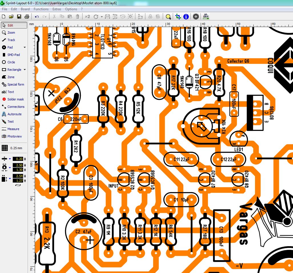

2.5mm - for the inductor. really close to 10AWG, oh ! I see the coil is gonna be winded double, I just look at layout L1 image 🙂
Ahhh , Vargas ... You actually posted the one I was reading.
All is now .8 / 1 / 1.6 / and 2.25mm (4 drillings).
14ga coil is almost 1.7mm , 2.25mm for it and the big diodes - easier rework.
No , coil is single layer 18-22 turns 16/14 ga. (1.4 -1.6uH). Sticks straight up !

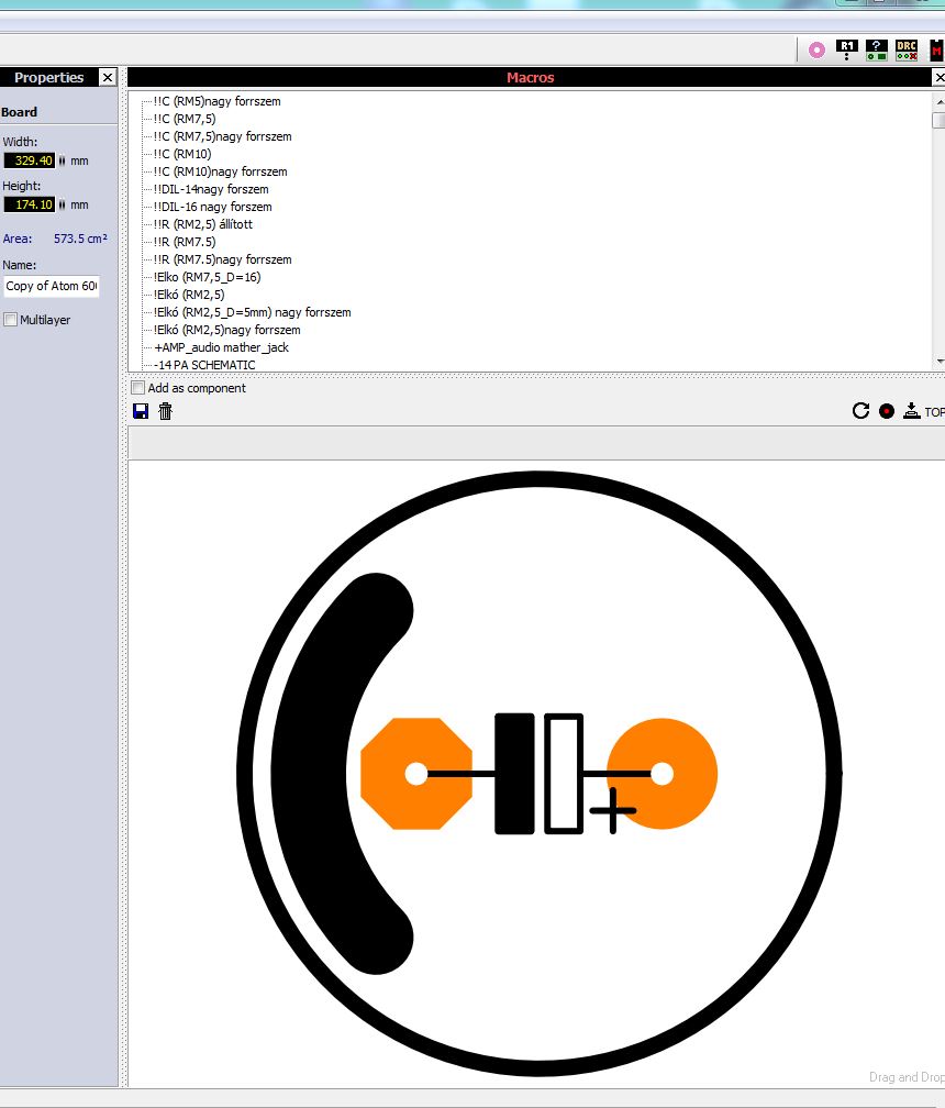

Hey I can make some fancy macros if you want 1/4W /1/2W resistors and fancy caps 3.5mm PD. 5.00 mm PD and 7.5 mm PD also other macros too, I do not mind at all sharing those 🙂
Regards
Juan
Regards
Juan
I could not use those. There are silkscreen on pad errors ...
Through-hole double sided will show this as an error as it conflicts with the soldermask.
Edit - when you make them , test F12 (or not) , run your macro template through a DRC check.
Make a macro universal 1 or 2 sided by default.
