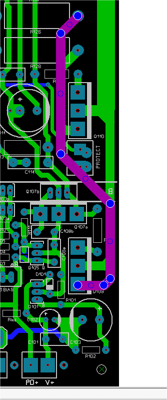

there is a trace on the bot side that could be a drc error as it does not run into the header pin centroid, it just runs by it, so it looks to be a trace/pad short!!That's multiple holes for different connector options.
Okay finished picking at it
Show it graphically.

the trace on the top going from q109 to r126, (2,5,7.5 area relative to bottom left)
(below) that one ?

Ok , I see. That trace does short to the header. It needs to .... either a 5mm euro
or JW's 4.2mm connector goes between that OP pairs emitters to feed the
protection overcurrent sensor.
That trace is on the bottom. You have the layers mixed up.
