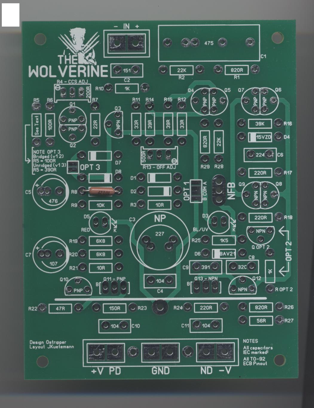

I wonder ,is it ok using RN55 1/8w resistors for Wolverine IPS and OPS except those different mentioned?
The working voltage for C7,C5 WHEN power supply is +/-50v?
What you prefer for C3,220uf NP ,or 470uf NP Muse?
yes , any watts ... only micro watts in most of the circuit. R23 is = 150R 4.5ma ,
120R- 5.2ma and 100R=6+ma VAS I. 🙂

So after the back and forth do we feel that the zip file is OK to send to the board house? I got the name of the supplier that jkuetemann used for the previous boards and am thinking they did a good job in the past so would expect the same again.

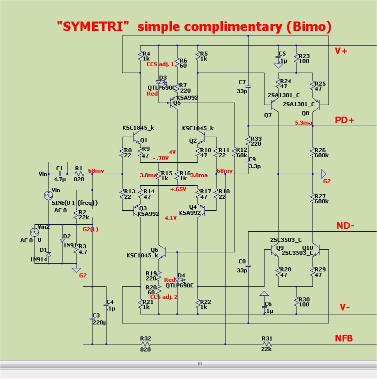

I'll be busy on symetri , any questions on the big OPS - please forward to me.

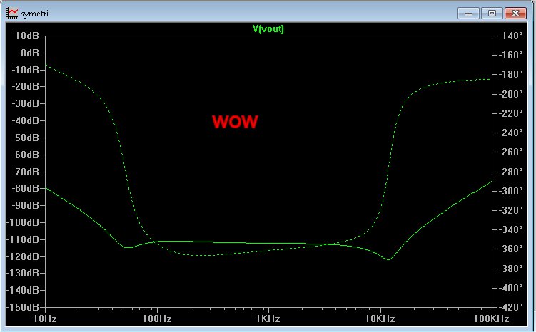

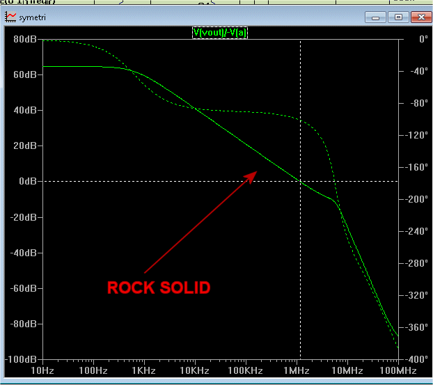

symetri is strange .....
weird how it works -
feedback correction is directly applied to the VAS.
The VAS is just an extended beta enhanced input pair.
So , you are not listening to the VAS - but directly to the input pair.
-Supply ripple is just about fully cancelled (below 1) - beats even the spook.
-Clipping is clamped fully like the Kypton's , and the gain and margins
will make for "rock solid" stability. (below 2)
Just 10 BJT's - by far the best simplicity to performance !
This might be the best subwoofer IPS out there !
PS - this thing works like a big "blowtorch" line stage that can
do 120V p-p ! Same physics in play - different from all the others (not cascoded).
Cancellation is a direct shunt instead of through a folded cascode (blowtorch).
OS
