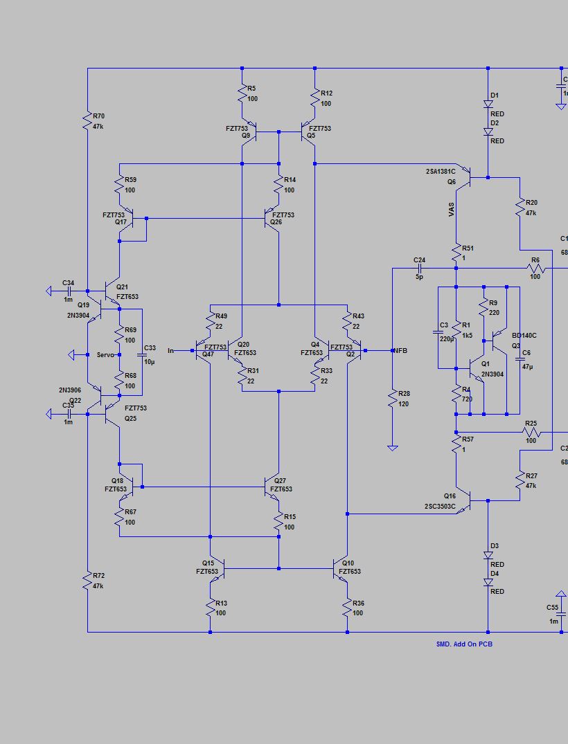

I would sat that feedback is applied to the backside of the symmetric Long-tail pairs in a fully traditional matter, the special part of the circuit is the VAS configuration, can be made even simpler and even better... 🙂
Yes , that is true. LTP (-) just shunts the "backside" of the VAS. Overload is
forcefully clamped ! As I said , this IPS could be overloaded continuously with
no stress.
LTP and VAS are "as one" in this design. Spook does NFB only in the LTP ,
VAS is controlled only be the (+) part of the tail.
OS
Is there something wrong with the way Q5 is drawn?
No , that is just the led reference "string" going through (and connecting) to Q5's base.
SUCH as simple circuit , but with real low THD (30ppm /20k/100v p-p).
Another difference -
120hz = .0011% , 60hz = .0007% and 20hz = .0002%
CFA's won't "bottom out" in the LF like this , spook tends to just stay at 20ppm
20-200hz.
Bottom line - this is a bass amp - for sure.
OS
This is an even simpler version. This is servo-ed, but could also be A/C coupled for those fancying that.
I really like that , but it is NOT simpler ?
OS
Oh yes,simpler, but in my version with current mirrors and advanced housekeeping the transistor count increases, it holds the same advantages as yours, but also a lot more... 🙂
Creative, simple and self balancing.

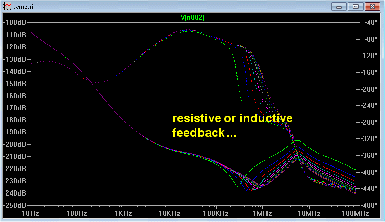

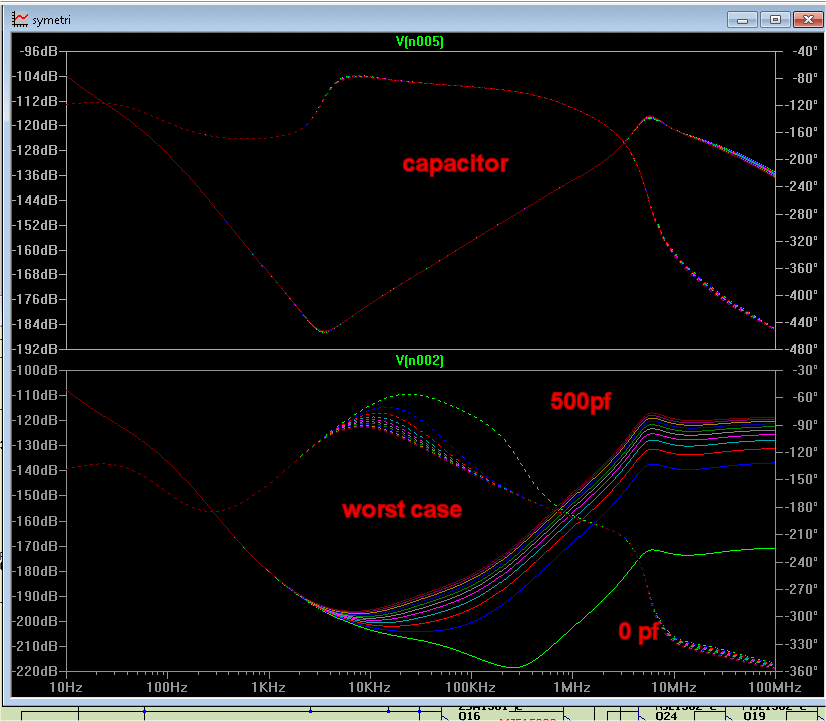

I did further thought on any effects having the first pair of outputs nestled in the
driver/ multiplier area ( below) might be.
I "magnified" any parasitic feedback , either capacitive or inductive.
(below 1 and 2) the worst case 500pf or a direct megaohm feedback
does nearly NOTHING to the multiplier outputs.
So , having the outputs here affect nothing ... even if you had a rosin flux
bridge or the tracks much closer. I doubt you would have even nano farad
capacitance at 4mm distance. Pushing a lot of current through these close outputs
also does not affect the multipliers with mutual inductance. You could even
lower the impedance of the multiplier dividers (if you were paranoid) 😀
EVERY thing is thought out for the PCB !
