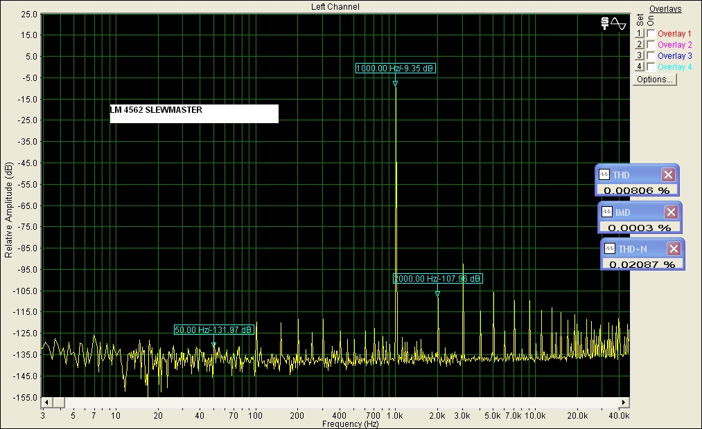

Today i manage to have another try to this IPS.
Installing an LM4562 instead of TL072 this IPS is more musical ,very good sounding!
Vas current must be modified ,it is double the recommendation OS ,please help.

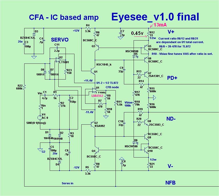

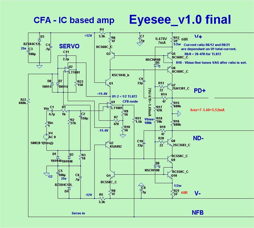

Increase R12 and 21 to 47-56R. Q3/5 -4/10 are current mirrors -
Ratio of those mirrors emitter resistors determines whether it is a
mirror (equal) , magnifier , or attenuator.
For example if R6 and 12 are 47R , 10ma that the IC draws will be
exactly copied on the main VAS emitter resistor (R12). But , the VAS
will have to share 2ma with the cascode LED string ... giving
8 ma leftover for the VASout.

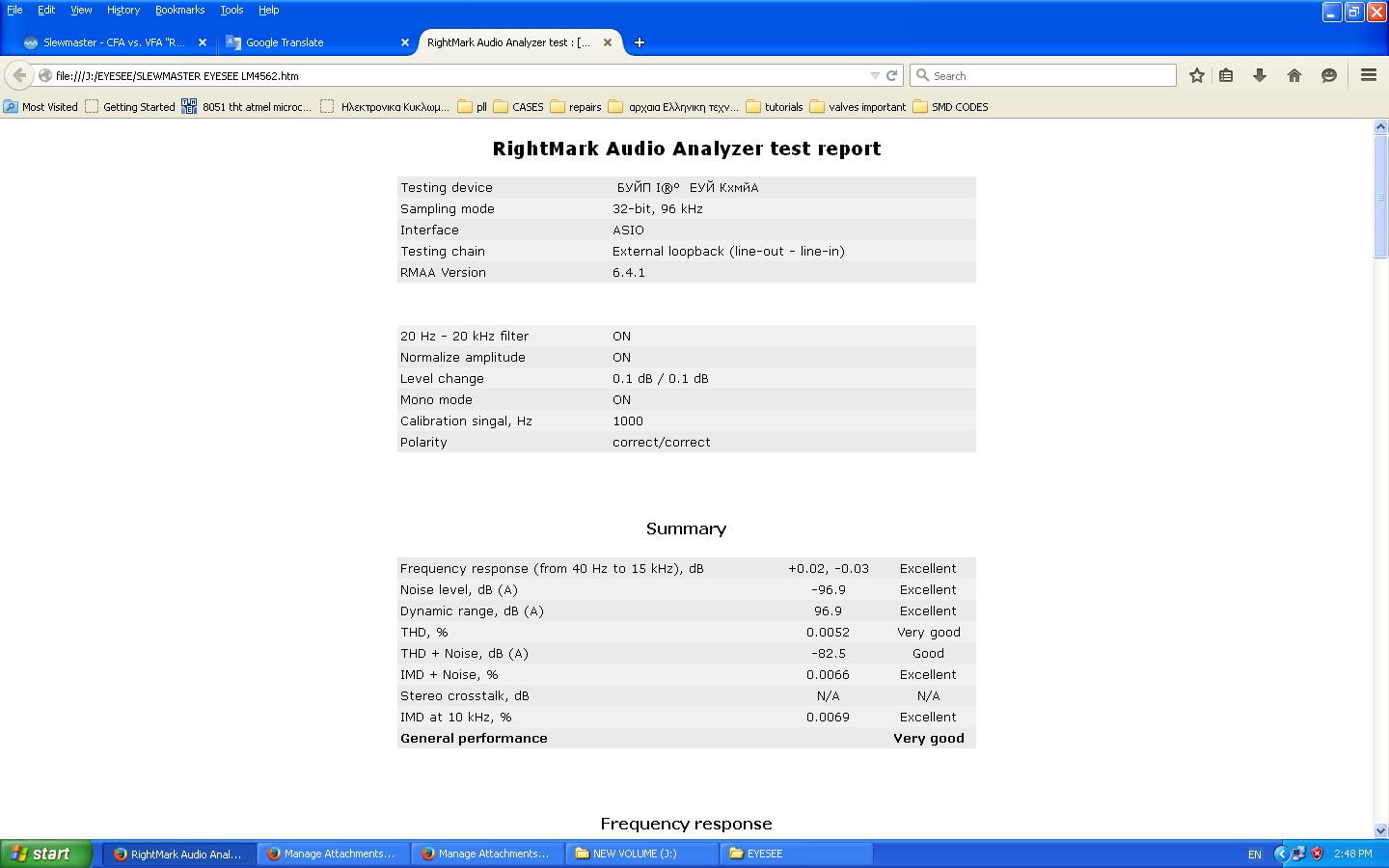

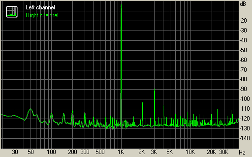

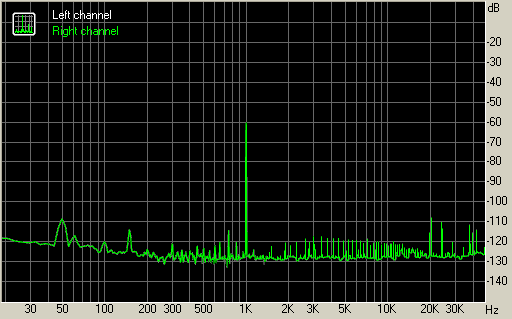

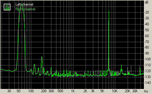

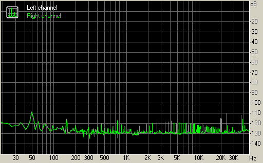

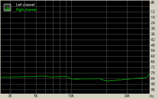

I think it's ok now🙄

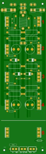

For all you board designers a question. Can you do one of these combination boards with both the input section and the output section and make it editable to adjust the number of output devices or do you have to redraw each time you make a change like that? Everything else being the same except for the number of outputs and the size of the board?
Yes like 1, 2,4 would be great

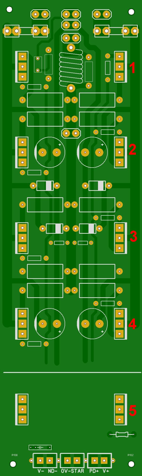

Jkeutmann Even made one with 6 outputs (pairs).
You can scale it up to 10 or more , just add emitter resistors , OP devices , and
basestoppers for each additional pair.
This is all "1st generation" art. Now that I am not sick and suffering 🙁 , time
to do the "better stuff".
(below) - a 5 pair. Just adding pairs at the close spacing of the original
slew output stages might be good for 2-3 pairs.
Bigger dissipation will need a 250-300mm 3U to 5U heatsink and every ounce
of aluminum matters here !!
With all 5 pairs spread across a 250mm PCB , each pair will have an equal area
of aluminum for dissipation. That is , each pair will see the same Celsius per watt and additionally would have the same thermal limits (failure , gain).
2 or 3 pairs on the attached layout would also be better thermally in positions
2/4 or 1/3/5.
PS - the previous slewmaster OPS is best using 3 pair , a 5 pair setup is
not ideal. Nothing will blow , but still not ideal.

OS,
I completely understand you concern with heat dissipation and spreading the output devices across the heatsink surface so you don't have devices to close together and causing localized high heat areas. I assume there is also the factor of the height and thickness of the fins on the heatsink and whether or not you use any kind of forced air cooling to help with the situation. I'll just use the 5 pairs boards I have to mount 3 pairs as you said. Whether I would ever need a 5 or 6 pair board is very questionable. I can usually design a set of speaker that with much less power would drive you out of the room before you could ever use that level of power. Now when I was doing PA and building bass horns that had dual 18" drivers that amount of power would be nice. Most of those amps were switch mode Class D type of power amps putting out over 1,000 watts per channel and banks of them. I'm not doing outdoor festivals so not needing to do that anymore. Still have molded parts to build 8 more bass horns, just not sure what I want to do with them.

Strange, I have 3 pair of the 5P OPS, one is VFET. None of them have exhibited any hint of a problem. I have run them for hours into 4 ohm speakers without problem. I do have them on pretty large heatsinks though. Maybe I just got lucky.
