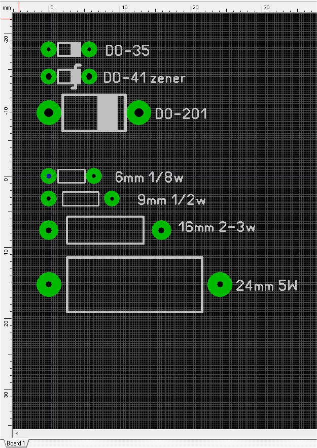

I like this way ,come on OS make a layout like this.🙂
I plan to even do better.
Have to make better component artwork . JK's style is the metric , some
additions (like a zener symbol -below) .....
Had to make all new art for my sprint 5 , sprint 6 was made to force an
upgrade with a few stupid added features.
Upgrade cycle on most software is a "racket" (ripoff). Sprint 6 also likes
to communicate , which I DO NOT like.
OS

I bought Sprint 6.0 about a month ago but it is harder to get my head wrapped around than I had hoped it would be. There aren't too many good video tutorials around so I have had slow progress trying to learn it. I am keeping at it though as I think it adds quite a lot to the hobby.
There's a bit of a learning curve to any Cad software. Usually after a couple weeks you start to hate it, then after that it becomes easy. The trick is to keep working with it.

Beats Red and Blue tape with Black dots for holes any day in my book. As with ANY program, ease comes from usage and dedication. Alex MM got there by Practice, Practice and then some Practice. He is the gold standard, but some others are coming on STRONG...

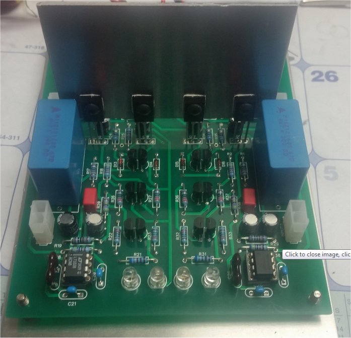

Ammel - this is the 50 -500W diy thread. 😀 Some of these input stages
could be used as a source for a line stage.
The "pitchfork" (below) .... link -
http://www.diyaudio.com/forums/analog-line-level/272915-pitchfork-pre-amplifier-6.html
...was originally simulated with a spooky. An IC was chosen because most
line stages are 12-24V powered.
The IC in class A actually beats many of the slewmaster input stages ,
with less gain and current involved.
All art is noted by post # in the first thread post or on my signature link .
OS

OK, the schematic and board images for the Krypton-C are at post 4729.
Since there are no Gerber or Sprint files in the zip folder, I have no idea how to make any boards from just the jpg. images.
Hopefully someone will have a couple of Krypton-C boards they're willing to part with.
