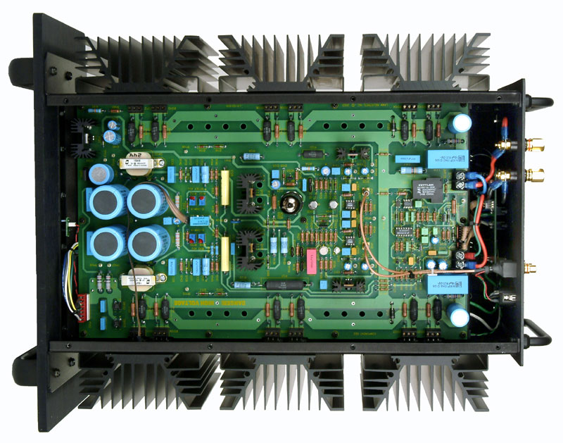

Well, in some cases of high-power reference designs, each output pair is mounted on the separate heatsink section.
This is Lamm M1.2. One channel. No compromise![]()
That looks like a LFET OPS. Here , you can do this (separate heatsinks) ..
negative thermal co-efficient. Unless they couple those heatsinks -
still I see NO Vbe and it is not ideal.

I like this way ,come on OS make a layout like this.That looks like a LFET OPS. Here , you can do this (separate heatsinks) ..
