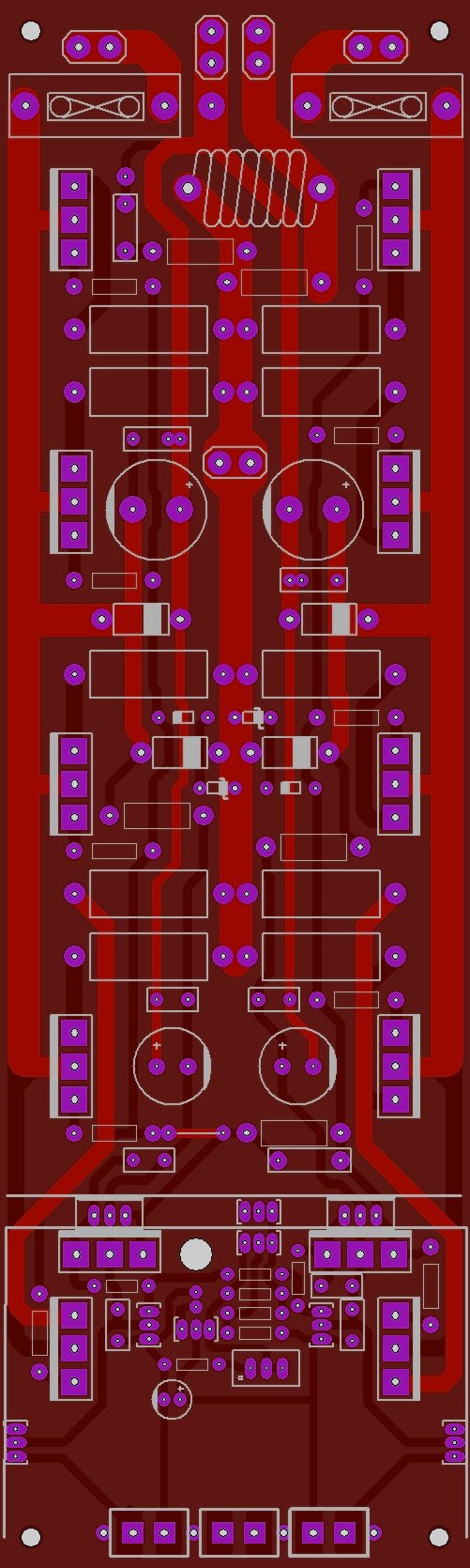

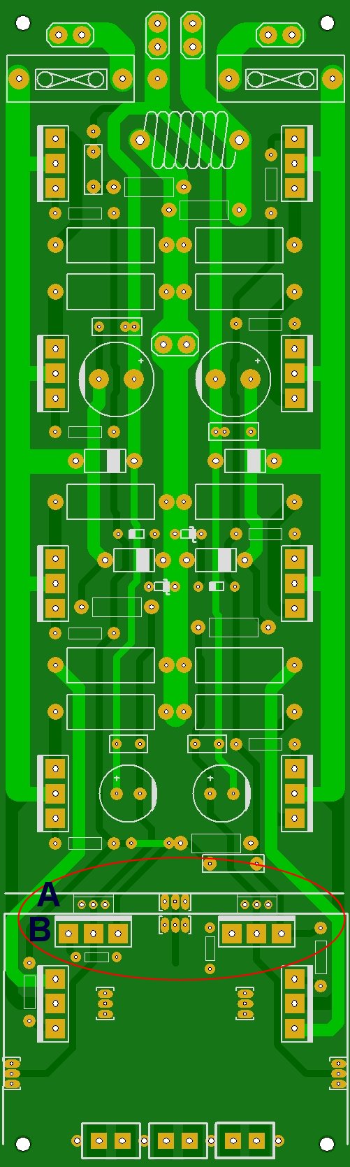

(below) I want to give the option of MOSFET or BJT (Circled-below) , so if
one thinks BJT's give headaches , let em' do the IRFP's .
A or B will be either the big drivers for a EF3 BJT or small drivers for IRFP FET's. Predrivers will have 2 SMD pads to bridge , like JK's "wolverine".
The PASS 150.5 , 250.5 series of output stages was much a inspiration
for the track layout and local decoupling. The original slew OPS was pretty
close ..... just added a few further touches. 😎
All the "fat" traces are double sided for 32.5 A Imax !!!
PS - does somebody have the IRFP schema ? So I don't have to search !

Thanks , jeff !
I see Val just used a 12V zener without the plain diode in series with it.
A zener has a lot of leakage/noise before conduction , adding the forward
diode will just have the IRFP gates seeing the standard diode's reverse
leakage ... (better).
-added 33p B-C shunts on the driver stage.
We can use a faster TO-220 (1837/4793 toshiba), as well.
Much less Ic with 1K Re .....
-red led at main Vbe. 😎
-and scaled the "range" resistor at the bias trimmer.
This will be GOOD !!! 🙂
OS
Sounding "sterile" is not the headache maker.
An unstable or "ringing" amp , or excessive odd harmonics (H3/5/7) .. maybe ?
OS
OS, I'm still confused-so I have a few questions.😕
1) Is the board you're showing above a complete amplifier board with or without the Krypton-C input stage?
2) Where can I purchase the boards or are Gerber/Sprint files available?
3) There are no component values on the board, so how do you know which component goes where?
4) Is there a BOM for the BJT version?
5) Can you use only a single pair of outputs with this board?
Thanks...

Looks like that is a new layout for the OPS. You will still need to use the IPS of your choice. OS usually posts the Sprint file once he is finished. Gerbers can be created from the Sprint files. You will probably need to create your own BOM from the schematic depending which "version" of OPS you choose. If you want to use just one pair of outputs, your would be better off using the original "Baby slew" OPS that is designed for two pairs. One of the reasons for this new design is to spread out the outputs. Now an issue with one or two pairs.

This new board -
1 - This is a complete OUTPUT STAGE. Fully compatible with all finalized
input stages.
2 - We will get to that , I have to finish it first.
3- with this one , I will lable , tell how to make a 3 or 5 pair BJT or
mosfet output stage.
4- Not only a BOM for both BJT/FET .... But i'm going to make a "BOOK" for
this one. It will be my 'crowning achievement" for the slewmasters !!
5- You can use 1 pair (what a waste), 2 pair (positions 2+4 or 1/5), 3 pair (1/3/5)
4 pair (1/2 and 4/5) , or all 5 pair. 2 pair would distribute the heat to each
end of the heatsink , the positions can be spread apart as needed with
a 250-300mm heatsink (3U to 5U). Much better thermals than the typical
DIY project.
I'm on 2 days with this one ... one more (almost finished) .... the perfect
