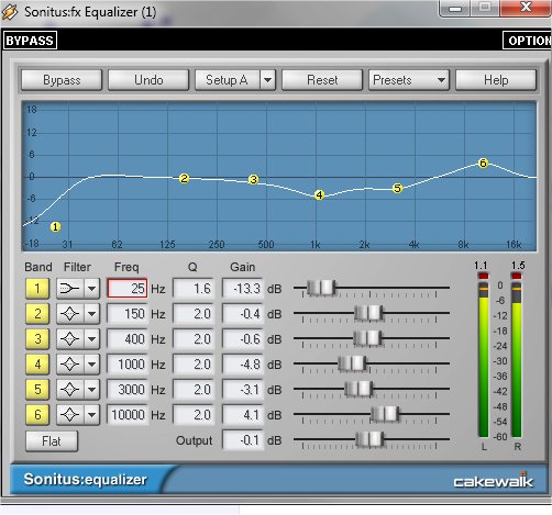

I'm actually cutting <40hz out of my listening to be able to push my daytons
to 150W+... at this level , this amp doesn't even reach 40C ("break a sweat")
Need " a shelving HPF" to break 150 (below).
Sound card just puts out 2v p-p , the amp has another 6-9db more headroom
(or more).
