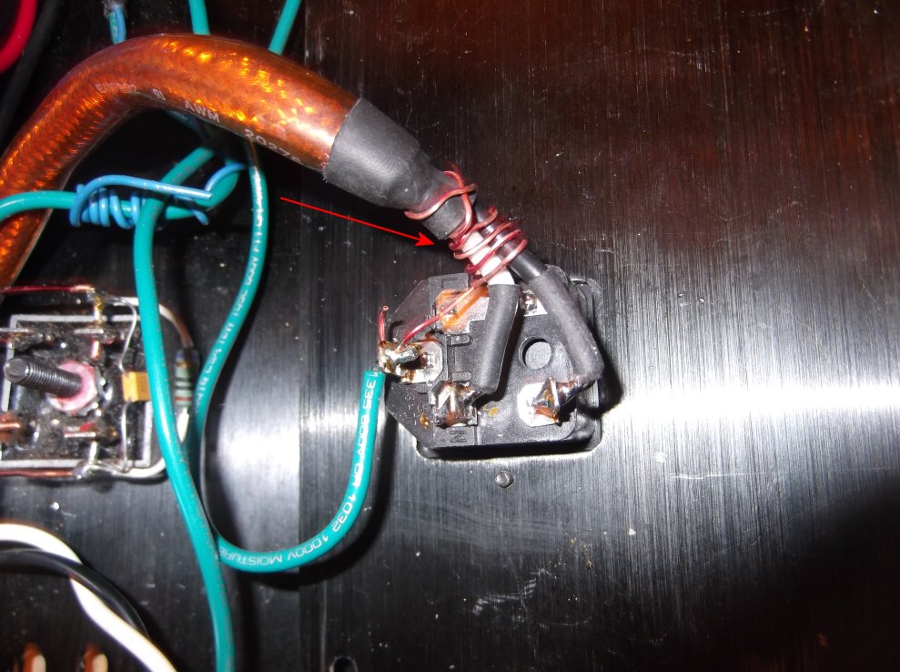

#1 - AC line fields.
With distance (and the "breadbox" enclosure) , all might be well.
If you have even a tightly twisted line pair , 4-5CM will still get you evil hum. A simple and cheap way
around this is to use old PC hard drive (round shielded) cables. (below 1)
- make a litz braid with the 2 AC and a 20ga sanded magnet wire. Snake that
through the PC cable shield , and you will have a cable that can lie on top
of an input stage while inducing NO hum !! 😱
- Your trafo primaries and secondaries can also benefit from this (below 2).
You can tie all the grounds together to happily direct connect to your chassis
ground (main earth).

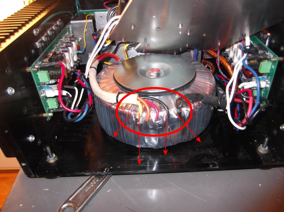

#2 -Toroidal fields.
Even in the "breadbox" enclosure , the section of the otherwise perfect toroid
that has the primary -.secondary takeoffs (below 3) is where "the force" IS disturbed.
Aim this EMF "GUN" at a sensitive amplified point .... and you will hear it !
This is new to me !!... was told this was impossible - NOT !!
All this info is readily available , used by precision instrumentation manufacturers
and is often ignored by DIY'ers.
Do it , and you will have the purest , quietest amps out there !!🙂 (-115 / input
semi noise ONLY).

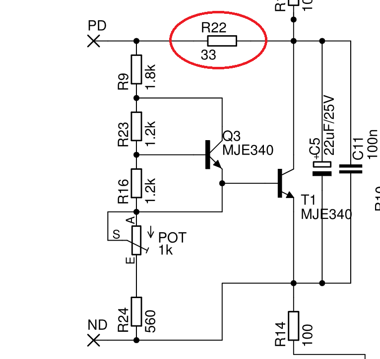

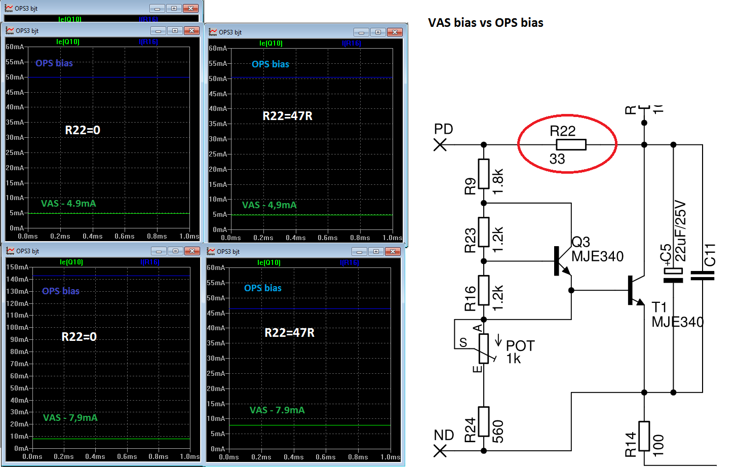

I have another small question regardless HK's bias spreader. I do not know how in real life but in simulation the OPS bias is strongly dependent on VAS bias stability.
Can I just add R22 as on the drawing bellow ?
In simulation it helps a lot - VAS bias drift does not affect much OPS bias.

Yes , Self magic resistor.
As far as this VAS bias drift , my IPS's drift very little ... .1/10th to 1/5 mA.

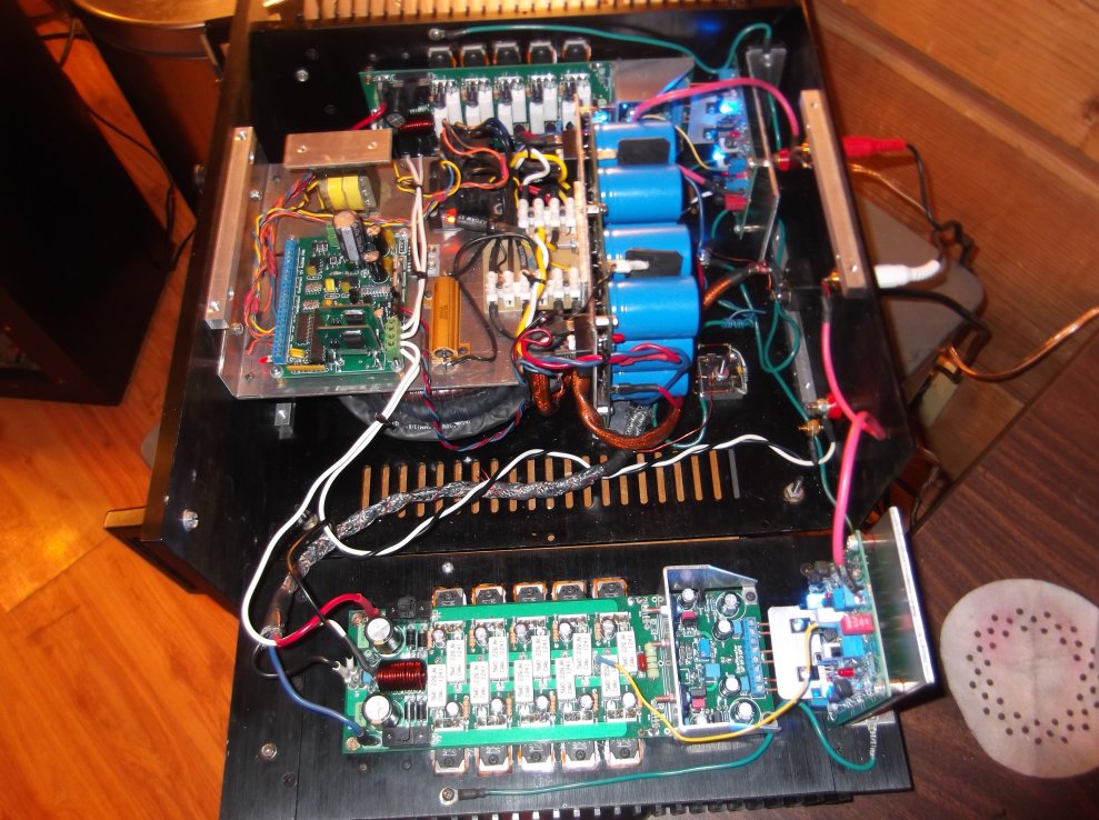

Way too small. OPS needs a 3U (5"+) height 2" X at least 11" long ,
for 90 degree IPS mounting (like mine). .5 C/W ...or mine is about .4
(larger than the HS USA 12").
.5C/W will just run warm with heavy use.
