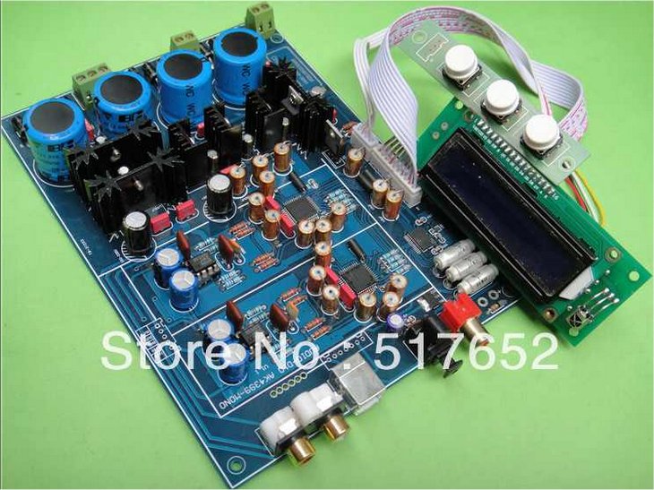

The crossover is pretty much ready for etching. Do you have any suggested reading for a DA converter?

Many dacs out there.
some have built - in toslink , all have S/PDIF.
SP and toslink are the same format - one is light, one is electrical.
They make toslink to spdif convertor kits (10$).
So , any DAC would work.
Many of the "pocket DAC's" are toslink capable and can be had
for <50$. Only 95db noise on these cheepies. 🙁
In kit form , 50$-150$ gets you a TDA1541 to a ESS90xx -
with or without toslink (get the adaptor). >125db noise/192khz ...
puts the best creative/ASUS D/A convertors to shame.
edit- with burr-brown ADxx op-amps , a good DAC has 1-2ppm
THD. ONLY source that can pull this off.

TDAxxxx is last generation 16bit DAC tech.
Prices have come down - (below) there's a whole display/32bit AK4399 (32bit)
- <70$ !!
Or - CS4398's are dime a dozen <50$ (24 bit).

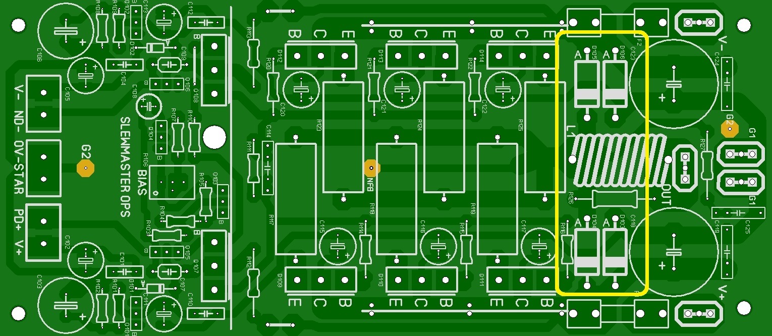

hey guys I have a question on the power supply input area I notice the 4 MUR460 diodes that can be use on other audio amplifiers ? and if you don't mind guys can some one explain what are the purpose of those diodes on the circuit sorry for the silly question 🙂

Hi Juan,
The diodes are a sort of protection.
One pair protects against incorrect polarity damaging the amplifier. The idea being the rail fuse should blow and the worst case would be a shorted diode, though they are pretty tough and would usually survive.
The other pair are sometimes called 'catching' diodes and prevent reactive loads like real speakers and crossovers from being able to back-feed to the rails. In theory a wicked load and the right signal could send a pulse back that would be twice the rail, though such a situation is highly unlikely in reality.
Both could be considered optional, but for a few inexpensive diodes you get a somewhat more hardened and fool-proof design without any notable drawback.

thanks you for the explanation 🙂 I was really curious if I can use that on this layout I think it does not hurt at all if I use it, I apologize if this is not a slew master subject but the diodes safe features from slew master I'm really interested in incorporate that into this design, to be honest this is the first time I'm making a double side PCB and not using any jumpers lol, thanks again 🙂

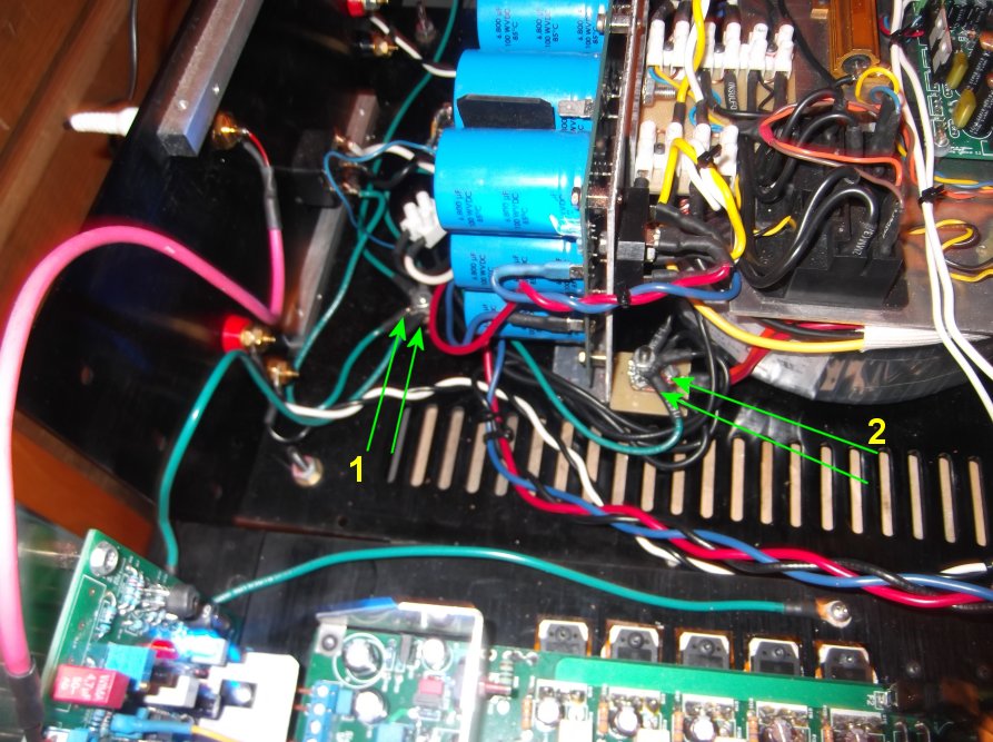

> -115db S/N (and lower).
As I said , hard to get.
My H/K 680 - only -107db
-pass X250 -117db
-parasound hca2200 -115db
Curl and Pass must have a secret ?
Can the lowly Slew be brought to this level ? How can you hear noise and
hum lower than the speaker can reproduce ? (Headphones)
First , (below #1 in photo)
All chassis parts , the 35A bridge ground loop breaker and any RF filtering -
go to a direct chassis star. (that must hook to a real earth ground).
The loop breaker will have a paralleled 10R/1W and .01uF cap to pass
(isolated ground) RF to earth.
From that loop breaker , the green wire (#2 in photo) connects to an isolated star.
Here , you use a plastic washer , put 2 layers of heat tubing around a 6mm bolt
going through a 7mm hole and place another insulator at top (FR-4 shown).
To this star connect all capacitor returns , OPS /speaker returns.
Splitting the isolated / chassis direct grounds was the "trick". Not only was I
below loudspeaker detectable, but I am at the headphone level (barely detectable).
Toroid induced fields are also a consideration with a tight "package" (my amp).
Any auxiliary circuitry should either have a floating ground (or referenced through
a lift resistor). Isolating my protection circuits ground was another "milestone".
Screws and any metal part near the toroid generate minute voltages that WILL
affect a sensitive amp. 😱
With these "tricks" ... all worked out , I now have my 10K$ amp. Most likely
specs out the same or better than the parasound/pass.
PS - this grounding even "absorbs" a formerly chronic ground loop. a-mazing.
Can't do this stuff with LT spice !!!
Edit - this had to be done to continue with ppm IPS's that are capable of -120db
noise levels !!!

That's how mine's hooked up but I'm still getting a little 60hz. I've got to track that down this weekend.
The old way , with my 88db small speakers - heard nothing.
My 91db daytons - I heard it (faintly). So , I decided to see how far (low)
I could go. Even washing my spooks and kyptons in alcohol and
a toothbrush (flux residuals) reduced the noise.
