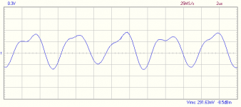

Still there with no input wire. It's only there when I attach my signal generator ground but the protection circuit it tripping as soon as I touch an input.

It's around 200kHz. It's not there with music but as soon as I connect music from my PC I'm getting terrible 60Hz. I've definitely got some grounding issues.
200K is too low for typical oscillation. OPS / IPS oscillations are local FB loops
oscillations are Mhz with modern devices.
The phase margin at 200K is massive and that freq. is in the passband of
the amp regardless ??

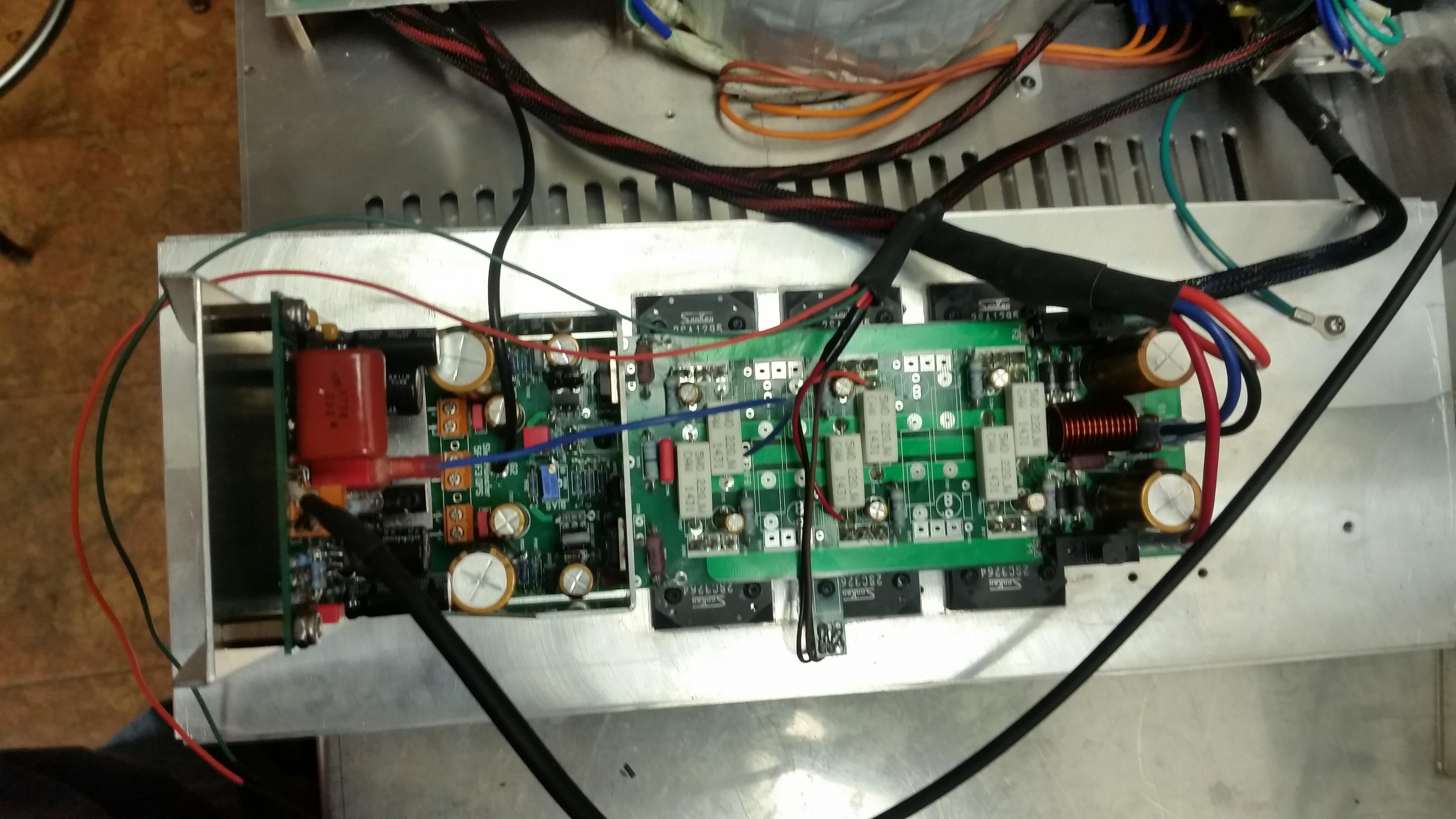

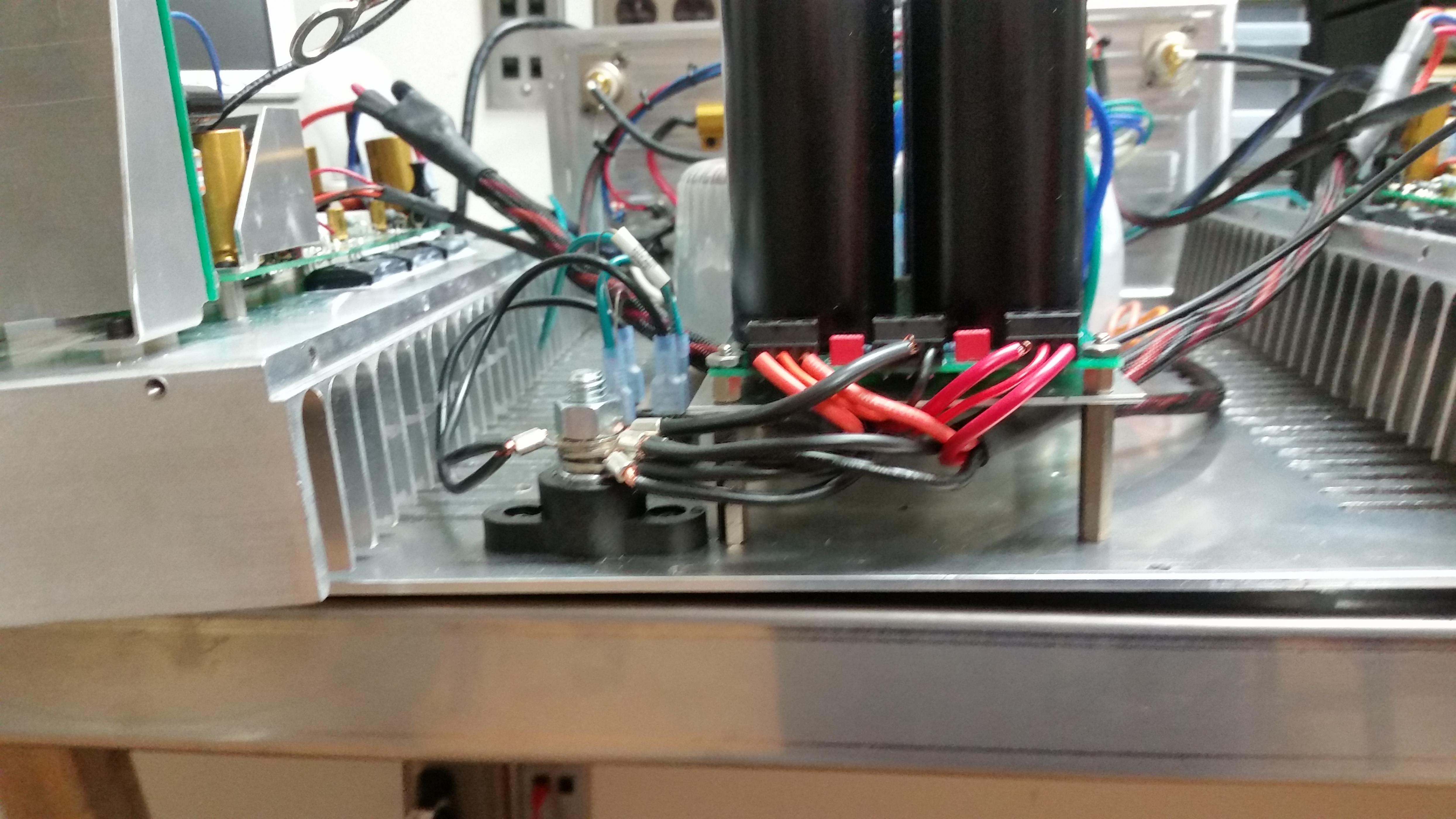

There wasn't any sign of oscillation or hum before I assembled the chassis. I've changed the bias transistors to MJE340s which seemed to have made bias settings rock stable at every temperature I ran it through. I melted a couple .1uF film caps (cosmetic) while changing connector pins on the input board for a different mount so I changed them to ceramic X7R. Speaker returns, output board grounds and G2 grounds are all connected to a star ground. The star ground connects to earth ground through a monolithic bridge paralleled with a 10R resistor and a .1uF cap. I think AndrewT would approve of my hook up other than the crappy signal wire. It seems to me like the hook up is where the problem is originating though.

It was a strange wave form. Did you notice the step in the positive swing? It was even more pronounced at times.
It'll be hard to see anything in a picture. The power wires and speaker returns are all twisted together and put into wire loom and it's all in the bottom of the amp. I'll snap a picture when I get back at it.

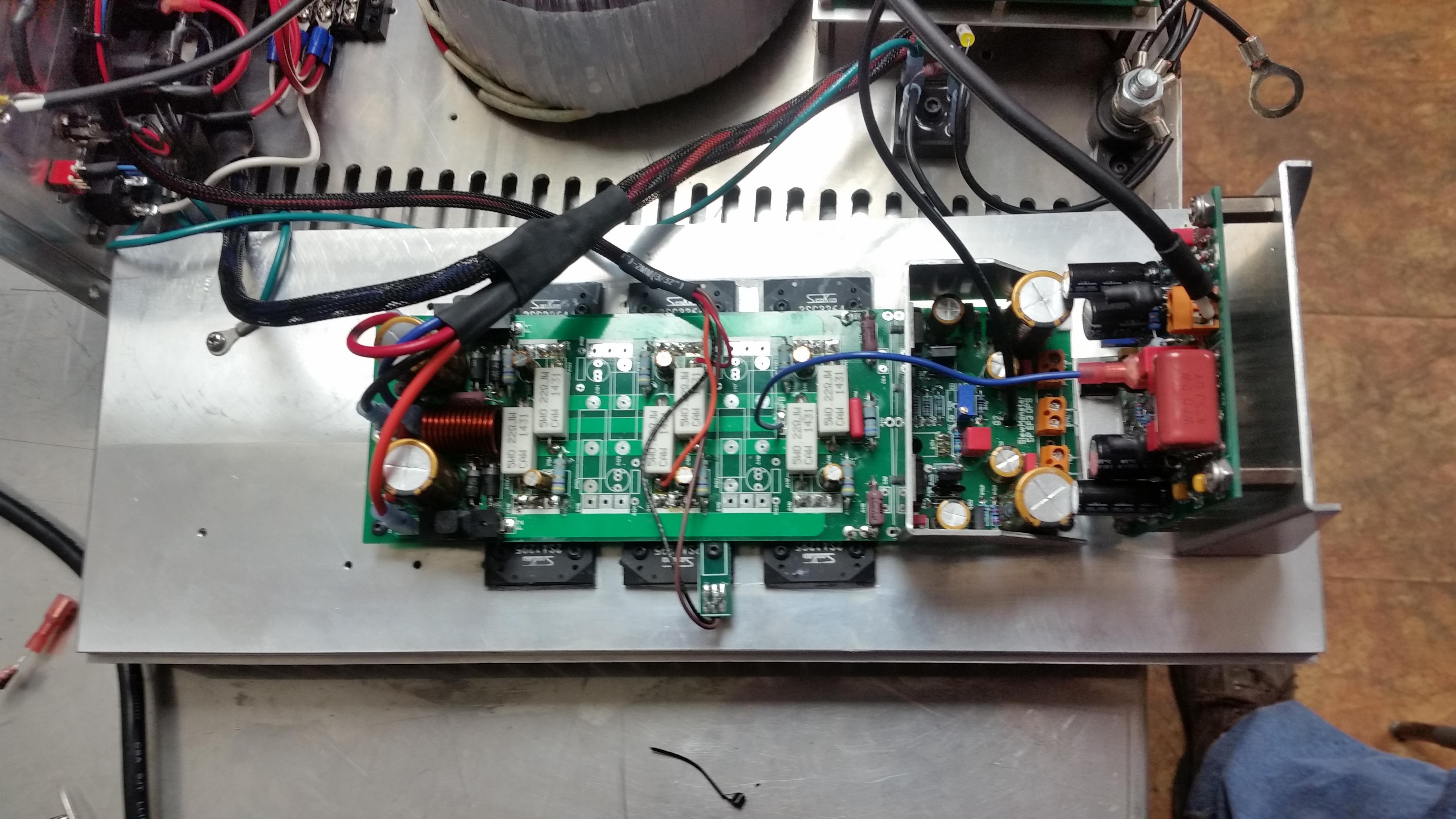

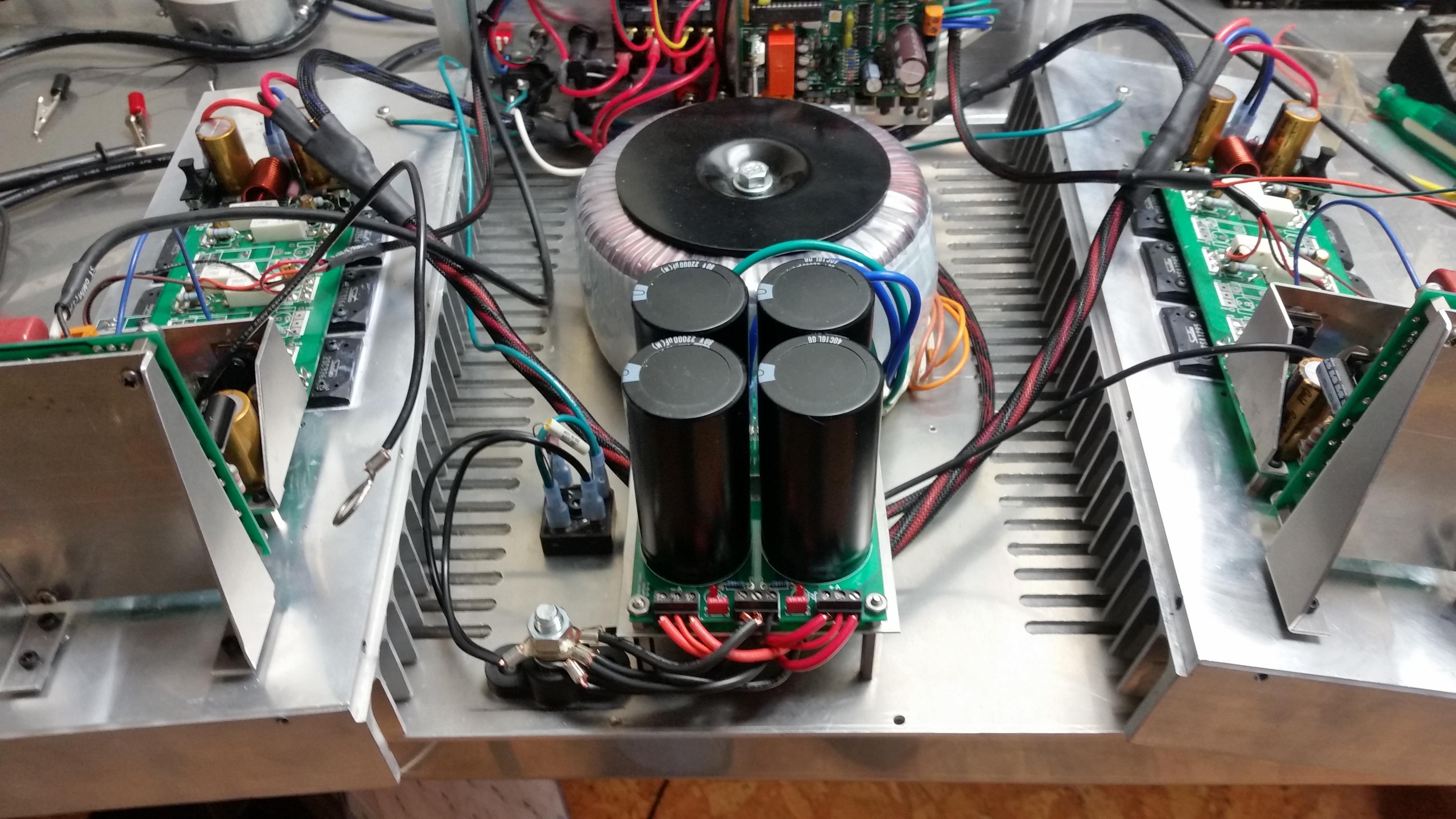

Here is my star ground. I think the ground euro-connector on the supply is going to be replaced with a 10-24 stud. I had enough connections before bringing the G2 and speaker returns directly to the star ground.
There are two things I see different than mine.
My speaker output and speaker return are a separate wire run with the
speaker ground back to the main chassis star.
Your amp output seems to go in with the rail feeds ?
My MJE 340 goes right to the extrusion itself , away from the outputs.
I just want to measure the extrusion C , not an individual device. At 55C ,
that whole extrusion is going to be baking 😀 .
On a major level ... you just have 1 PS ? Mine is dual bridge , with
4 separate rails. I don't know if that is reason for my "110%" , but
it was the most logical way for me to proceed. Parasound (john Curl)
HCAxxxx amps do this exact thing. Super quiet , as well.
Most of your general layout is similar to mine.
OS
