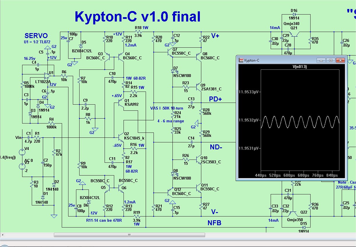

Hello.Been away for some time.I read that there have been some changes in parts value in Kypton C IPS. Mine is based on files from post #4729 .what values have been changed and why?was there a stability problem or something else?can you post final schematic? my kypton c is based on this schematic below :

R6 should be 220R. Here's the latest schematic.http://www.diyaudio.com/forums/solid-state/248105-slewmaster-cfa-vs-vfa-rumble-633.html#post4210879 Resistors in the VAS section need to be tuned to your application too.

Your link takes me to Post #6451. No information there. What post were you referring to?
Schema will work as is... But R6 should be <1K and R8 can be optionally
eliminated. Servo will work better here.
VAS emitter resistors (R22/27) and Zener regulator dropping resistors might
have to be fine tuned for whatever rail voltage , that's all.
NO stability issues whatsoever !
