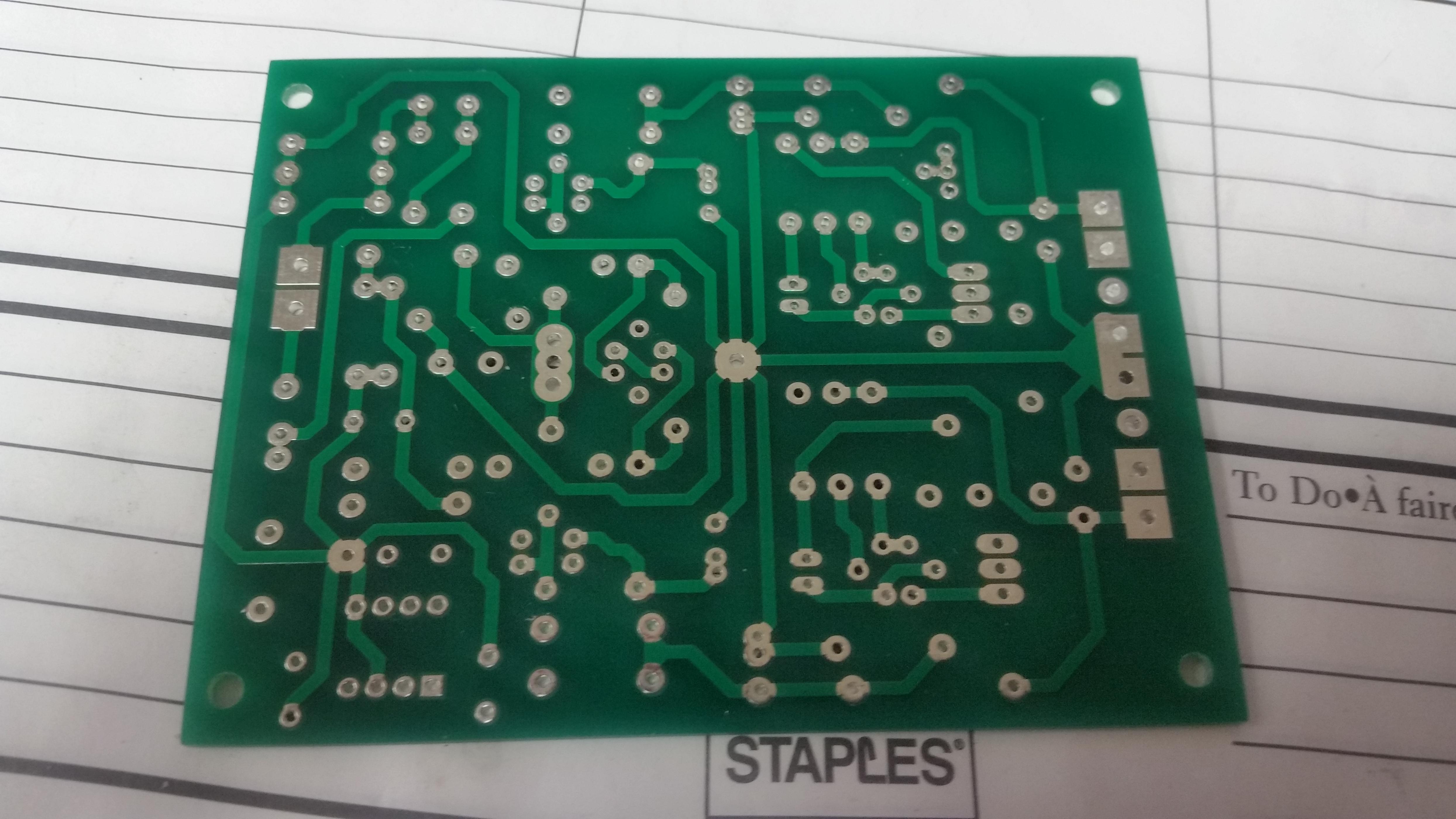

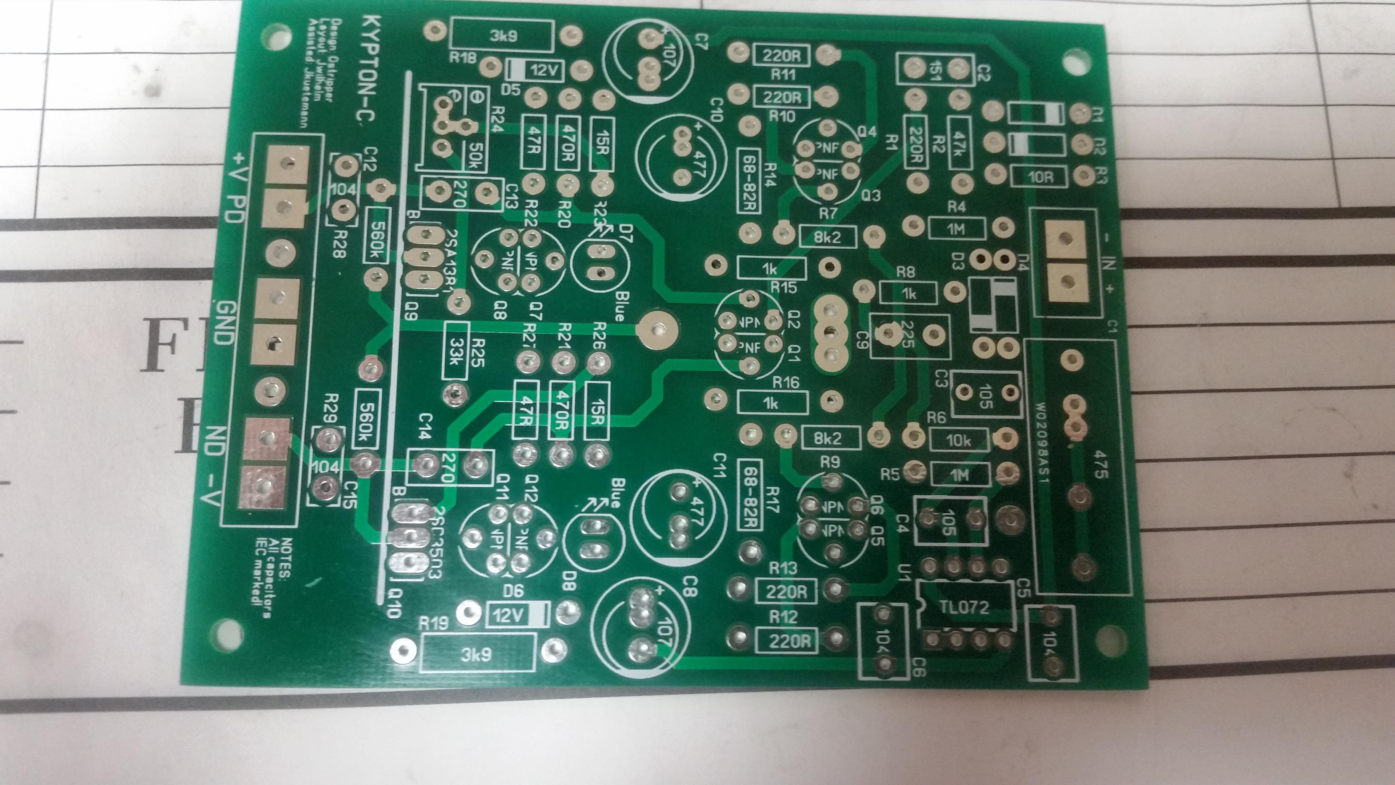

I have found more layout errors on the PCB, the input R1 + R2 + R3 + D1 +D2 are also shortened by R3 because of wrong tracks. I did a re arrange of these, id did not solve the main error, but I have now attached a picture of the top and Buttom PCB. (unused PCB without the fixes)
Can you please help me look all the traces and pads to see if you can found more errors?
Where is the wrong tracks for the input?
Please see attached picture, showing my modifications
The green arrow show where I moved the input track (topside) to
The red arrow show a new shortcut I made.
Blue arrow show a cut I made.
