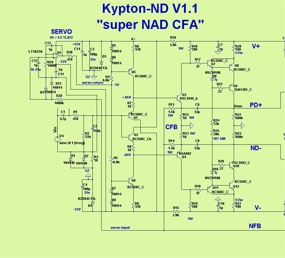

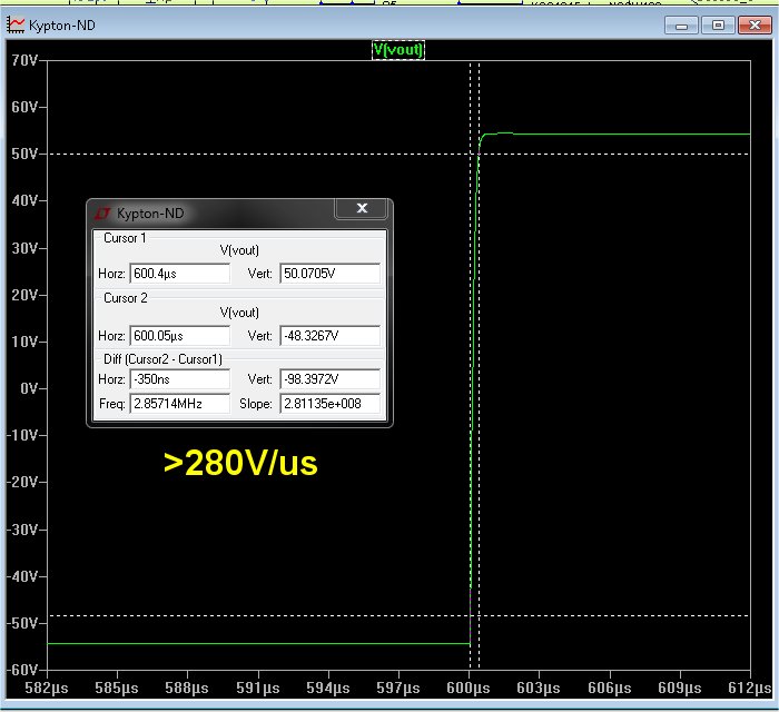

And so does this one (below 1) 😀 .280V/us - easy !
Absolutely ideal. Another Russian member applied the current feedback like this -
and I "stole" it .. 😎

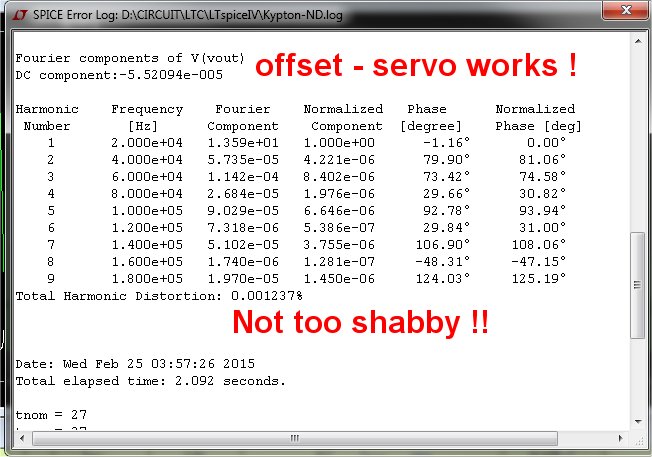

Got me 10ppm on my older NAD design.
(below 2) is the slew WITHOUT tweaking.

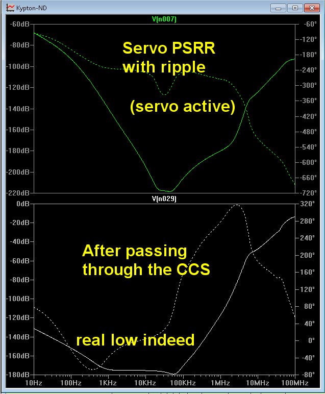

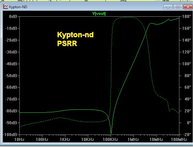

(below 3) is the PSRR without the cap multipliers.
(below 4) is the THD into a 4R load.

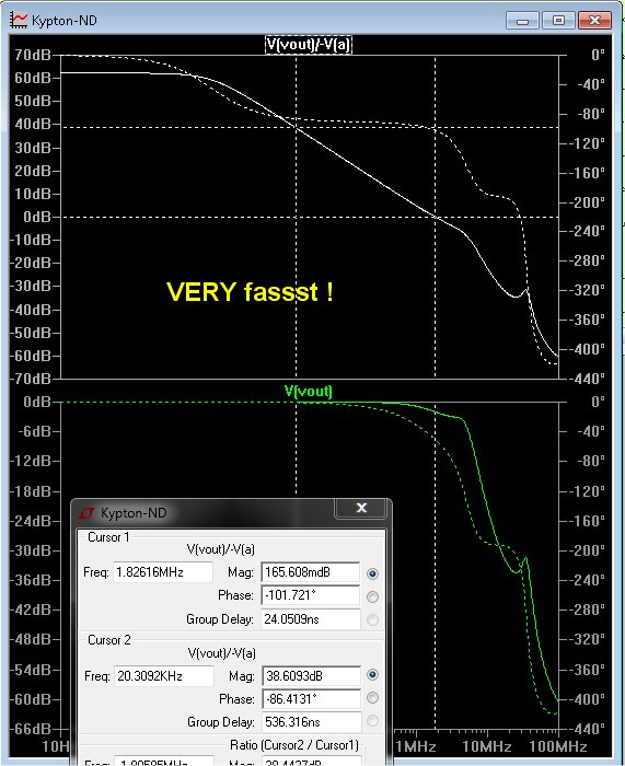

(below 5) is the Bode with the 40mhz "peak" (baxandall)...
I know this , as with a hawksford VAS , it disappears.
The Kypton C has this too , but I'm listening now (it's in negative gain territory) 🙂
Infidel taught me some things , on this one Q1-4 fully cancel thermally .
All is ideal with this 🙂🙂.
It's going to sprint (layout) now !
Kypton C is the "close cousin" , I already
aced the NAD , this is just the refined best of the two.
Truly stunning simulations (rock solid stability) .

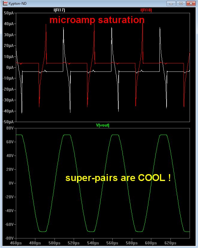

Edit - (below 6) ... the best part , rounded "Valve like" overload behavior -
"all hail the super-pair" !!! 😀

That's a folded cascode "symasym"(symasui) - I built it. I was a member when Roender designed it.
Member MJL21193 "stole" it for his "abomination" amp ,too !!
OS
Did you removed the input filter to measure-it ?.280V/us - easy !
Because, if you don't, you do not measure the slew rate capability of the amps, but just the bandwidth limitation of the input filters witch is useless.Did you removed the input filter to measure-it ?
So you'll have poor numbers, not reflecting the real possibility of the electronic, witch have an impact on TIM.

So is this an improved version of the Krypton C or a very distinctly new input section you are just showing in your plots?
It's actually old AND new.
First CFA I "tinkered with" (the NAD). And the Kypton C , which I'm listening to.
Apply the old to the new ... get a better one.
I changed it a little , actually simpler (below).
Dropped the second stage cascode - now I have about .15ma VASout thermal
from 10-50C. I know this is close , as my "C" does <1/4ma in real life.
Esperado - this one will max out at about >300V/us right at overshoot. And
yes , I did remove the input filter. With the 150pf input filter , this design will
still do >250V/us.
All this is also very similar to a VSSA type design. What is superior here ,
is the PSSR , THD (more CLG). The servo return is not "working" hard
and does not interfere with any audio path.
Just all around "well behaved" (for a simulation).

Hi OS. Well designed (enough output attenuation) a servo never interfere with audio path in the audio bandwidth.The servo return is not "working" hard
On my point of view, there is no difference if you set the return to a css or to the feedback return point. they both will interfere the same way to the signal.
(CSS *are* in the signal path, don't they ?)
Thanks OS,
Simpler and better is always nice. So you have basically updated the Krypton C with some minor changes.
Now that you have been listening to the Krypton-C for awhile what is your thinking on the sound? I know you are the kind of guy who will for curiosity sake keep trying new things and looking for improvements but what say you from the point you are at now, are you satisfied with the design sound wise?
The C is so close to perfection , I'll put them in my mini OPS's .... I won't shelve them.
This one's "sound" might be so close you would not be able to tell .
Electrically , this one is more "precision". It performs better thermally, servo
controls the offset "easier".
TOTALLY DC coupled , with no big 470uf NP electro's ... is the attraction.
A true 50 year IPS - tough !

Yes , you are technically correct. If you inject an error signal into the servo ,
you will see it reduced by >20db by the CCS "buffer".
But it still acts as this "buffer" , which is far better than a direct return.
PS - the way this is ... the CCS diodes are 95% of the reference ,of which
5% is "shifted" by the servo (which has low pssr itself).
Look below - the CCS actually drops LF psrr by >50db to the input pair..

Yes we tried no servo , both non-inverting and inverting direct servo.
here we have nearly a "non-servo" servo 😀 , I just did my sims with
NO servo - NO change (except offset).
But , we have it hooked to the super VAS (I'm still listening 🙂).
Might be a very good combo !
There really are no other CFA topologies out there beside paralleled
NAD's (accuphase amps).
