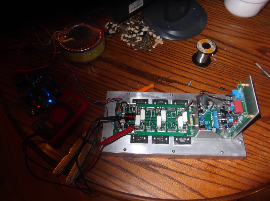

I have 340/350 predrivers mjw3281/1302 drivers and 3281/1302 outputs. 5 pairs. This seems to work long term at both +-72vdc and+-82vdc. My scope is old and slow but sine waves looked OK. I followed attached schematic. I have only used this ops with the cfa x h ips. It did not like the tubsumo ips. csa and csb are I believe 33pf silver mica. This is a nice sounding very powerful amp...well worth the time.

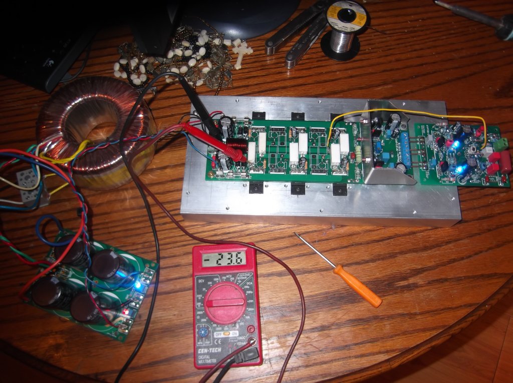

Bias setting is even easier now. So far, so good. I'll let it warm up for a couple minutes and beat it up with some sine waves.
"squirry bias" is the poor man's hint of OPS oscillation.
I discussed this with you .... slewmaster is a"poor man's thermaltrak".
NO load 17mv bias ... overload it to hell , the driver Vbe - with it's 100ms
thermal time constant ... compensates until the outputs catch up (thermally).
WOW , Evan's trafo puts out 65-0-65 , just 8 short of my big amp PS (below).
Kypton C VAS jumped about 1 mA , this is because 1/3 the current is just shunted
by the blue LED's. BTW , D8 led is the one reversed on the silk screen , Jeff.
OMG all 6 small caps on that OPS just EXPLODED !!! I put 100u/35V's in there.
35V'ers lasted a full 5 minutes before popping !! 😱😱
Ha , yanked the caps - OPS still lives.
Whoa - scary !! 😱 No more shine for me 😀 .

I have the exact same setup as Evan right down to the MJW3281 drivers. I don't have the csa, csb installed though. I have used them with CFA-XH and both BV derivatives, Symasui, Wolverine, Spooky, Eyesee, Krypton C, Krypton V, Low TIM hybrid, Infidel and even an Apex AX11 IPS. They just work. I'm not sure what is going on in yours. I notice on one shot you have flying VBE and on the other it looks like the vbe is under the board. I have one set with the vbe under the board and two with the vbe flown. The only difference I can see between them is the one with the vbe mounted on top of the outputs is quicker to settle.

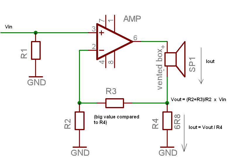

Off topic here we have been having some discussion of speakers over on the Blowtorch thread and I wasnted to show you a concept to reduce distortion in speakers and bring the speaker into the feedback loop; Do you think this could be implemented with the Slewmaster Krypton-C amp? Let's see if I can attach the picture which is post #604092. This whole point was to lower distortion in the speaker, not the amplifier.
Actually , the slewmaster would be the forum's best bet to test out what is
in your schema.
The NFB return is a wire !!!
PS - you might have to manipulate the NFB ratio to do this - and
check loop gain effects.

I took out a couple rectifiers in the supply. I'm going to test this out with a 40 volt supply.
That's prudent. you can't do much damage with a 250va 40-0-40.
If I just exploded my caps on the big 1kva 73V'er , they would of flew off the boards-
imbedded in the wall 😀 .

The other channel seems to run okay on a 50-0-50 supply. I'm thinking I damaged the set of outputs from oscillating.
I've got a rail each of njw1302/2381 in stock but I wonder if I should just spring for some Sanken MT-200s? I don't think I could hurt them.
I blew up my IRF output OPS with a Tubsumo IPS. I tried replacing just the outputs that measured bad. It wasn't until I replaced the diodes that it worked properly again.
Or maybe you had a bad set to begin with. I actually Hfe check every device
