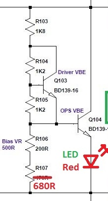

Gabor, I only use this design (very successfully) with IRFP240/9240 Hex-FETs. Never tried any other FETS here. However, I believe Toshiba's verticals will work fine. Please note - we had to modify the Vbe spreader (adding a red LED) for better match the tempco of IRFPs - this will most likely be required for Toshiba as well (see attached, plus my and Jason's posts earlier in this thread).
