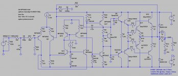

Just finished my 4th new design ---> Kypton -ND.
"Kypton -C" needed a "brother" 😀 ....
The old NAD ... with -
- CCS/servo (not in audio path).
- Super hawksford/baxandall VAS.
- Cascode on 2'nd stage.
- Q1/5 and Q2/6 fully negate thermally (just leaving the negative LED CCS's).
-also .... "clips like a tube" !!
(schema below 1)

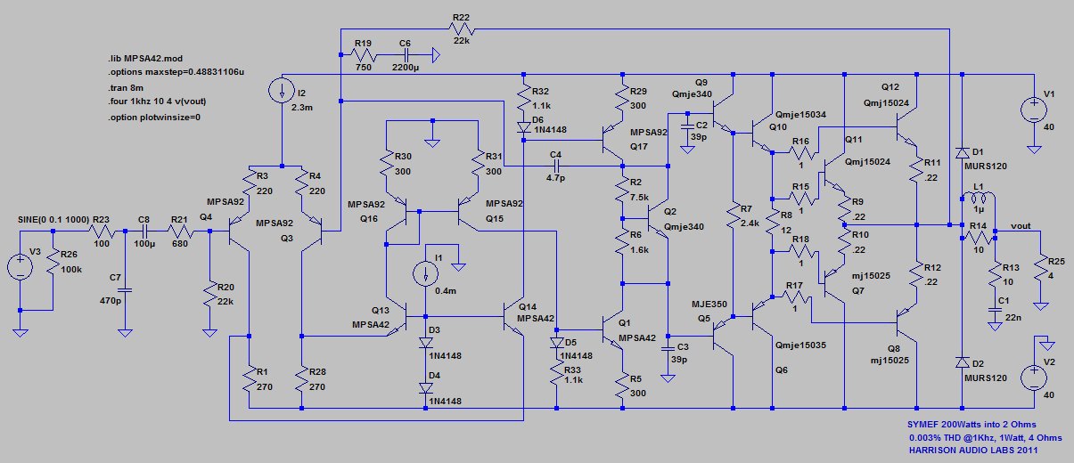

-Upcoming ... the bootstrap amp , simetri , this Kypton , and I have permission
to do ONaudio's " SYMEF.
SYMEF = a blameless/LIN with a mirrored cascoded symmetrical drive VAS. The
level shifter approach is different. (symef concept- below 2)

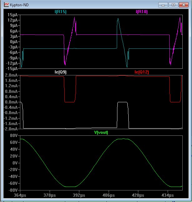

Edit-( below 3 )... Kypton-ND does the "overload thing" better than "C".
plot - super pair base (top) , clamped super-pair emitters (middle) , and tube-like
rounded overload (bottom). 15ppm and nV offset , as well.

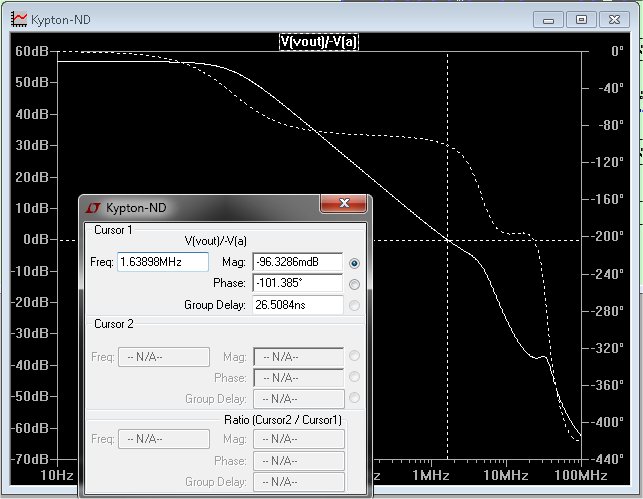

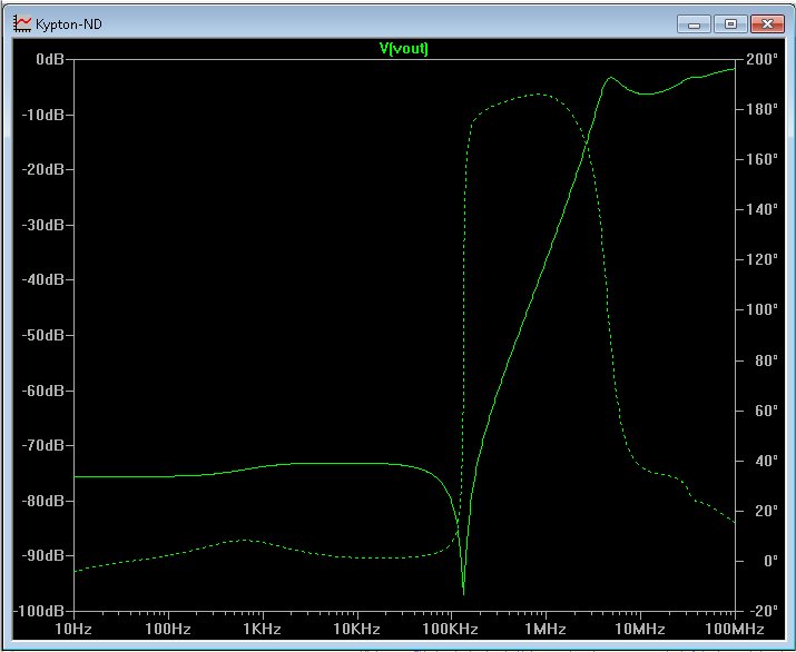

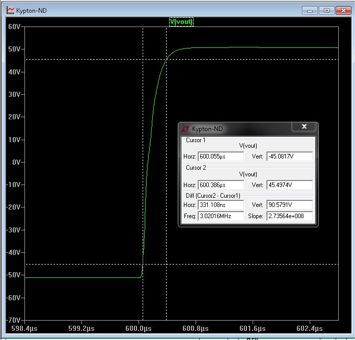

Hardcore CFA tests - kypton-ND
(below 1) - the PSRR is acceptable for a CFA.
Improvements in the power supply (dual mono or variants) will
make for good SQ.
(Below 2) better gain margin and higher UGLF than most.
(below 3) absolutely perfect rail to rail squarewaves with 270V/us slew.
As I said , thermally ... less than 5% VAS Ic variation (0-50C)
The infamous "Infidel" was the source of this perfection.
The layout and performance should actually be as good (or better in some aspects) ,
than the kypton C. NO DC caps , single current FB path , single simple compensation path.
Oh , better 1st/2nd stage BCxxx devices .... (high 500Hfe)
Thimios built 2 versions of the old "NAD" - I know it performs.
This performs X2 !! 🙂

Did you build this or is the spice?
That's for me to know and you to find out with a toner transfer. 😛
It's the other method for a flawless CFA IPS.
PS - It's not the "infidel" ( and thimios built it twice - before you came).
OS
I can't do the toner transfer without the file. I was here when thimios built the NAD. However you gave the impression that the cfa-xh was the newer, better design so I built that instead.

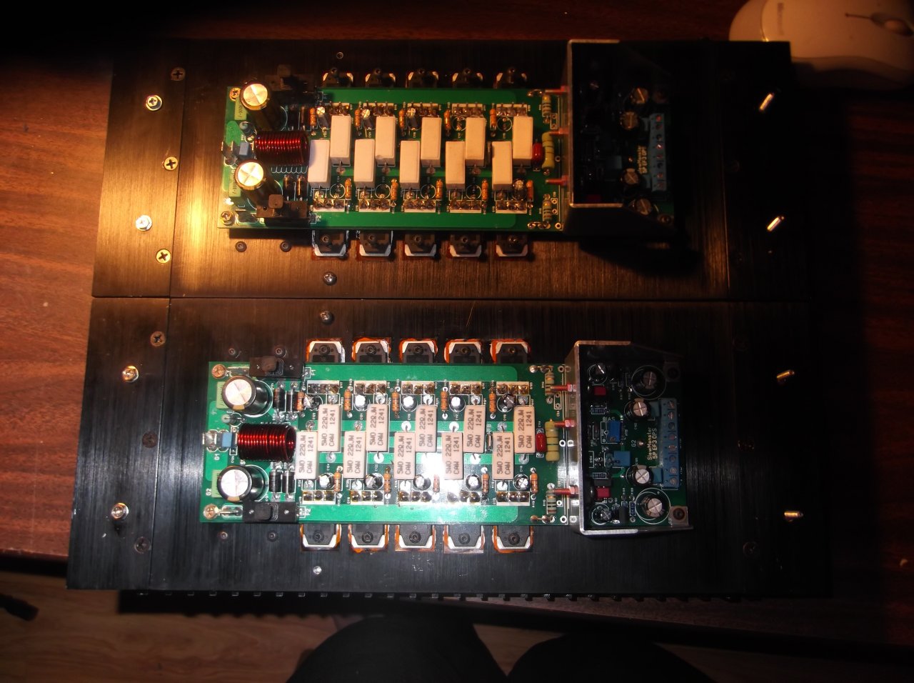

EvanC's "real man's" trafo is really a 400VA , and it gives 65V rails for the sub.
Just a humble 2.1 home theater/music system.
PS - I had to re-machine the main amps to put the outputs in the
middle - my only major screw-up. (below)
Off - center more than 25% horizontal makes the end output pair much higher
bias. I'm under 10% now ... 🙂
OS
