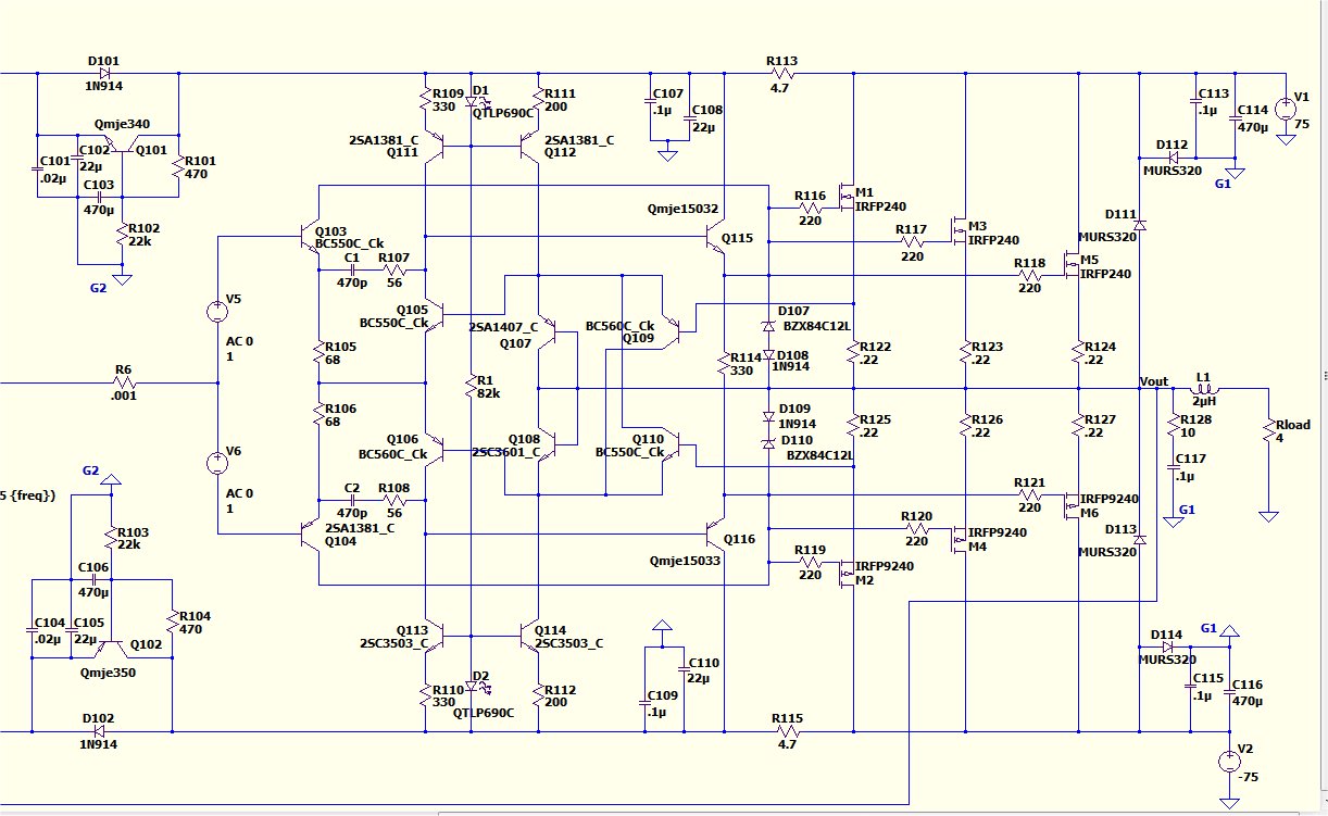

Jason, OS, vzaichenko and other tech guys please take a look these circuit with Toshiba mosfets.
I'm not sure the VBE is correct, also what do I do with the previous trimmer, do I need both etc.
I do not want to post more circuit here even do it is similar. I don't want to pollute these tread.
I'm almost ready to etch the PC boards but I having second thoughts
Thank you guys in advance.

Jason or Vzaichenko would be the ones that ask. 😕
If I were to get my 2P "babies" LATFET , I could tweak that vbe.
If those toshiba's are latfet , they are NTC .... leaving only the driver Vbe .
Vfets are similar to the BJT's - using the same 2 device Vbe.
PS - the unchanged Vbe circuit is perfectly "tuned" for the BJT's (this I know !)
OS

Gaborbela,
You have a thread already for this, so I'm not sure how your endeavour relates here. Ostripper has clearly concentrated his effort on BJT triples with the minor diversion vzaichenko and myself took down IRFP alley appearing quite unwelcome.
The Toshiba devices you so desperately want to use are rather unique, being relatively low threshold MOSFETs that are of vertical construction, with a tempco more like BJTs than Hexfets, and definitely different from laterals. Your application will require a unique solution tailored to your devices.
I have no direct experience with you specific devices, nor with the Cordell implementation of Hawksford error correction. Hopefully someone more familiar with your requirements can chime in on your new thread to help out.

And there you go (like others) .... second guessing how I really feel..
PS - I'm not Shaan in the Peeceebee thread 😀 .
Modifying the BJT Vbe for HexFET's is welcome (as it does work).
Perfecting a dedicated Vfet or Hexfet OPS would be better as a new design
to incorporate the proper V/Id curve and gate protection where applicable.
Increasing the Vgs with the led was quite a good solution and should give nearly
BJT accuracy.
OS

The comment is just based on observations of you reaction whenever the HEXFET configuration is mentioned. Nothing more.

I actually very pleased at how good the Hexfet ops sounds. Very, very good. Valery has been using it to test most of his OPS designs and he too has been very pleased.

Would you be so kind please take a look on that circuit😀 before I go on to etch the PC boards.
Thank you
I'm not against these modifications .
It's just that FET models suck and I could not stand behind what I am
not 100% sure of - so , I "passed the buck" (to the modifiers).
I've built IRFP OPS's - hence , my comment on the Hexfet mod.
PS - gaborbela , I've gotten the EC cordell to work very well with hexfets ,
but the latfet models "suck" (so I don't know).
My experience says a simple one device driver Vbe is all that's needed.
but adding the EC will complicate this considerably.
OS

To make myself clear I have some (20+ pair)Toshiba 2SK1529 & 2SJ200 so I would love to use them these in type of power stage.
Two circuit was posted on these forum I do like them a lot one with IFPP hex-fet but that was not tested or built based on my research
The other was tested and perform very well but that was built with Lat-fet.
I would prefer to mode the Lat-fet version since that was tested but need some help to do so.
Greetings Gabor
Hi Gabor,
Where did you find this schematic?
Cheers, E.

My fault 😱 Edmond.
I was "playing". It works (in simulation). 🙂
OS
Fault???
I thought you were mad by your inquiry - it's your design.
OS

Can you please post the results of that simulation, do you plan to build it i.e. lay it out for fab? Looks Berry Berry interesting, comparing it to Damir's offering would be sweet...his is CFA on the front end and he is building it as we speak...😀

Hi OS,
No, I wasn't mad. Instead, I just would point out to the one who dropped the schematic (in this case you), that one need perfectly matched trannies for Q105.. Q114, that is, PNP to PNP and NPN to NPN. That's all. 😉

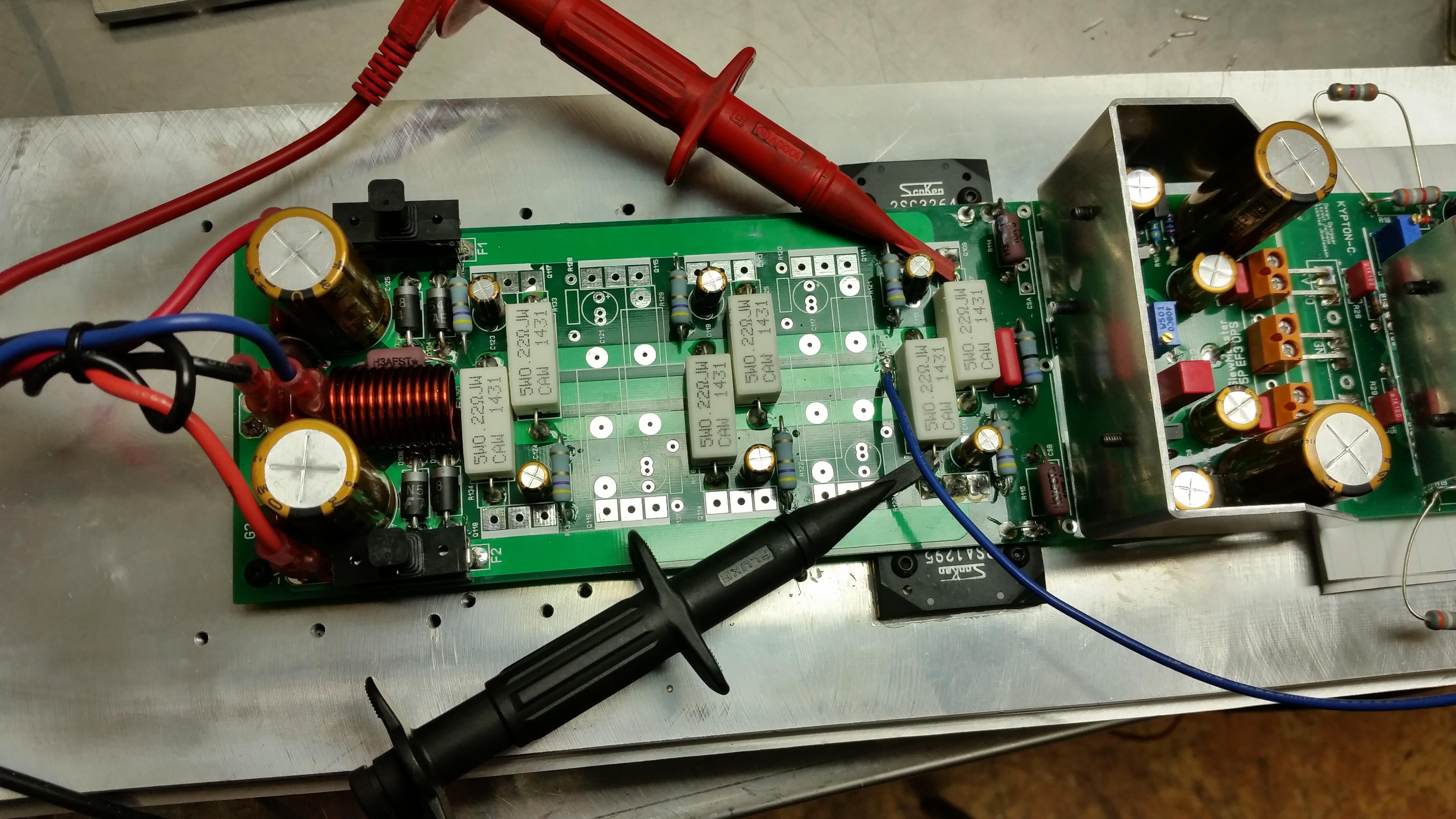

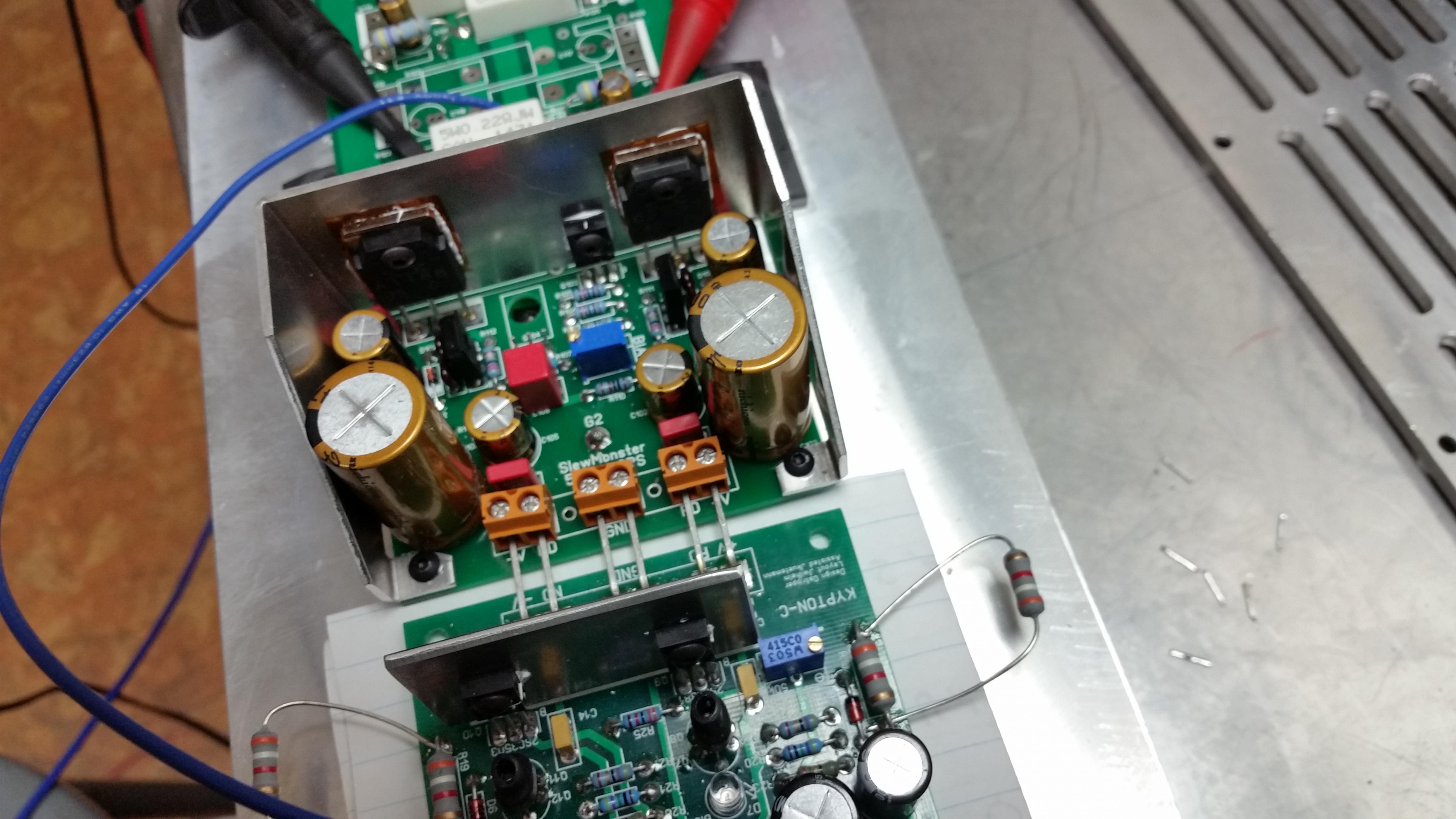

My 2mHZ oscillation is back on a brand new pair of output boards. KSA1381/C3503 predrivers, 2SA1186/C2837 drivers, and 2SA1295/C3503 outputs. I've got cap multipliers on these boards. I'm going to try them out bypassed later today.
- Slewmaster - CFA vs. VFA "Rumble"
