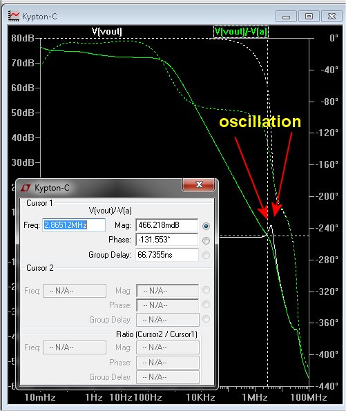

Oh , Jeff ..... 1K as R15/16 make for a "fat" peak at 2-3mhz and the amp
shows marginal stability with very little phase margin (below).
2.2-2.4K + 68/82R is ideal - margin wise.
OS
The puzzle fits perfect.R15 and R16 was a good guess then.
That "peak" also causes bad ringing on squarewaves or outright oscillation.
Funny how it falls right in the offending 2+ mhz range.

I ended up with 68R for R22/27 and 470R for R20/21 for 40 volt rails. It's much more stable now and lots more gain.
Lets see some squares !
I knew , it's essentially a CFA-X floating on servo'ed mirrors with
a bad ar$e VAS attached.
You were out at the end of it's "rope" with
a 3mhz unity gain point. Now it's 1.6mhz with a nice 90 degree margin. 🙂

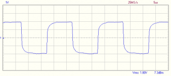

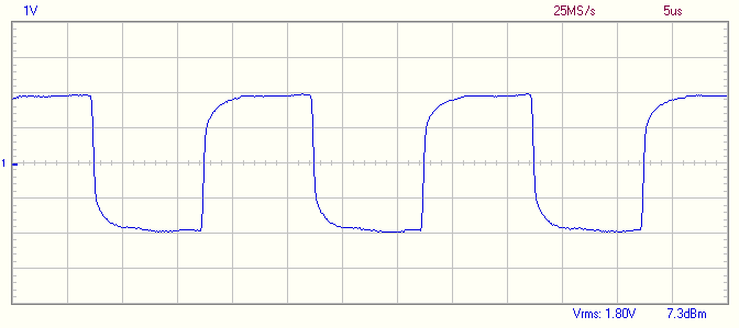

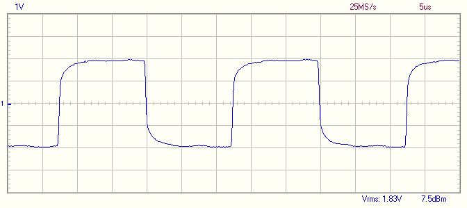

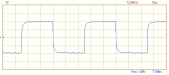

I've still got a slight glitch happening. I'll post a couple screen shots in the morning. There's still a little upscale 500kHZ tick on the waveform . It's very low voltage. I don't know if it's an issue or not.
it has been some time since i last visited the thread. so, are you saying that Kypton-C is facing stability problems?
My output board combination was unstable. Kypton-C is stable if you find the correct schematic.

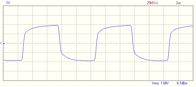

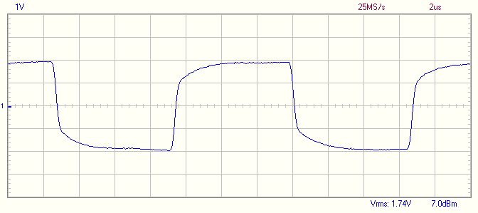

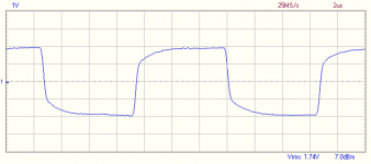

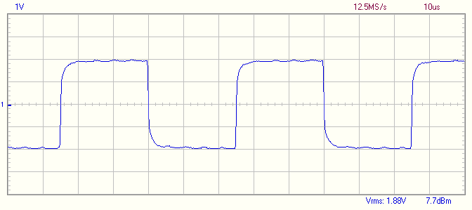

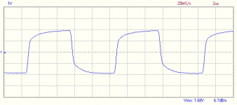

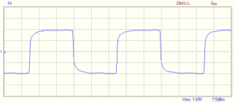

That low level oscilation I was seeing last night has disappeared. I'm using a cheap USB scope so that may be part of the issue. Here are some square waves into a 4 ohm dummy load. 20kHz, 40kHz,50kHz, 75kHz, 100khz
I am glad to see your kypton is working fine, can't wait to build mine boards🙂
Can you calculate the slewrate (20khz, square) ?
No , your original OP board was OK. 1K feedback resistors would make
any of my CFA's oscillate ! And 10K servo returns would make any servo'ed
amp not servo 😀 .
Kypton C slewrate is a little higher than the CFA-X (faster VAS).
<300V/us. This is limited by the input HF filter cap (C2/150p).
