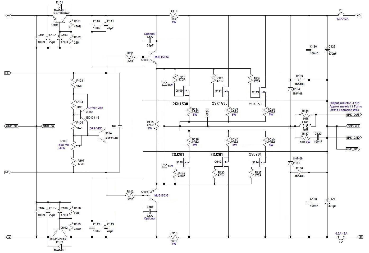

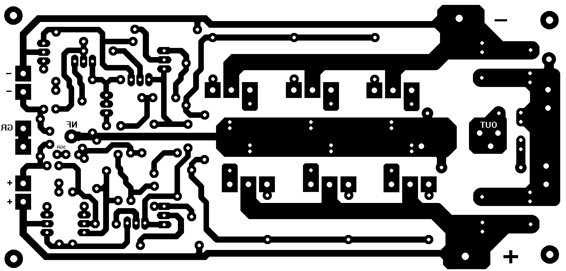

Guy
Please someone take a look - I'm ready to heat up the iron to make some boards but before that I need some help🙂
Do these circuit will work with Toshiba 2SJ200 & 2SK1529.
I do have a few spare parts of those Toshiba (original) I want to put those in good use.
The circuit was design to the more rugged Toshiba 2SK1530 & 2SJ201.
These later one I only has a matched set only. To buy them now is a task because even some large distributors sale counterfeit the bigger Toshiba.
Please take a look and advise what do I change to compensate the differences between the two type of Toshiba fets.
Again the 2SK1529 & 2SJ200 I have several matched pair of them.
Also I made the layout ready for these circuit. In case I need to mode something it is a good time to do it before I do the PC boards.
Thank for the help🙂

Other request
Someone started a Cordel type of circuit mode to HEX Fet a few moths back now I don't find it. I did search several days on the forum and no result came up.
I think OS or Jason did it.
Can someone point to that thread the above layout is for that circuit.
It was these circuit with HEX-Fet.

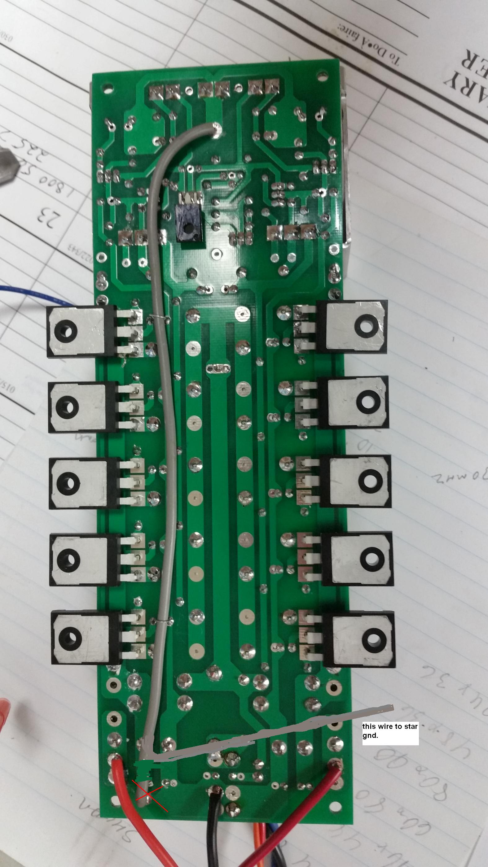

In all my test this G2 connection is on power supply STAR GND.
I did originally test this with one pair months ago with a lower voltage supply. All my problems started when I went high voltage and added output devices.
I originally had G2 to the star ground too but was told that was wrong.
G2 can go to the chassis main star. I deviated from the PCB , too.
My G2/G1 goes to the chassis star , but my speaker grounds also go to the chassis
star - NOT back to the PCB speaker ground fast-on.
Where G2 is soldered to G1 , don't solder it to the G1 pad - instead , solder it
right to the G1 fast-on pad. Right at this point (halfway between the OPS decoupling
caps) ,OPS current pulses cancel each other out fully.
Sort of like a twisted wire "triplet" ....
To determine if the OPS is working absolutely properly , R115 and R111 are your friends. (I use 10R here - easy calculating)
Here , you can calculate the total driver/predriver/IPS current draw.
For example , I get 290mv/210mv on a wolverine (65V rails). I add this 29ma
to the 210ma of my 3 MT-200's bias current (@240ma).
I have another 10R at negative rail input. This reads a 2.4V drop - it adds up perfectly.
No milliamp's are "unaccounted for" .... any defect or oscillation would make
for "missing" currents !!
PS - also , compare with a simulation set to 65V rails .... LT says 30ma/22ma
for the wolverine across the OPS 10R's (R115/111).
On an OPS with the cap multiplier ... about 1 extra ma per rail. Spooky / and Kypton C
draw much more current for the zener shunt regulators (50ma per rail).

I never designed any FET OPS's , you might want to ask someone who did ??
PS - I have no connection to any of these modifications.
OS
