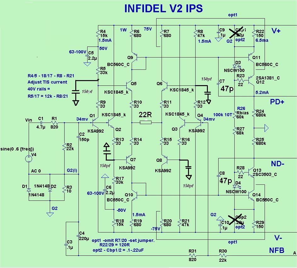

I see the Infidel as a much more optimal CFA. Optimal in the respect that the backside diamond is a really good and very very close to ideal V to I converter that ensures close to perfect current summation in the feedback injection point. Normally you use a low value resistor network in the CFA feedback, but that also gives you issues, too low values and power/heat becomes a problem and too high the voltage modulation becomes a problem and you can push the transistor out of class A operation. by adding this back diamond you get a more ideal V-I conversion and a more dynamic linear feedback path.

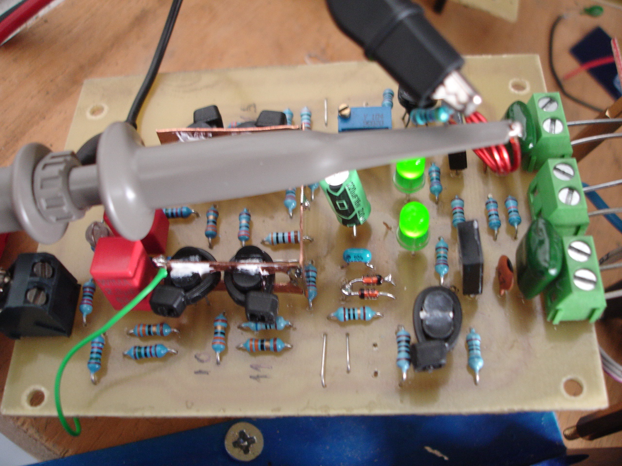

The use of such high resistor values in the feedback produces a high phase shift. Instead of 22K and 820R i would go for 2.2K and 82R.
But the easiest thing to try fix the oscillation. 22 - 100pF between in+ and in- will raise the HF closed loop gain.

Thanks for reply, i will try all these tomorrow.Just a quick note..

Ignore this if it has been tried. The polyester 0.1uF caps are probably not the most effective de-coupling caps at HF, perhaps a few 0.1uF 1206 SMD caps could be placed on the bottom side of the PCB to aid localizing the HF loops. Two could be placed right under C9 and C10, one more for V- could be placed near the jumper next to R21, another one more for V+ at where Cbp1 used to be.
Hi, Thimios,Thanks for reply, i will try all these tomorrow.
Usually, Diamonds are not stable at very HF.

Those caps are really good with something like 47 ohm basestoppers, for me this bandwith limiting is really good and can preven RF transmitter ingress into your circuit, maybe all that is needed is on the input side.
Where are the base stoppers connected?Those caps are really good with something like 47 ohm basestoppers, for me this bandwith limiting is really good and can preven RF transmitter ingress into your circuit, maybe all that is needed is on the input side.
To the transistors at the diamond (Q5-Q8), basestopperrs and then at the base a small cap to GND, form a diamond rf filter. As previously said the 103 MHz is a radio station frequency, so maybe it's RF FM radio station reception. I once had an MC preamp that was a great tool for listening in at the nearby hospital internal radios too bad it was only the janitor telling where they needed cleaning an not where the royaly had babies or something interesting like that, well the ponit is that BJT circuits really need good input filtering.
I am not so sure that I would filter the backside diamond (q6-q8) as it also a pole in the FB
Do you believe that is an rf reception even with a sorted inp?To the transistors at the diamond (Q5-Q8), basestopperrs and then at the base a small cap to GND, form a diamond rf filter. As previously said the 103 MHz is a radio station frequency, so maybe it RF reception.
